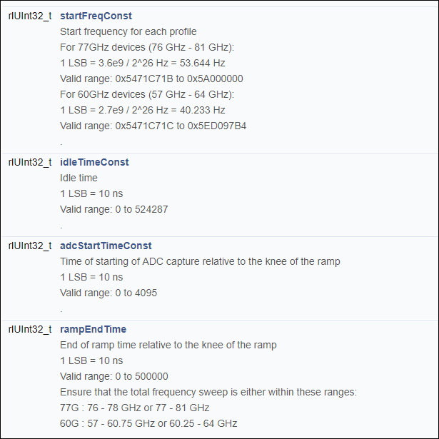

    1. I try to find out the limit of the IWR6843 Chip but I can't find a documentation that gives me the limit for the chirp parameter e.g. slope.
    The chirp parameters such as idle time, ramp slope, ADC start time etc are part of profile configuration API (rlSetProfileCfg) which is part of the mmWaveLink sensor control functions. You can find the detailed API list in the mmWaveLink doxygen documentation as given below:
    Top level page: C:/ti/mmwave_sdk_03_00_00_08/packages/ti/control/mmwavelink/docs/doxygen/html/index.html.
    Under Modules, Click on the Sensor -> rlSetProfileConfig ->  rlProfileCfg_t to get the detailed parameter list including the limits as shown in the snapshot below. You can follow the same structure for other APIs and their parameters.
    C:/ti/mmwave_sdk_03_00_00_08/packages/ti/control/mmwavelink/docs/doxygen/html/structrl_profile_cfg__t.html
