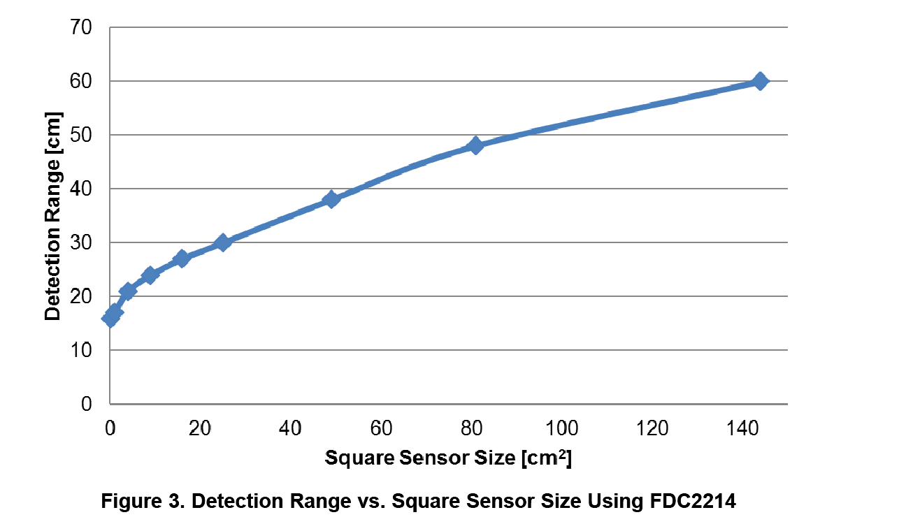

1. In the datasheet, it said that this FDC2214 is also for proximity sensing application. The graph shown below as  the sensor size increases as well as the sensing range.
    This from application note under "Capacitive Proximity Sensing using FDC2214".  Does it mean, if my sensor size is 2 cm (circle), its sensing range would be 5cm?

    1. That's correct as the sensor size increases the sensing range increases as well. But, please note that we are talking about the area of the sensor here. For example if you have a sensor circle of radius 2cm, your "Sqare Sensor Size" (from the plot) = pi*2cm^2.

    1. I want to clarify, the diameter of my sensor (circle) is 2cm. What will be its sensing range according to the plot?

    1. Area in your case = pi*radius^2 = pi*1cm^2 = 3.14cm^2. From the plot your sensing range would be close to 15cm - 20cm.
