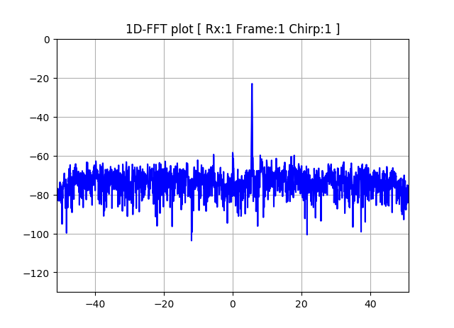

I am working on ADC raw data processing obtained by DCA1000 + AWR1642.
After applying Hann window and performing 1D FFT on a single chirp containing 2048 ADC samples,

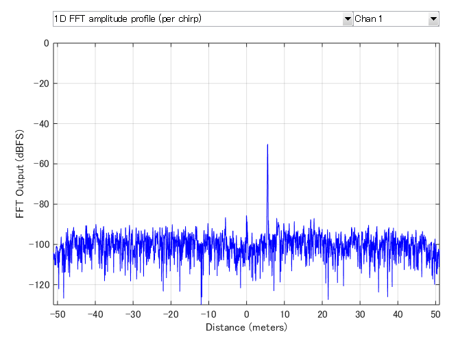

I am able to obtain the FFT result similar in shape with the result from mmWaveStudio.
However, the amplitudes are different.
What I have done to calibrate the amplitude is as below:
1) normalization for Hann_window
scaled by 1/sum of Hann_window
2) normalization for FFT
scaled by 2/number of ADC samples
My FFT result
mmWaveStudio FFT result
Below is the python code which I used to calculate the FFT result.
numADCSamples = 2048
Hann_1D = np.hanning(numADCSamples)
Hann_1D = Hann_1D / np.sum(Hann_1D)
f1 = np.multiply(chirp2view,Hann_1D)
f1_fft = abs(fftshift(fft(f1,2048)))/numADCSamples*2
f1_out = np.log10(np.multiply(f1_fft,f1_fft)) * 10
Do I miss something or make some mistakes?
It will be very appreciated if someone can give me some comment. Thank you!
    The pre-processing matlab functions included in mmWave studio may use a different amplitude definition than the standard matlab.
    Please search this forum for this topic since there have been previous discussions.
    If you have a standalone matlab setup I encourage you to continue developing your own matlab routines to analyze the raw data

  • Hi, Cesar
    I have found the answer to my question in a previous discussion.
    The method I applied to calibrate amplitude was incorrect. And now I can get the same amplitude as mmWave Studio did.
    The referring thread is post as below.
    e2e.ti.com/.../659414
    Thank you very much!
