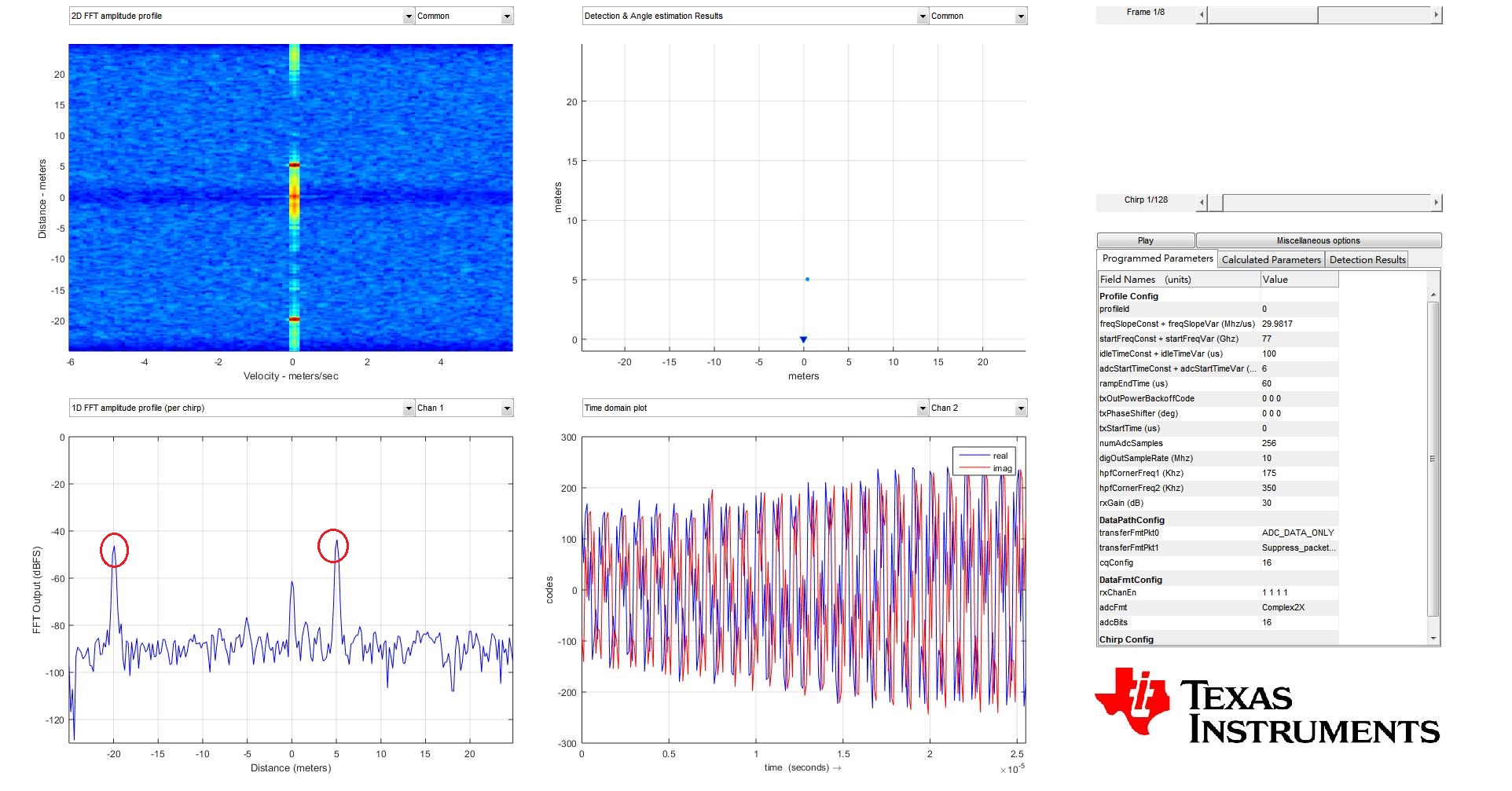

When we do the range detection by the mmWave studio, the scenario is as follows,
1. the max. range detection is set at 50m
2. Place one corner reflector in front of RADAR sensor, the distance is 5m and 10m
the result is :
For TI EVM:
5m corner reflector:
1D FFT  plot appears one peak at 5m
10m corner reflector:
1D FFT  plot appears one peak at 10m

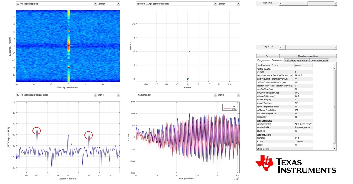

Our RADAR board:
1D FFT  plot appears two peaks at 5m and -20m (see the attached file, corner5m)
1D FFT  plot appears two peaks at 10m and -15m  (see the attached file, corner10m)
Why does the minus range appear ? Could you provide the cause that results this phenomenon for us ?

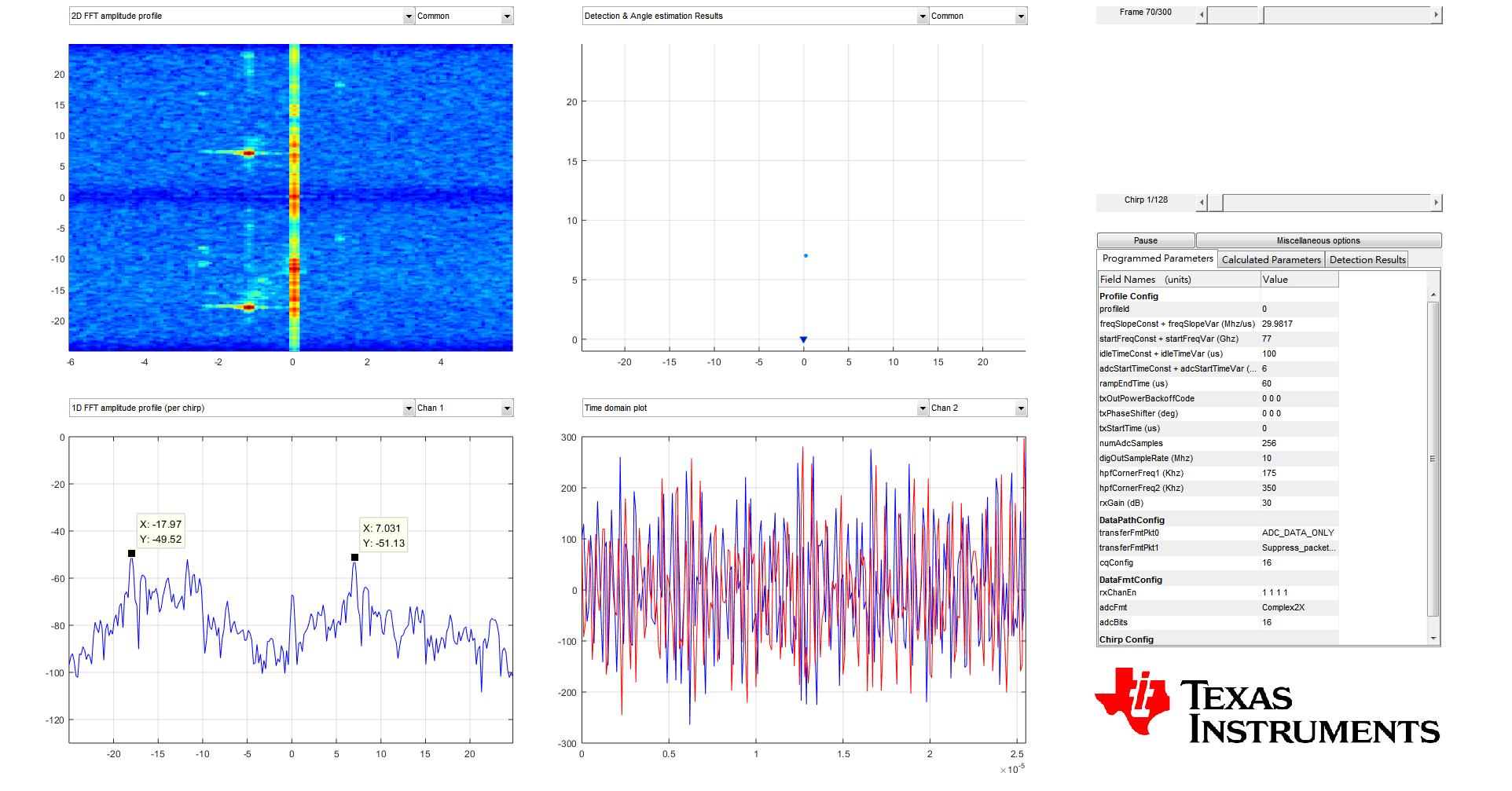

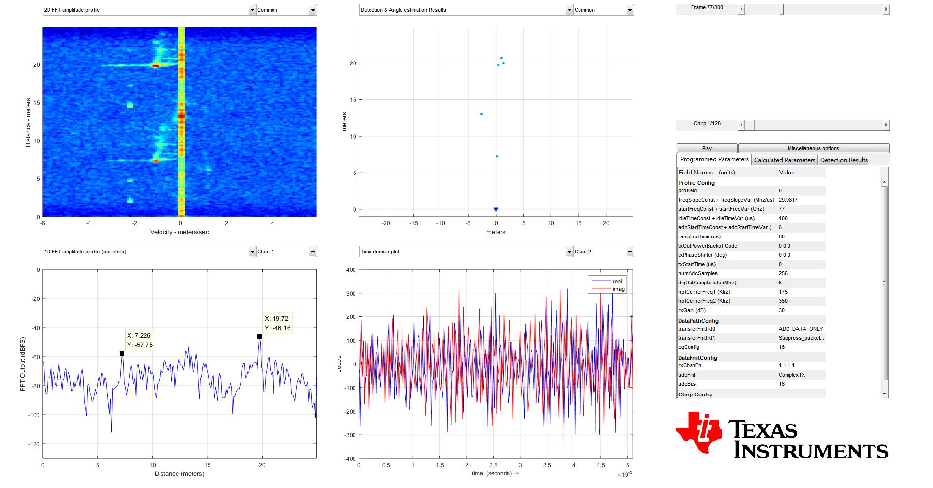

  • Hi Randy,
    We did the range detection test and used the Complex1x mode and Complex2x mode individually, the results are as follows,
    Please help check them
    Michael Su
    Corner reflector at 3m:
    complex1x mode:
    Complex2x mode:
    Corner reflector at 7m:
    Complex1x mode:
    Complex2x mode:
