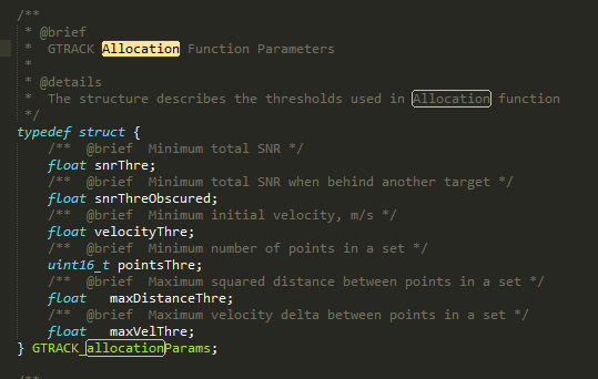

I am attempting to understand how are the MinPts and Eps parameters of DBSCAN defined in the code of the People Countig lab. I would appreciate any help on this, given that the code is not too easy to understand.

    People Counting uses the GTrack algorithm to cluster and track objects. See this paper for more info.
    To answer your question:
    Gtrack has allocation parameters defined in gtrack.h:

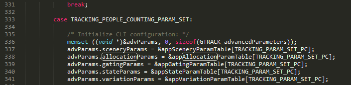

    These parameters are set by the people counting demo is task_app.c when gtrack module is created:
    The values can be found at the beginning of task_app.c here line 141:
    CLI commands can also be used to set these values.
