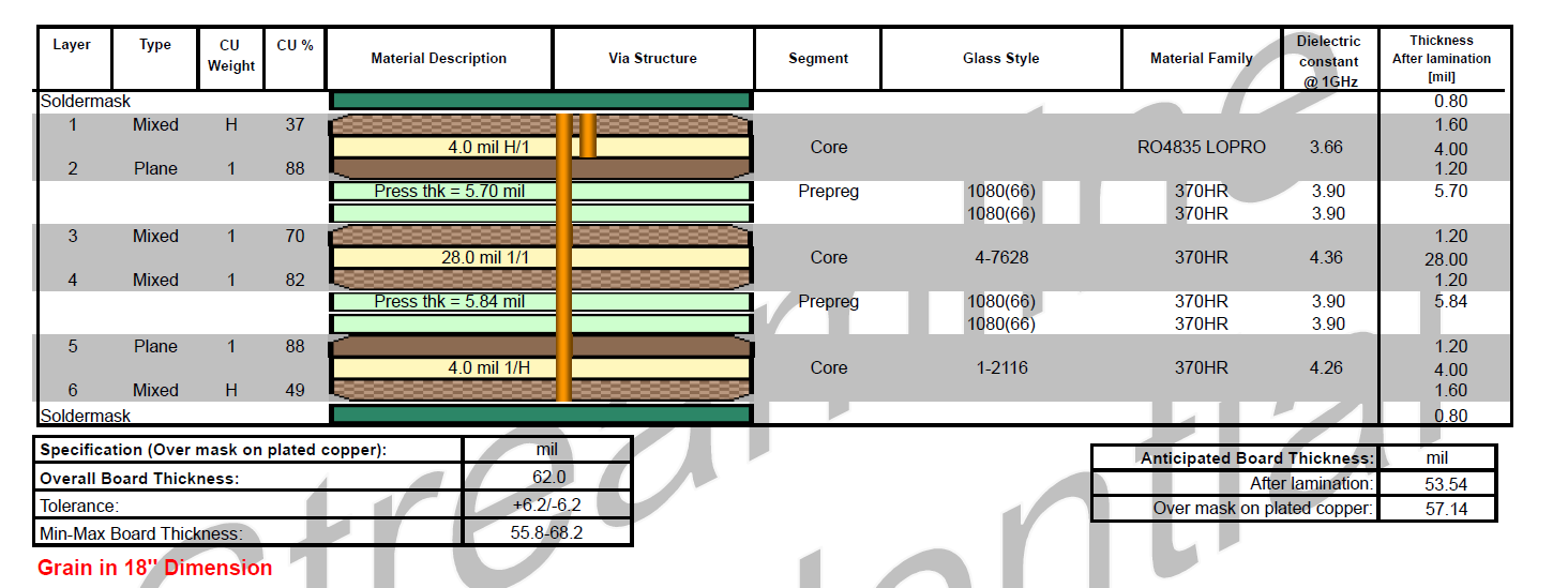

  1. For the AWR1642 demo-board:
  1. What’s the PCB substrate material?
  2. What’s the dielectric constant of the substrate?
  3. What’s the laminate thickness? i.e. too thick laminate thickness can resonate and even propagate its own waves.

  • Hello Viktorija,
    Regarding the first three questions, you can refer to the below stack up.
    I will get back to you with answers to the remaining questions.
    Adrian
