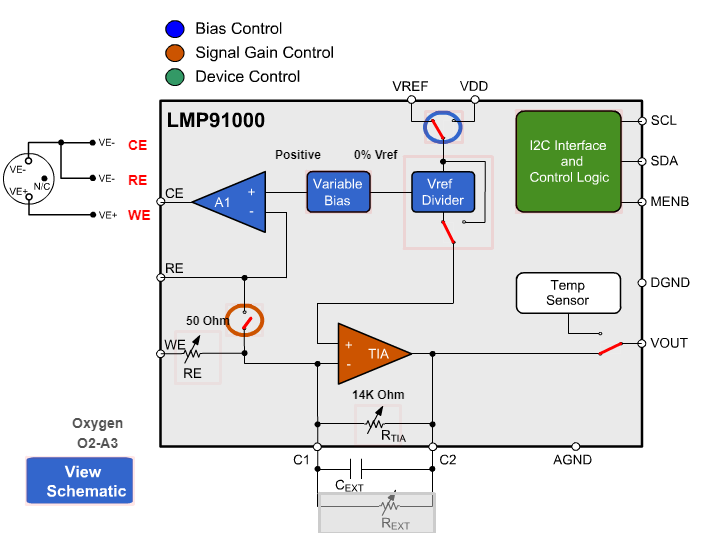

I did refer to the datasheets of the relevant sensors(attached) but not a considerable response when configured accordingly. Any insights would be appreciated.
Thanks in advance.

Thank you for the reply Ren. I have attached the settings and schematic for O2-A3. I did use these settings. Another issue I have with these settings is that the O2-A3 is a galvanic type sensor(I believe). But the settings are for a 3-lead type one.
I could not find the settings for LFO2-A4. But I used following settings.
OP_MODE: AMPEROMETRIC
FET_SHORT: Disabled
REF_SOURCE: External
INT_Z: 50% Vref
BIAS_SIGN: Negative
BIAS: 24% Vref
TIA_GAIN: 35K Ohm
RLOAD: 50Ohm
