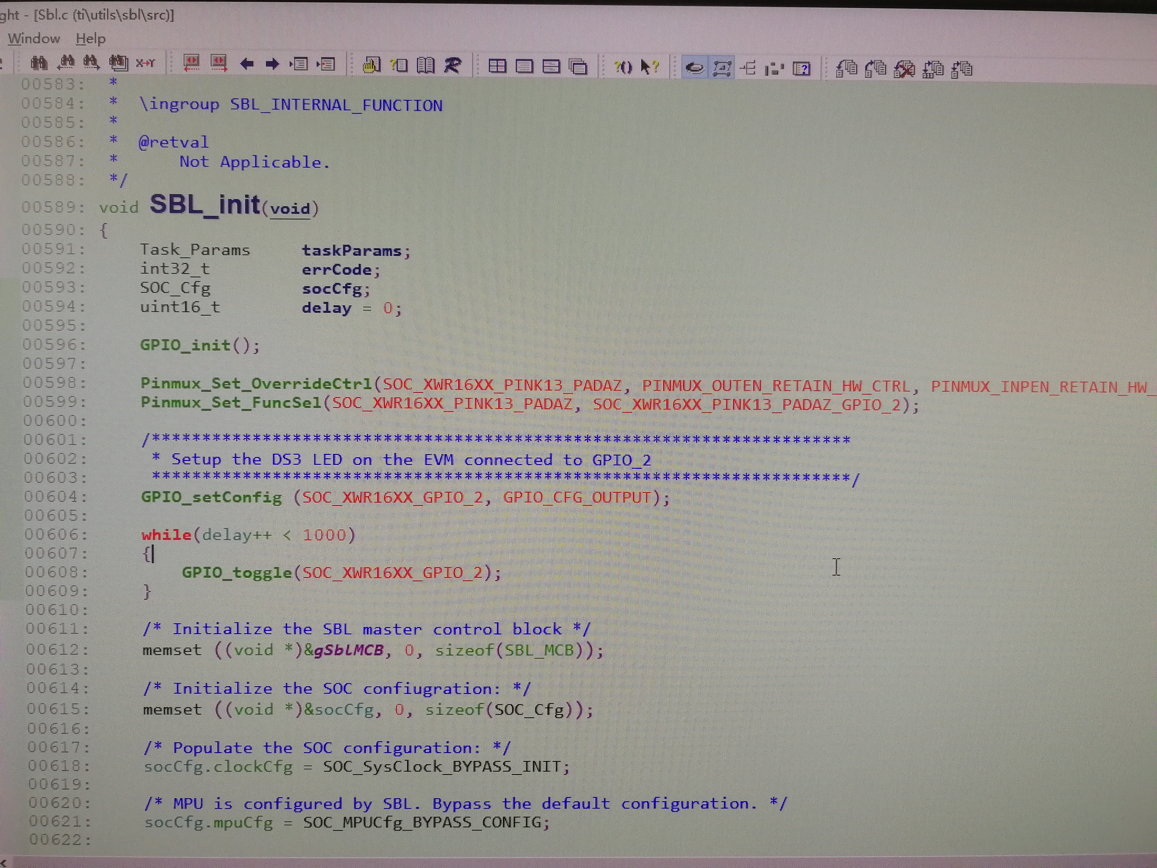

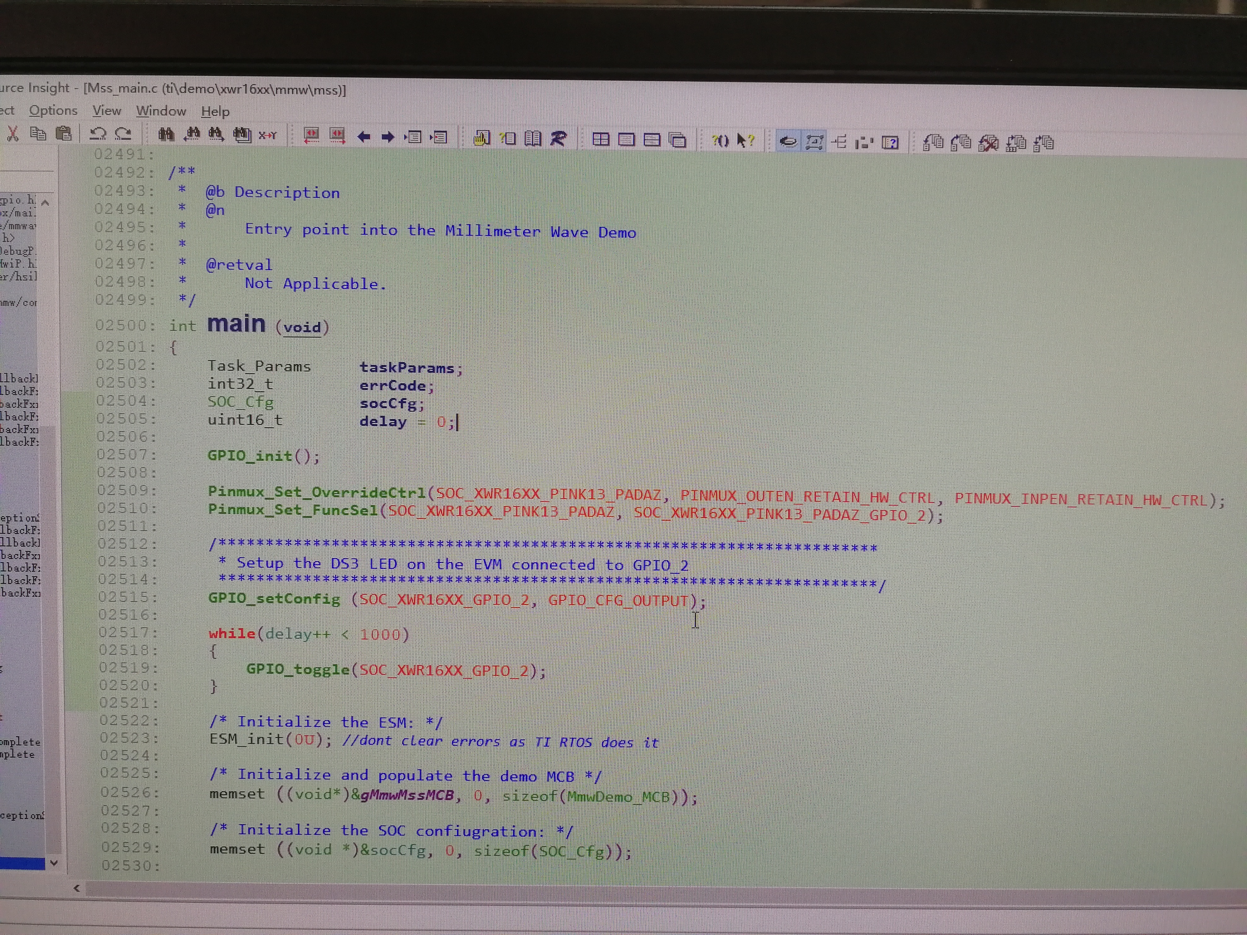

      I have realized the program update with the sbl of sdk3.0, after code being load into RAM, copy the interrupt vector into the address 0 and software reset the MSS, it will jump to my application code and run. But i test the load code time (load application code into RAM) by I/O pin, it takes 130ms. And jump to execute the application main, it takes 1000ms(between software reset and the application main running).

  • thanks for your testing, I have tested my time again, I found the time between SBL_main and mss_main is about 1000ms always. You can see my sbl_main and mss_main code in the picture.
     in the third picture,the green line is the NRST, the yellow line is the GPIO2 siganl, the scale is 200ms/div. from the first toggle to the second toggle, it takes 1200ms. I test the time base on sbl of SDK3.0.0.8 and mss_main of SDK2.0.0.4, and run the code in IWR1642 demo EVM. How do you think about the result?
