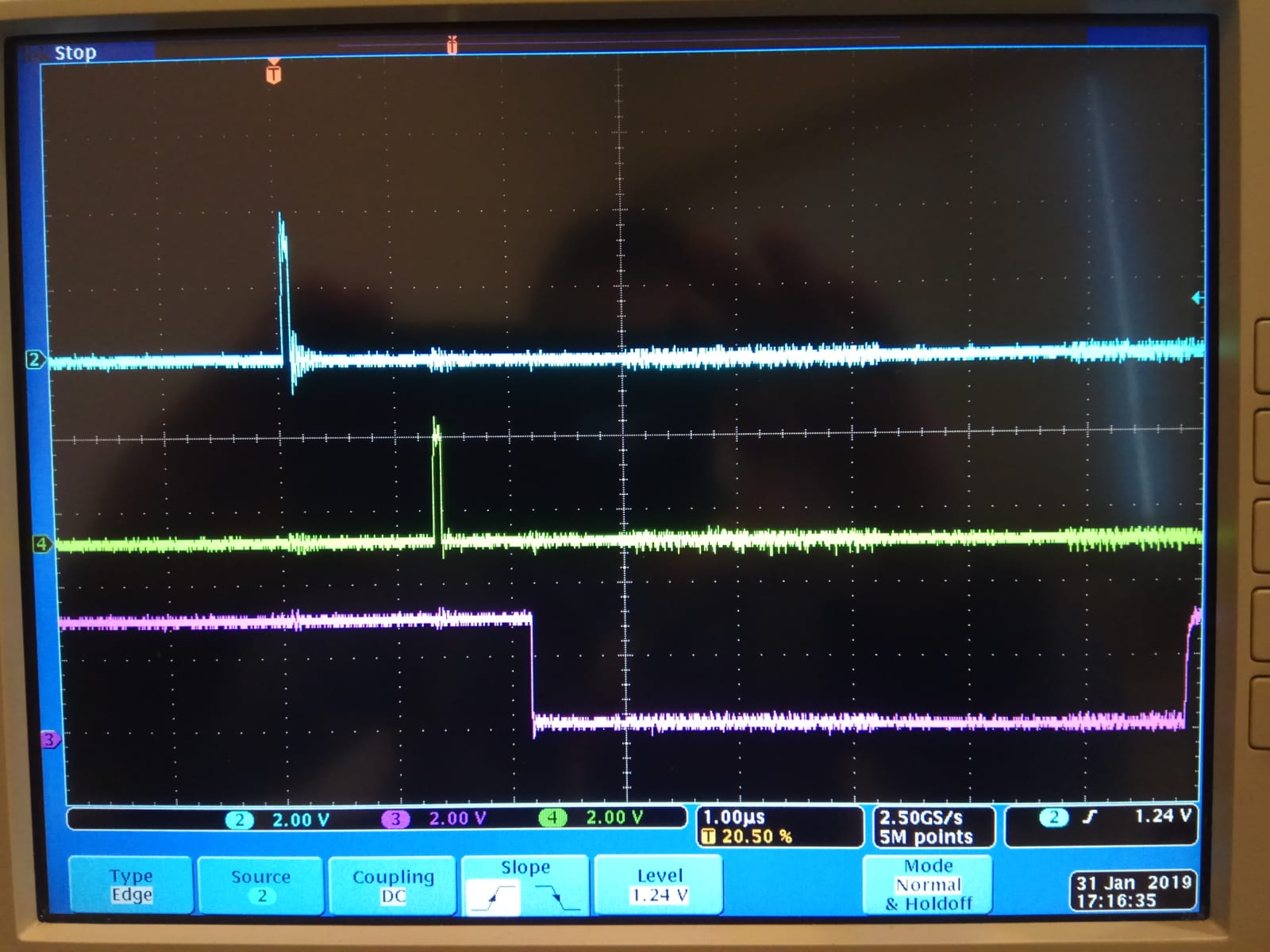

BLUE - start pulse
GREEN - stop pulse
purple - INTB
the Interrupt Mask Register (0x03) is set to 0x01 ( only - New Measurement Interrupt enabled).
can someone explane me why i have a delay between the stop pulse and the INTB ? (~1us)
tnx

Bharat,
1st thanks for the reply.
i saw figure 19 but the is no time scale there.
2nd i think this kind of data have to be in the datasheet.
because if you want to work in a fast mesurment cycle for example (start pulse every 2us)
and get your stop pulse after <500ns (mode1) , there is a dead time (of aprox. 800ns to 1us) that you are waiting for INTB to be toggle.
and thats before you are starting your SPI interface.
again thanks for the help!
