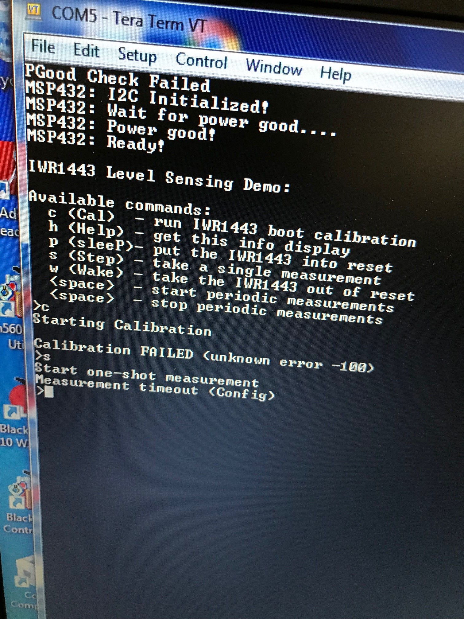

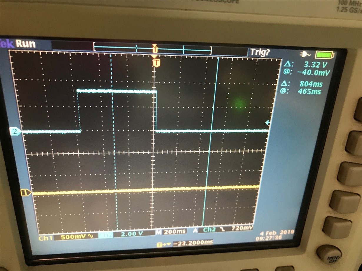

We have an IWR1443 board with ES3 chip, we only use one receiver (Rx4) and one transmitter (Tx1), it failed the calibration, if do single step measurement after the calibration failed, it show "measurement timeout (config). We use the default configuration in level-sense-demo for ES3 chip which is provided by Akash. We checked the GPIO_0 signal, it went to "high (3.3 v) when push MSP reset button and keep high during the calibration, it went to low after push "s" for step measurement four times with measurement error "measurement time out (config); we step into the code in debug mode, it failed in demo.c line 1424 "mmwave ECALCFG" ((-3109)-19), anyone know what is wrong and how to we change the config from RX1 to RX4?

    It would be helpful to see a scope shot so we can see where GPIO_0 is failing to transition.

  • Attachment is screen copy of the plo  t.
  • Hi Feng,
    There are a couple of techniques you can try to perform the calibration cycle manually.
    The Calibration "mode" of the device is tied to GPIO_1 upon power on. So if you hold down the GPIO_1 button (SW1) and perform the calibration cycle then it might result in a successful calibration and you can perform measurements afterward.
    A more foolproof technique is to completely disconnect the MSP432 and then hold down the GPIO_1 while applying power to the IWR1443BOOST board. You should be able to reconnect the MSP432 board and be able to perform measurements after doing this.
    Let me know if you have issues.

  • Hi Akash,
    Thanks for the help!
    I hold the SW1 down during the calibration, the calibration is successful, and can do the measurement. Do you know why? I also need to change the Rx port to Rx4, how do I do that? Can you help me on this?
