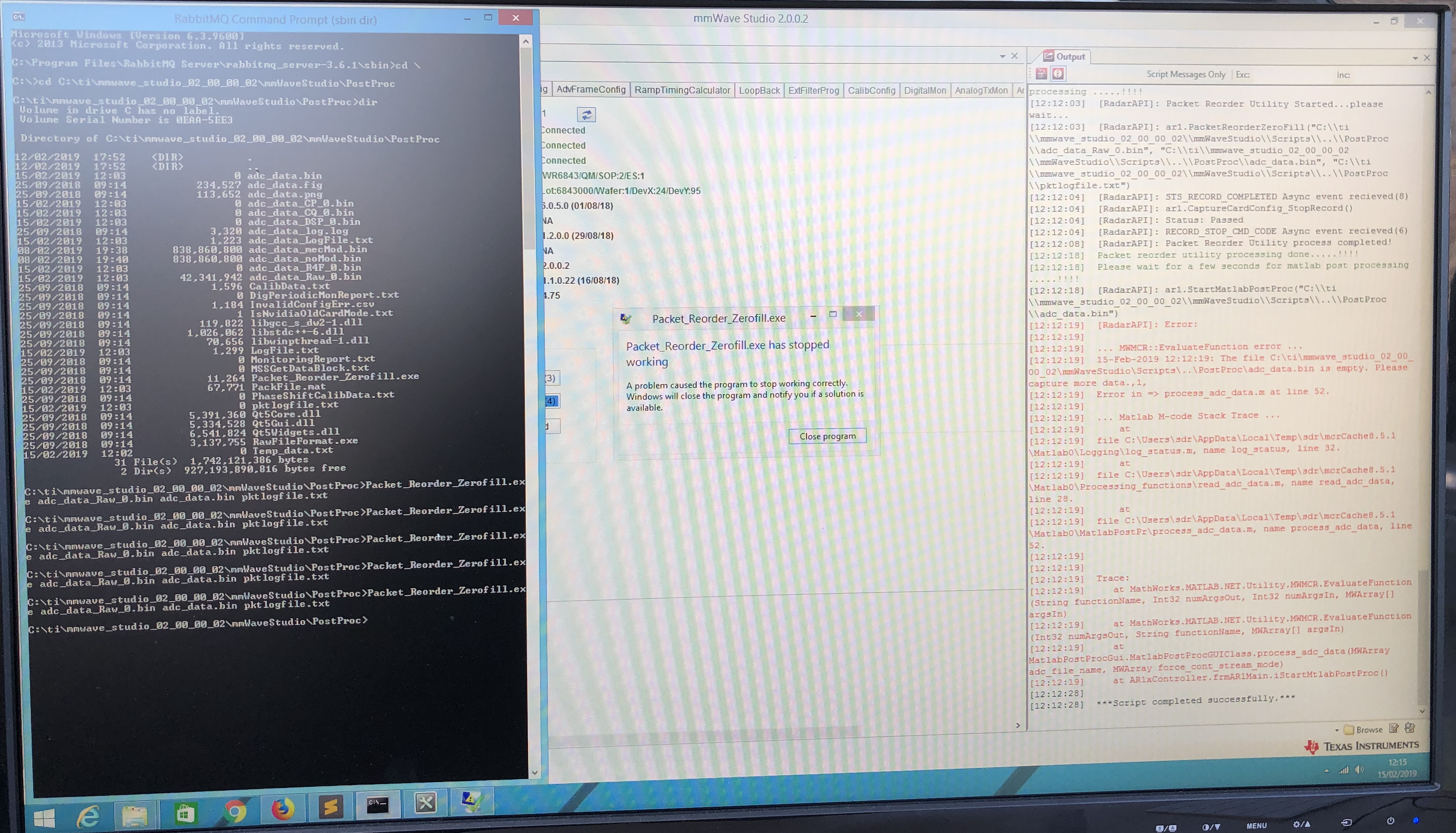

    And a photo of the Packet_Reorder_Zerofill.exe when I try to call it manually from command line:
    It appears that ADC data has been captured correctly, problem seem to be in post processing side.
    Could you please post the adc_data_Raw_0.bin, Also screen capture of the configuration that is applied and output/log files.

  • Thanks Chethan. Not 100% sure, but a combination of more ddr ram and changing ram settings in bios may have resolved the crashing zero fill utility. It's stable so far, so fingers crossed.
