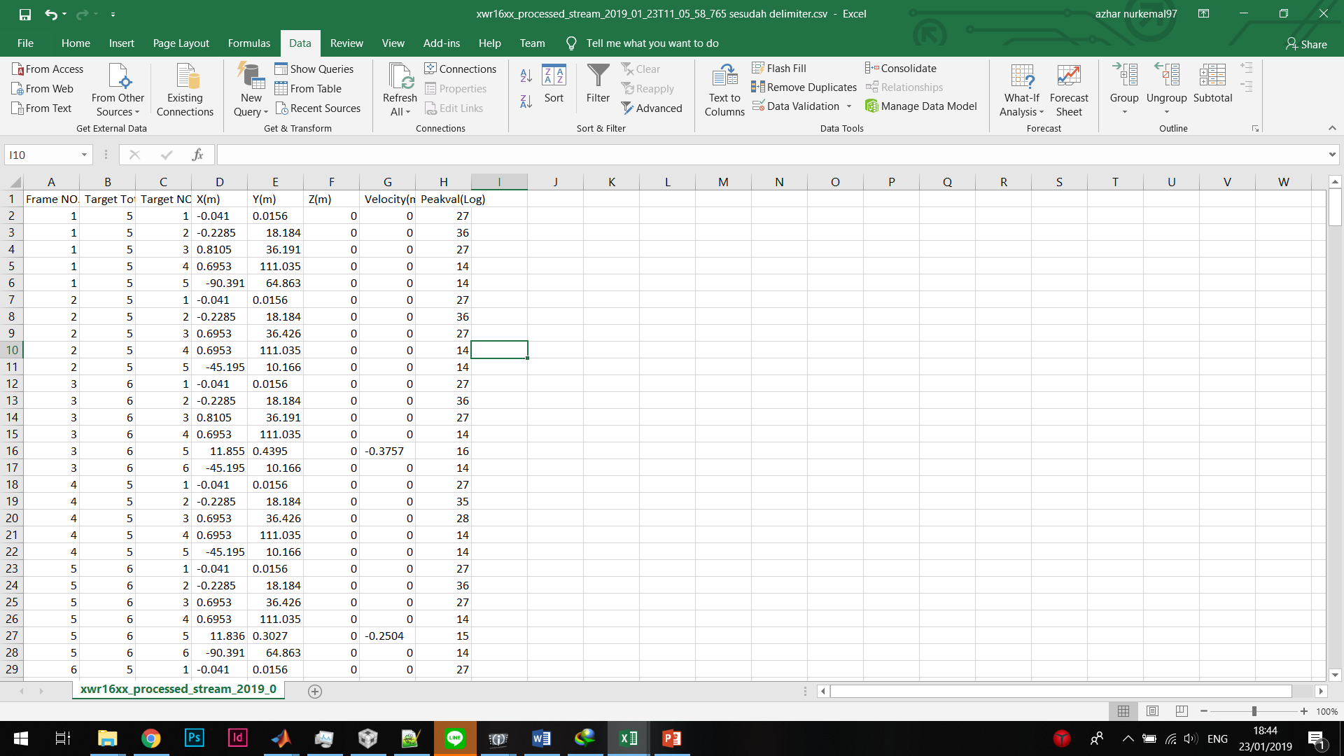

hello,
i'm trying to get raw data from demo visualizer from button log start here :  then here the file .csv that i got :
the problem is the data above is not accurate enough for tracking object. we tried using only 2 human motions but the data get target randomly, its hard to know which target number(Target NO.) for representation 2 humans.
my question :
1) how does AWR1642 algorithm recognize any object as human like demo GUI from here "C:\ti\mmwave_industrial_toolbox_3_1_0\labs\lab0011-pplcount\lab0011_pplcount_quickstart\pplcount_gui.exe"?
2) can i use that file (.csv)  or get another data from AWR1642BOOST as input for Machine learning/ Deep learning to implement that algorithm for people detection/counting ? if there is another data that i can use for human detection/counting how can i get them only using AWR1642BOOST?

  • Hi Azhar,
    There is a TI Design document that goes over the function of the tracker.  This demo uses a different signal chain than that of the OOB demo, which produces a rich point cloud for human targets.
    Regardless, please use the options in the Online Visualizer to turn off the peak grouping feature.  This feature removes points from the point cloud, which hides clusters. Tracking a target with radar will require a cluster of points.
    You can also run the lab0011 People counting demo on the AWR1642 device.
    Justin

  • Hi Azhar,
    The tracker takes the point cloud in the format:
    1. Range
    2. Angle
    3. Velocity
    4. SNR
    The tracker also uses state information from the last frame - this is handled internally, so you do not need to provide it as input.
    In the fHist,
    • pointCloud is the radar detection points in the format described above
    • Target List has the target information - S is the state vector in this format:
      • X
      • Y
      • Velocity X
      • Velocity Y
      • Acceleration X
      • Acceleration Y
    • mIndex links pointCloud from the previous frame to tracked objects.  This is used in the GUI to color points and tracks the same color.
    The rest of the data in the fHist is mostly benchmark info.  Please read the TI Design for more.
