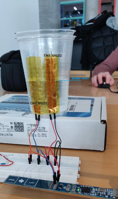

I have tried to use the fdc1004 board to measure the level of liquid inside a bottle. There are several application notes that states how to do so and I am almost sure I have done it correctly.
The way I did it was to make 2 electrodes for a level sensor and 2 electrodes for a REF sensor. I made these from copper foil tape. the level sensor is approximately 8 cm and the REF is about 1.5 cm.
I have connected one of the levelsensing electrodes to cin1 and the other to shield2 and for the REF, I have connected one to Cin2 and the other to shield1.
But for some reason, I cant seem to get a difference in the GUI's capacitive measurement. I can get an instant respons but as soon as I stop puring water, it kind of resets and go back to the capacitive output it was at at the beginning.
Am I doing something wrong or is there a reset function that I cant find in the GUI?
Thanks in advance!
  • This device does not have a reset function, it will tell you the absolute capacitance. Can you take a picture of your set-up?
  • Thank you,
    My test looks like this and I have attached the results from the GUI when puring water into the glass.
    As you can see, it doesn't act like it should or at least doesn't get a steady capacitance change.
  • Are you trying to do the out of phase technique shown in this app note?
    www.ti.com/.../snoa925.pdf
    Is this configured as a differential measurement?
    CIN1 (SHLD 1) - CIN4 (SHLD 2)
    CIN2 (SHLD 2) - CIN4 (SHLD1)
    If you are doing this with a single-ended measurement, then it makes sense that you would not see much of a response. In a single-ended measurement, the SHLDx signals are tied together and they are forced to the same potential as the CINx driving circuit. For a single-ended measurement, the SHLDx electrodes should be connected to ground to form something similar to Figure 1 in the linked app note (but without the shield layer).
