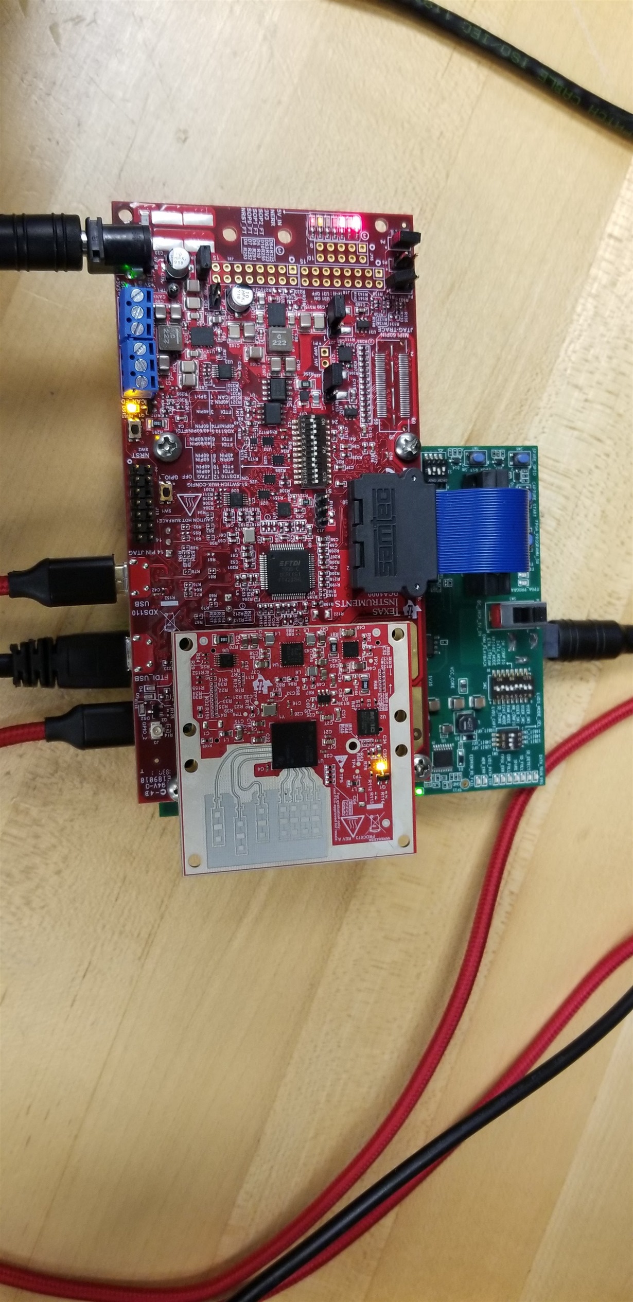

I am a new user of TI's IWR6843 mmWave sensor kit. I have a whole setup of IWR6843 + mmWAVEICBooster + DCA1000 data acquisition module setup connected to a 5 V source. The current consumed by this setup is close to 880 mA. The mmWAVEICBooster kit is connected to my Windows 7 laptop through the XDS110 microUSB port. I see there are two COM ports on my Device Manager list - XDS110 Class Application/User UART (CFG_port) and XDS110 Class Auxilliary Data Port (Data_port).
My problem now is that, the mmWave Demo Visualizer web app is not able to recognize the board. I keep getting the "Hardware Not connected" message again and again. I opened the COM ports using Putty to verify my results. I came across this post on the Forum and as it says, is there an issue with the FTDI/XDS Drivers on Windows? Please, do let me know. I have attached the photo of the mmWAVEICBoost and my setup.

  • Hi Vijay,
    For running the Out of box demo with the mmWaveDemoVisualizer, please configure the MMWAVEICBOOST in stand-alone mode using the correct Jumper settings.
    1. Disconnect the DCA1000 EVM (the blue cable) as it is not needed to run the  SDK out of box demo.
    2. Configure the switches and SOP jumpers on the Carrier Board for standalone mode as shown in the quick start instructions on this page and follow the quick start instructions to run the SDK demo.
    MMWAVE SDK Demo - 68xx Lab User's Guide
    3. Make sure that you are using a 5V 3A power supply (The power supply be able to supply at least 3A).
    -Nitin

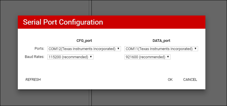

  • Hi Vijay,
    Are you configuring the COM ports in the mmWaveDemoVisualizer? You need to go to Options->Serial Port in the mmWaveDemoVisualizer and configure the Control and Data COM ports as shown below and press OK. This should change the status to Hardware Connected.

  • Vijay,
    As the COM ports are shown in Windows Device manager, the hardware seems to be OK. A couple of things to check:
    1. Do you see the EVM Com port listed in the above dialog box in demo visualizer i.e. under Options->Serial Ports. If you don't see the ports listed in the drop downs, it means that the required drivers are not installed.
    2. When you run the Visualizer for the first time, it asks you to install the CCS Cloud agent. The Cloud agent installs the necessary drivers required for the Visualizer to communicate using the COM ports. You need to install this. Please also try on another machine and install the Cloud Agent.
    3. Make sure that you are using the Chrome browser and not Internet Explorer.
    -Nitin
  • Nitin,
    I have tried all this and I have the extension installed. Only after I select the ports (Data_port and CFG_port) from the dropdown menu, I get the message "waiting for data" on the status bar. I have the TICloudAgent bridge installed.
    Vijay
  • Vijay,
    If you are able to get "Waiting for Data" in the Visualizer status bar, that means that the EVM is connected and waiting for the Sensor configuration. What happens when you press the "SEND CONFIG TO MMWAVE DEVICE" button on the Configure Tab? What do you see in the console? Could you provide a snapshot of the console?

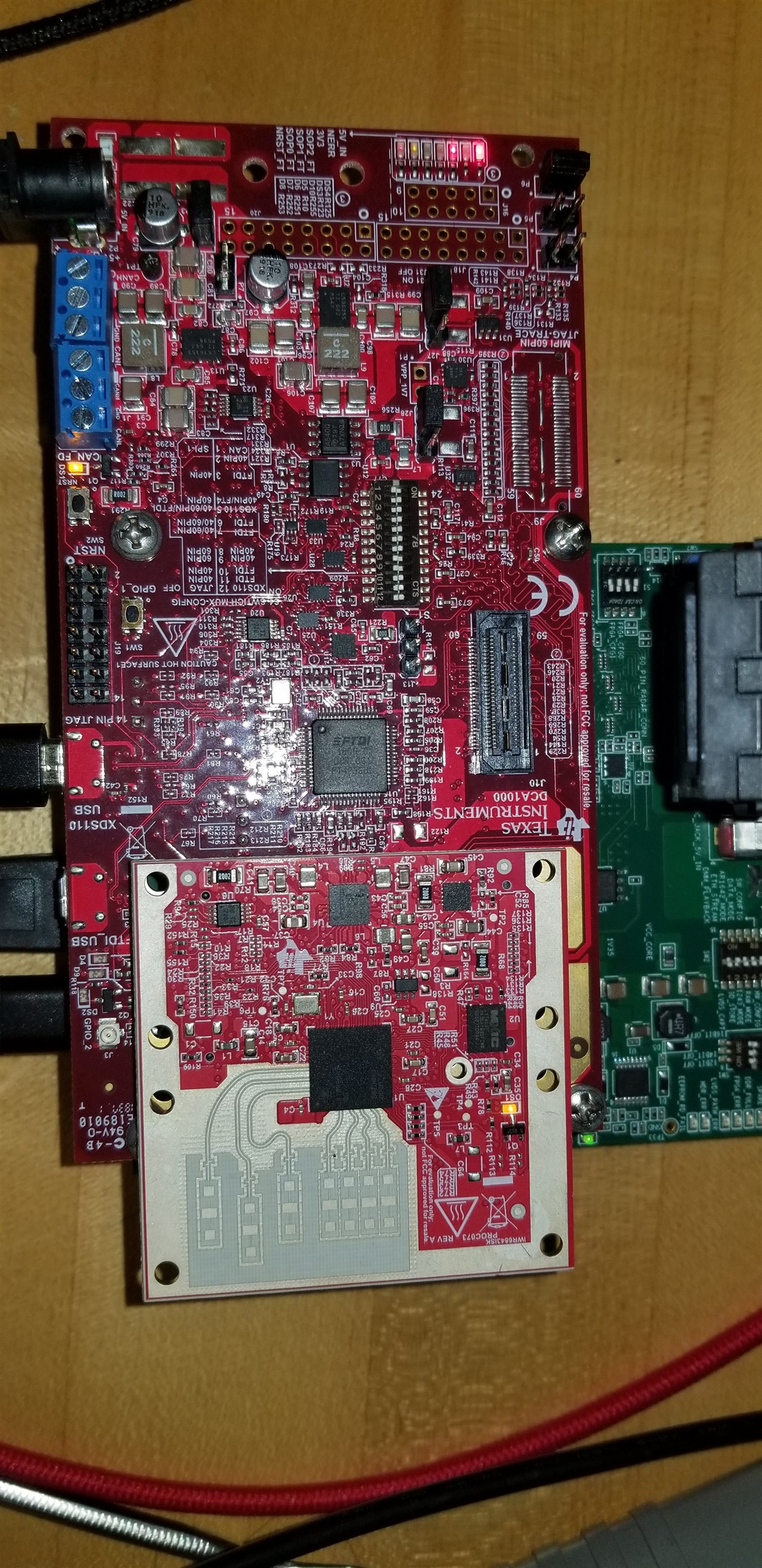

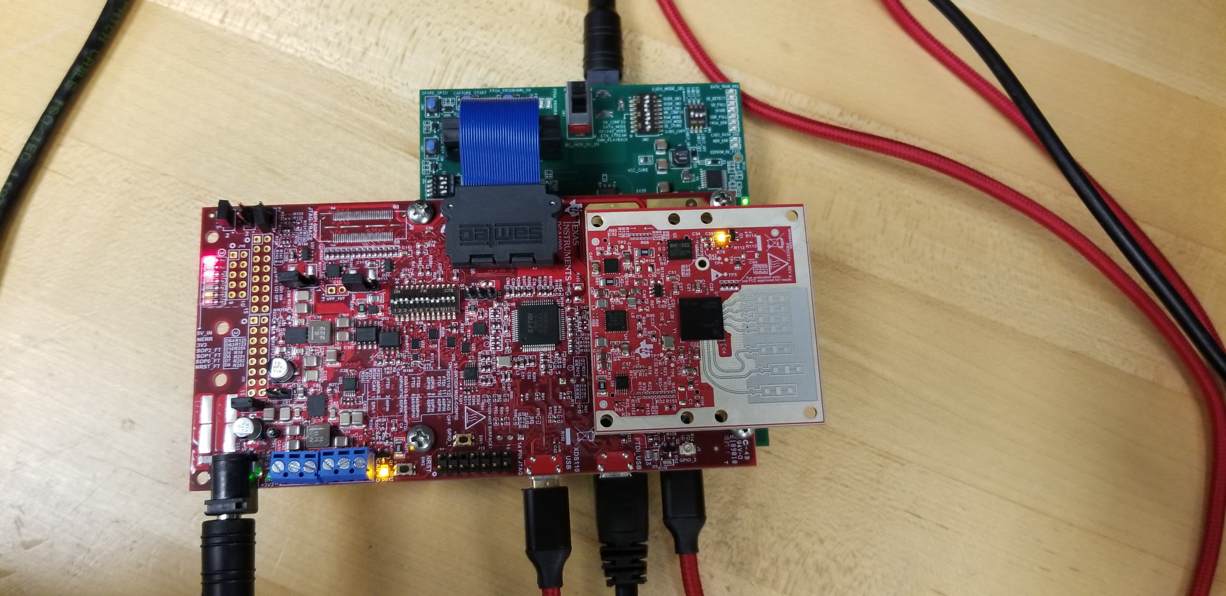

  • Nitin, It doesn't work. I have tried the RESET button a lot of times. It is proving to be a very difficult problem. The mmWave studio doesn't connect to my device using SPI, the demo visualizer is very finicky.
    I am trying to debug, and do you guys have a data where the current consumption is mapped for the different modes? I know have the current at 850 mA, is that okay? Is the board really consuming 4 W of power?
    I have attached the photo of my setup again.
    Vijay
