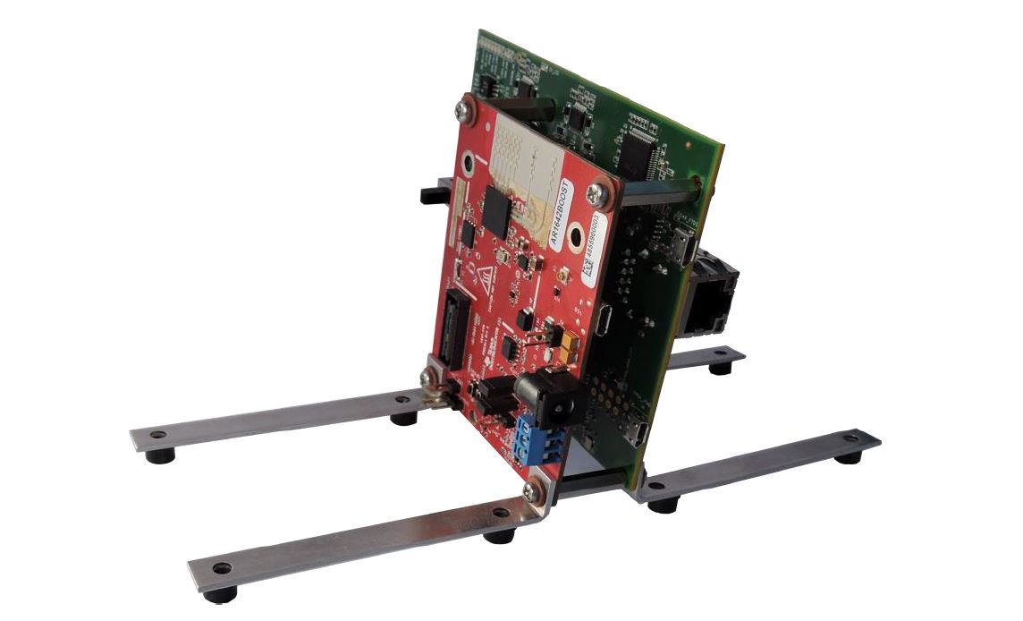

Do you know what is the purpose for below yellow PTH hole ?

  • Hello Yimin,
    These are mounting holes which can be used to connect mounting studs using screws. These studs can used for mechanical support. Incase you need to attach this EVM to another board (like the DCA1000) the mounting studs would connect the AWR1642BOOST EVM to the DCA1000 EVM to hold both together. You could also use the studs on the EVM just to have a flat placement on the table and preventing the components on the board to touch the table.
    Vivek
  • Hello Yimin,
    The below image shows an example of the mounting studs between AWR1642BOOST and the DCA1000 board.
