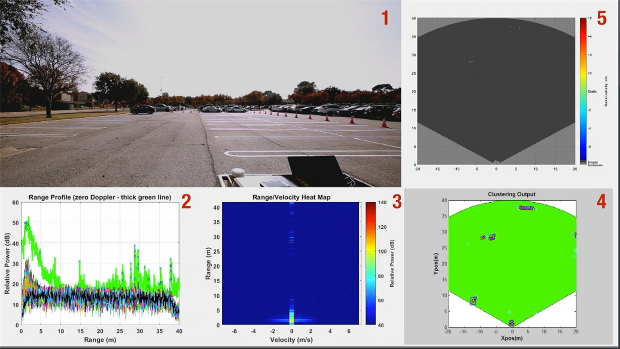

Hi Guys,
I need to modify either:
  1. The mmWave out of the box demo such that it includes a range profile plot for targets at long ranges  (40m-80m) or
  2. The Short Range Radar from the automotive toolbox tool box such that it includes a range profile plot and range-Doppler heat map
To give results shown in the experiments below. I am using only the AWR1642BOOST EVM
  • Hi
    The data below was processed with matlab offline.
    I am concerned that there is no sufficent time to transfer this data at runtime.
    You may be able to modify the code to transfer this data at slower frame rate.
    In order to do that please study the SDK demo
    Thank you
    Cesar
