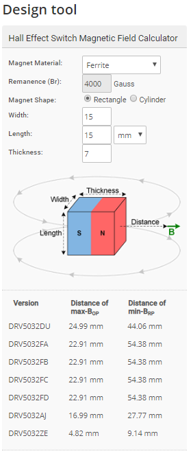

DRV5032: Please help to provide the sensitivity and test method of magnetic force to DRV5032 working
Part Number: DRV5032
  • Hello Jace,
    Thanks for using the TI forum.
    The device sensitivity is available in the DRV5032 datasheet, and also on the product page summary:
    If you want to test a specific magnet to see the distances it will activate the sensor, you can use the design tool that is also on the product page:
