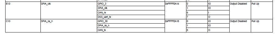

1. Where can i find more information about how the SPI/CAN switch works. As in, where it fits in the data path, etc. Because i noticed that it is important to have it in SPI for the mmWave Studio Demo. But works either way for the mmWave SDK Demo.

    1)  SPI/CAN interface are defined in pin mux table.  In case of mmWave Studio  use-case device is booted through the debug mode.
    In this case boot ROM will enable the pin-mux configuration as SPI interface.  In case mmWave SDK  out of box Demo, interface to device is through the UART ports (Control and Data UART ports).
    Application running on MCU could be modified to enable CAN or SPI ports by writing into pin mux registers.
    You could refer to datasheet for the pin mux configuration shown below.
