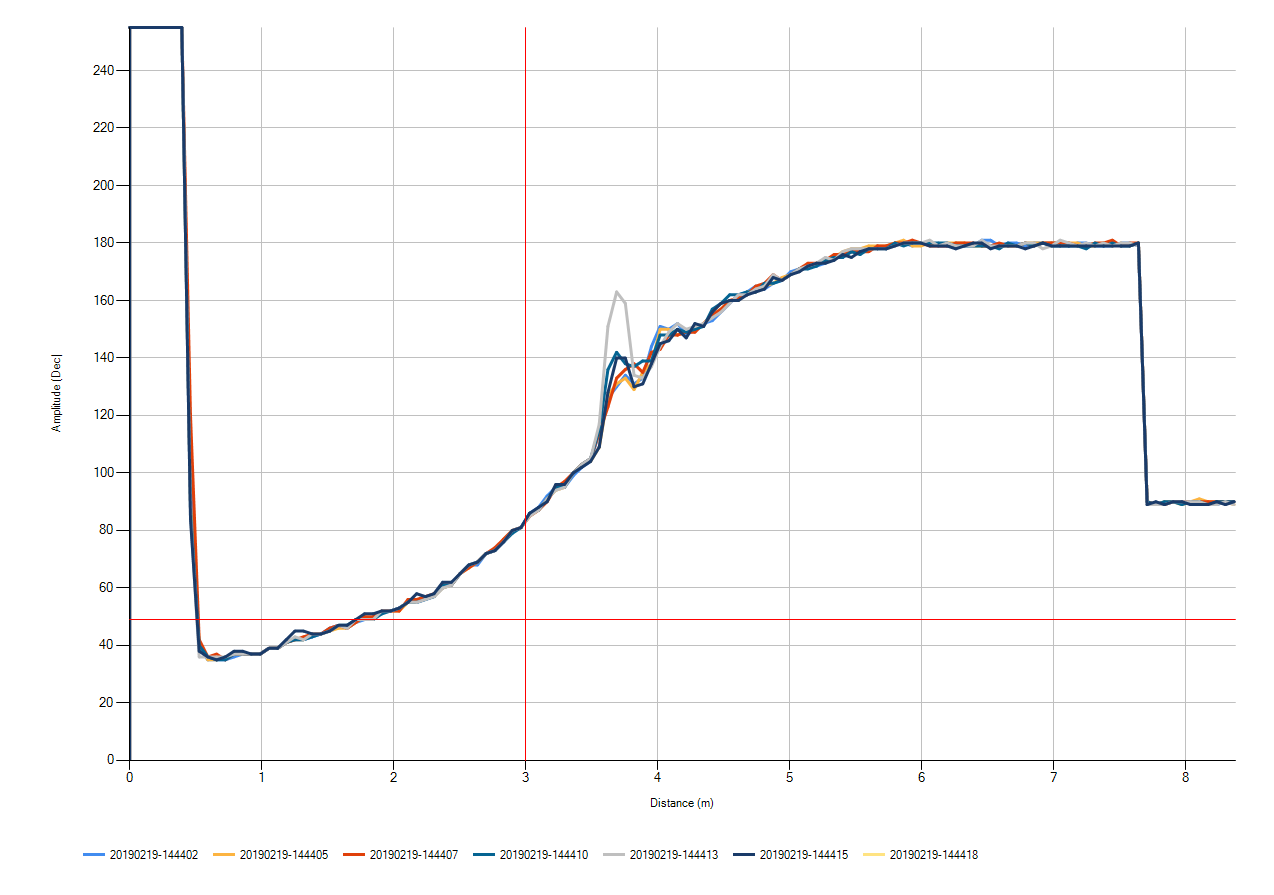

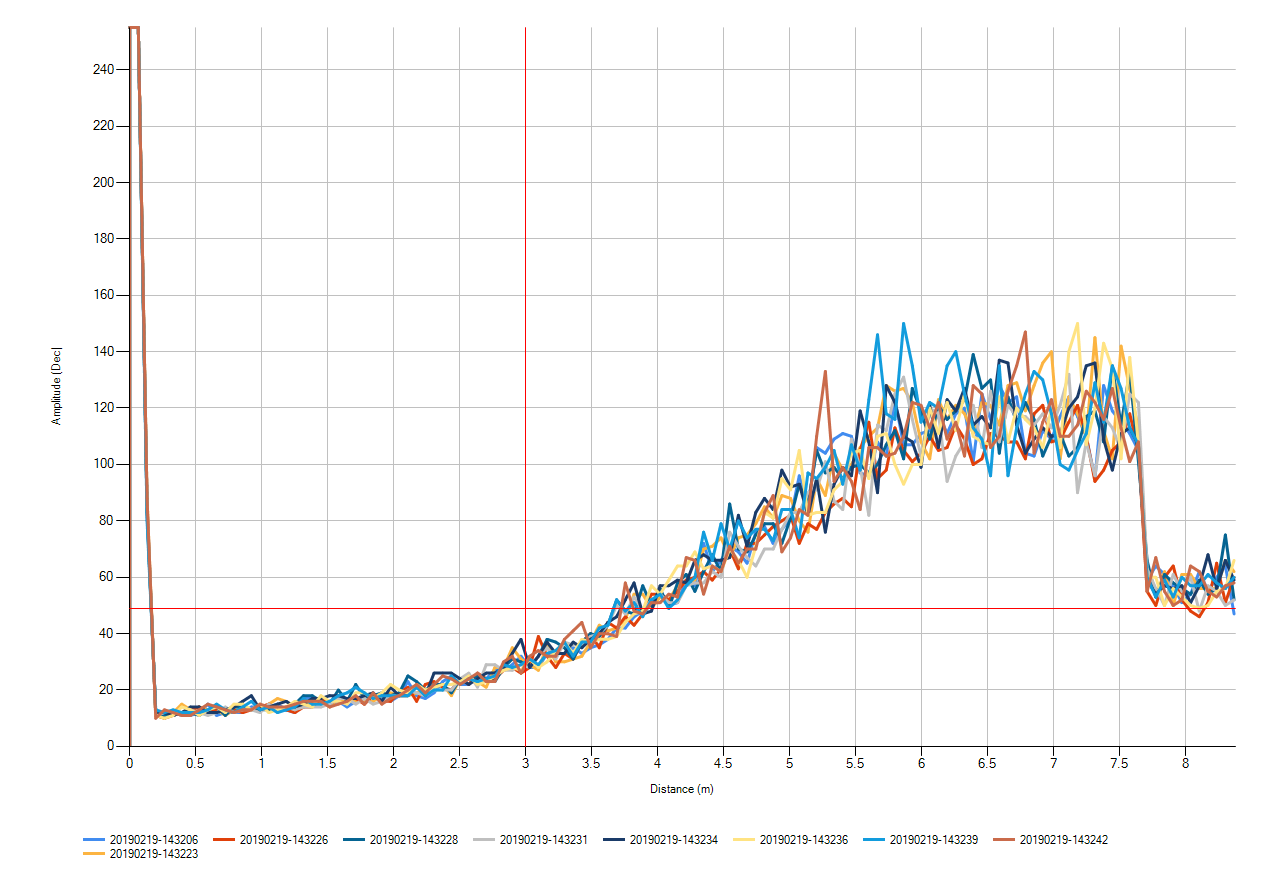

We see a large variation on the echo data dump for the different PGA devices in spite of them being mounted on the same board, powered by the same power supply.
Our question being, is it normal to see a large variation on signal between two PGA devices sharing the same settings and Power Supply.
Kindly note that while running the Data dump, each PGA was run alone. Meaning, no two PGAs were sampling data at the same time.
The above EDD is for what I will call PGA1, using Sensor Board 1
The above EDD is for what I will call PGA3, using Sensor Board 1. Kindly note that both echo data dumps were taken on an empty field of view.

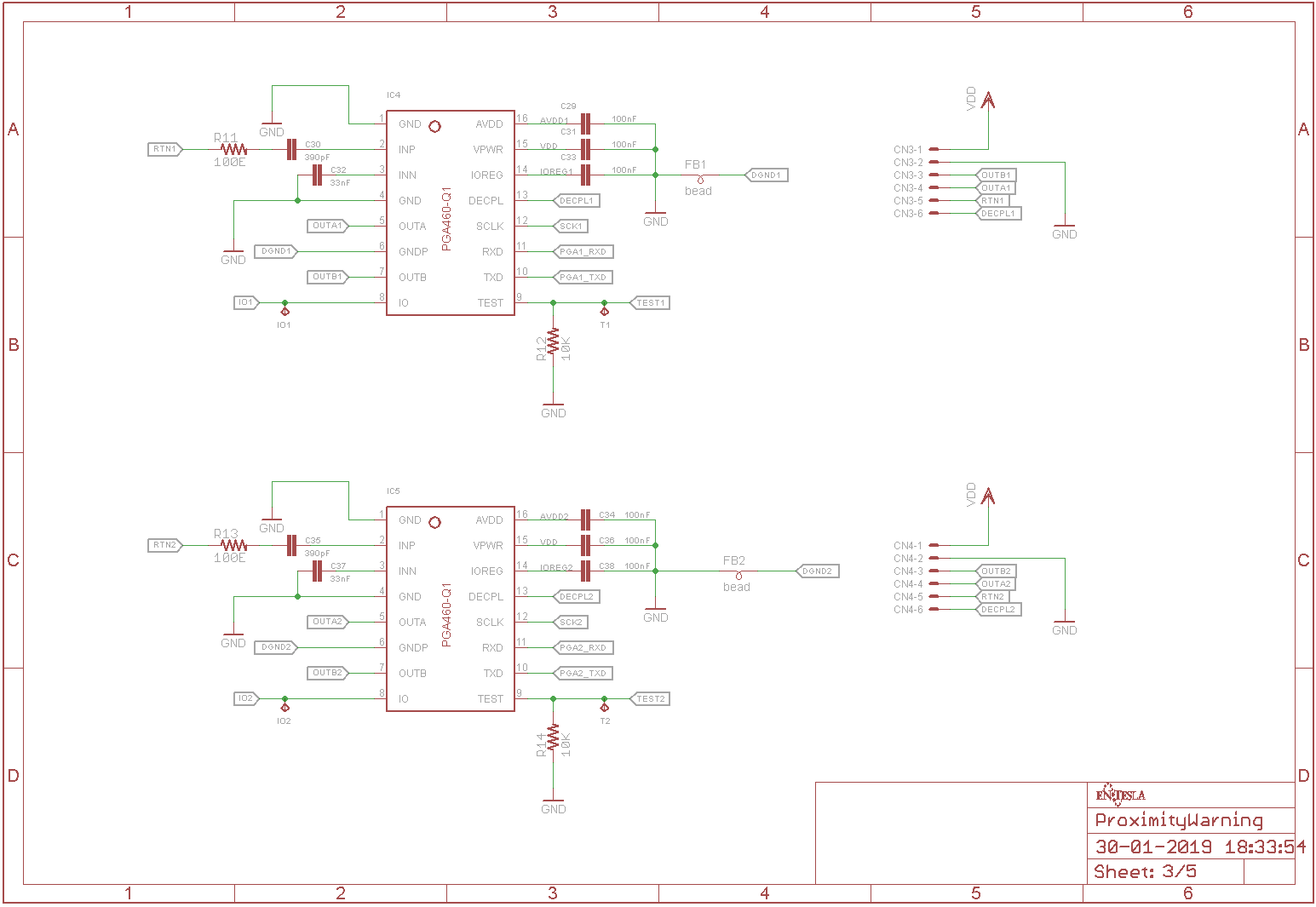

The schematic for the PGA section is attached below
  • Hi Vishal,
    It appears that you have a larger than usual noise floor. What is the frequency of your switch power supply? You may need to include a low pass filter at the input of the VPWR pin of the PGA460 to filter out any noise from the power supply / system that otherwise couples onto the PGA460's AVDD reference voltage. If AVDD is not stable, the PGA460's AFE noise floor will increase, resulting in SNR reduction.
    How do the results compare when using a different voltage source (i.e. bench supply unit or battery)? Does the noise floor decrease?
    Regarding your schematic, what is the impact of using a zero-Ohm short at FB2 instead of a ferrite bead?
    Are there any other sub-systems that are switching (i.e. a motor) on this product?
  • Hi Akeem,
    Thanks for the reply,
    We are now using a complete linear power supply chain. Using 12V vehicle battery, regulating to 9V using LDO.
    We can see a considerable difference in the noise floor. The noise floor has reduced to great extent. We are setting thresholds using auto threshold mechanism.
    Now the issue is, Whenever vehicle ignition is ON, noise floor of 5m - 7m range increases by 20-30 points with respect to vehicle ignition OFF state.
    Also. When we are connecting the sensor using 15cm cable instead of directly soldering it on Sensor daughter board, the overall noise floor is low,but the echo peak return value is also low.
    Can you please suggest which is the optimum way to connect sensor to transformer? Using wire or direct solder on board?
