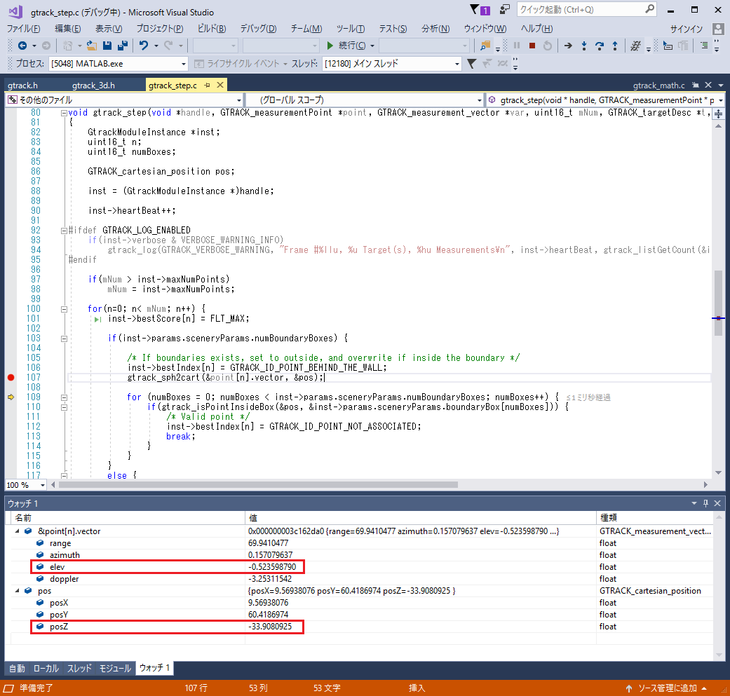

I set "elev" to "-0.52" and moved GtrackLib.
As a result, the value of "posZ" of the state vector converted by "gtrack_sph2cart" function is -33.9.
I thought that the calculation result that the Cartesian coordinate Z position is -33.9 is not appropriate.
Thanks.
  • Hi Koji,
    The "elev" field is the elevation angle of the detected point in the point cloud.  For a point in 3D space defined in polar coordinates, you have range, azimuth (angle - radians) and elevation (angle - radians).  So you can synthesize an elevation based on the X,Y,Z coordinates of the data set (as well as range and angle).
    With IWR1642BOOST antenna pattern, you cannot get the Z coordinate, as it is a 2D configuration.  If you want to synthesize the elevation, you should set the Z coordinate to be equal for each point in the point cloud, then calculate the polar coordinates for each point.
    Justin
