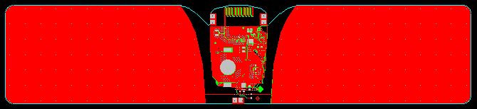

    Trying to clarify my design for you, that's a single board (circuit + electrodes) powered by a coin battery CR2032. All the CIs are TI! I'm using FDC2122 as the sensor, CC1310 as processor and RF link, and TPS610981 as Boost to keep the minimum required voltage to FDC (2.6V) even when the battery goes down this voltage. The electrodes are been used as balanced. See figure below to understand the construction.

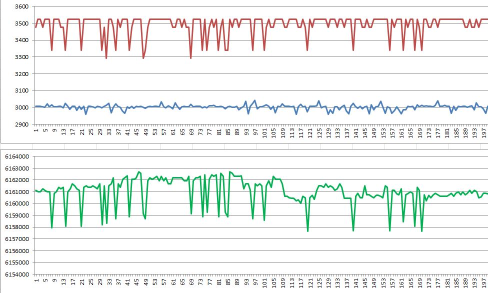

  • Dear Kristin,
    I think that the blame is TPS610981.
    I started to read the Vbat (before regulator) using ADC, Vcc (after regulator) using CC1310 AON_BatMon lib, at the same time that I read FDC. That value peak read from the FDC is also seen in the voltage Vcc, see the figure below. (I cannot see it on the oscilloscope).
    The blue line is the VBat, the Red line is Vcc (after TPS) and the green one is the FDC raw read value.
    So, I'm starting to investigating TPS610981 instead of FDC2212.
    Just to be sure, I removed the TPS from the board and passed through the Vbat to Vcc, all the peak value are removed.
    The blue line is FDC raw data and Red one is battery voltage.
    Just a question about this last graph, why the FDC raw values decrease with the Voltage? It should be a relation of Freq_In/Freq_Ref, it's not? What's should be changing with the input voltage, Freq_in (tank circuit) or Freq_Ref (internal oscillator)?
    Answering your question about MUX_CONFIG.DEGLITCH, it's set to 33MHz, but I already used 10MHz and there was no difference in that.
    Thanks and best regards...
    Ivan
  • Hi Ivan,
    I'm glad to hear you found the source of your error.
    As for your question about the last graph, it is likely F_in that is changing. The sagging battery voltage could cause the sensor oscillation amplitude to sag as well, which could interfere with the internal frequency measurement. Certainly when the sensor oscillation amplitude is outside of the recommended range (1.2-1.8V), the SNR suffers.
