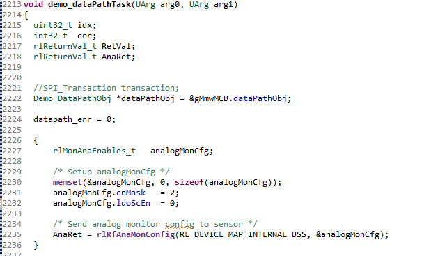

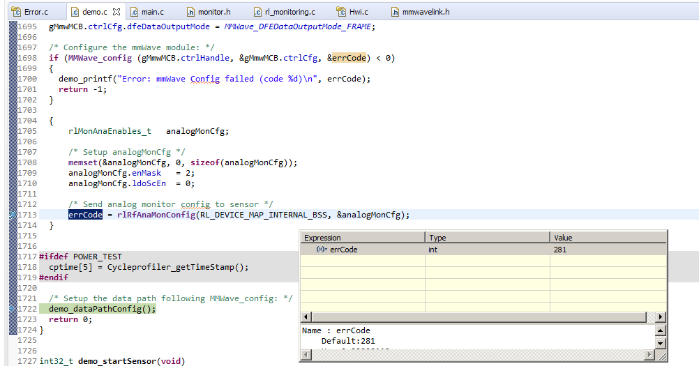

I have issues enabling analog monitoring in the IWR1443. I am running the level sensing demo, with just a few modifications, and are trying to enable one of the analog monitors with the rlRfAnaMonConfig function according to below. I have tried almost all of the supported monitors but the function rlRfAnaMonConfig always returns with the errorCode = 281. (RL_RET_CODE_ANALOG_MONITOR_NOT_SUPPORTED).
I would really appreciate help on this issue, because I have no more ideas left.

  • I am using SDK version 2.01.00.04. I use the mmWave control lib and the BSS binaries included in the SDK, i.e no separate DFP.

  • Putting the call in the calibration task doesn't feel like a good solution, since that task is only running when a full calibration is commanded. I have tried putting the call at the beginning of the demo_dataPathTask (see below), but I get the same result as before. I.e. the rlRfAnaMonConfig function returns with errorcode 281.

  • Hi Honke,
    I was able to recreate your error although I was not able to find a fix yet for the Monitor of other Rx Noise Figure. I am checking with my team if this particular monitor is currently supported.
    I do have a few changes to recommend,
    First fix is to slightly change your memset line to the following:
    memset((void *)&analogMonCfg, 0, sizeof(rlMonAnaEnables_t));
    Next, You are trying to monitor Rx Noise Figure or otherwise? An easier way to set this is to add the bottom definition to the bottom of the demo.h file and then set your enmask in the following way:
    analogMonCfg.enMask  |= 0x1 << MMWDEMO_ANALOG_MONITOR_RX_SATURATION_DETECTOR;
    I have been able to work the analog monitor with MMWDEMO_ANALOG_MONITOR_RX_SATURATION_DETECTOR and MMWDEMO_ANALOG_MONITOR_RX_SIG_IMG_BAND.
    We are looking into MMWDEMO_ANALOG_MONITOR_RX_NOISE_FIGURE , if there are other analog monitors you are looking at please let us know.

  • Hi Honke,
    Unfortunately Analog Monitoring is not a supported feature on IWR1443 devices but only the AWR1443 variant.

  • Hi Hakan,
    I have learned that for IWR devices only CQ monitoring is currently supported. Both Analog and Digital monitoring on not supported on IWR devices.
