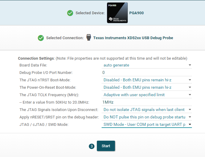

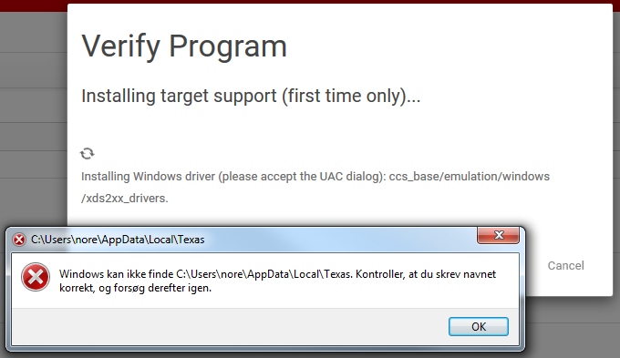

Hi. I would like to use UniFlash to verify a programmed image on a PGA900, but I’m having some trouble connecting to the target. I'm using the XDS200 debug probe and I have tried various different target configurations both in the stand alone application and the Cloud version. I get different errors but I still have not succeeded in connecting.
Stand alone application is version. 4.6.0.2176 and I'm running Windows 7. Here are some of the error messages.
[ERROR] CS_DAP_0: Error connecting to the target: (Error -1170 @ 0x0) Unable to access the DAP. Reset the device, and retry the operation. If error persists, confirm configuration, power-cycle the board, and/or try more reliable JTAG settings (e.g. lower TCLK). (Emulation package 8.0.903.6)
[ERROR] CS_DAP_0: Error connecting to the target: (Error -615 @ 0x0) The target failed to see a correctly formatted SWD header. The connection to the target may be unreliable. Try lowering the TCLK setting before trying again. (Emulation package 8.0.903.6)
