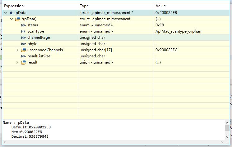

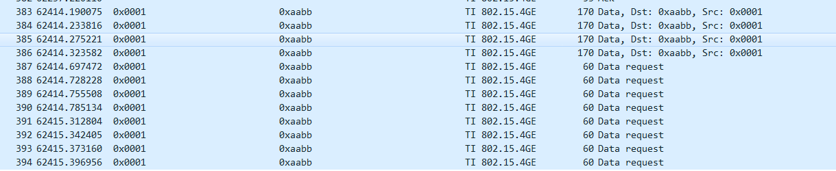

Ti 15.4 stack sensor communicates with collector normally, collector power off, sensor becomes isolated node, callback status is E8?
Tool/software: TI-RTOS
Can you try to reproduce this with an unmodified sensor example? it looks like you have made modifications to the code because your sensor is not sending the orphan notification. Based on the status that you are getting my guess is that you have made modifications to the function "sendScanReq" or you added a call to the function "ApiMac_mlmeScanReq" and you are calling it with incorrect parameters
Okay, I'm debugging it myself. I'll give you feedback if there's a problem.
