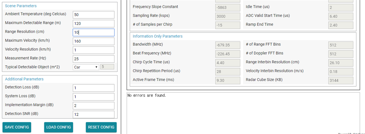

2) If not, then I  would like to have the IWR6843 with the options produced by Estimator (please see the attached). Does this require additional cost?

    Also, your maximum Range, Range Resolution and Velocity requirements appear to cause the Sensing Estrimator to generate invalid value (e.g. negative slope, negative bandwidth etc). We will look into why the Sensing estimator is generating these invalid values instead of generating errors. But these invalid values indicate that the specified application parameters cannot be achieved as is so you may try to reduce your requirements such as maximum velocity, velocity resolution, range resolution etc and see if that still fits your use case.
