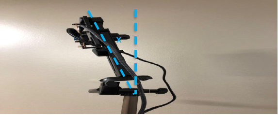

I'm using the 3d people counter on the IWR6843  board using the updated lab GUI (for 3d ) and cfg file.
The radar is mounted on 1.8[m] tripod with ~10 degrees tilt in elevation ,towards the ground (as appears in the instructions)
The GUI stores the data sent through the UART.

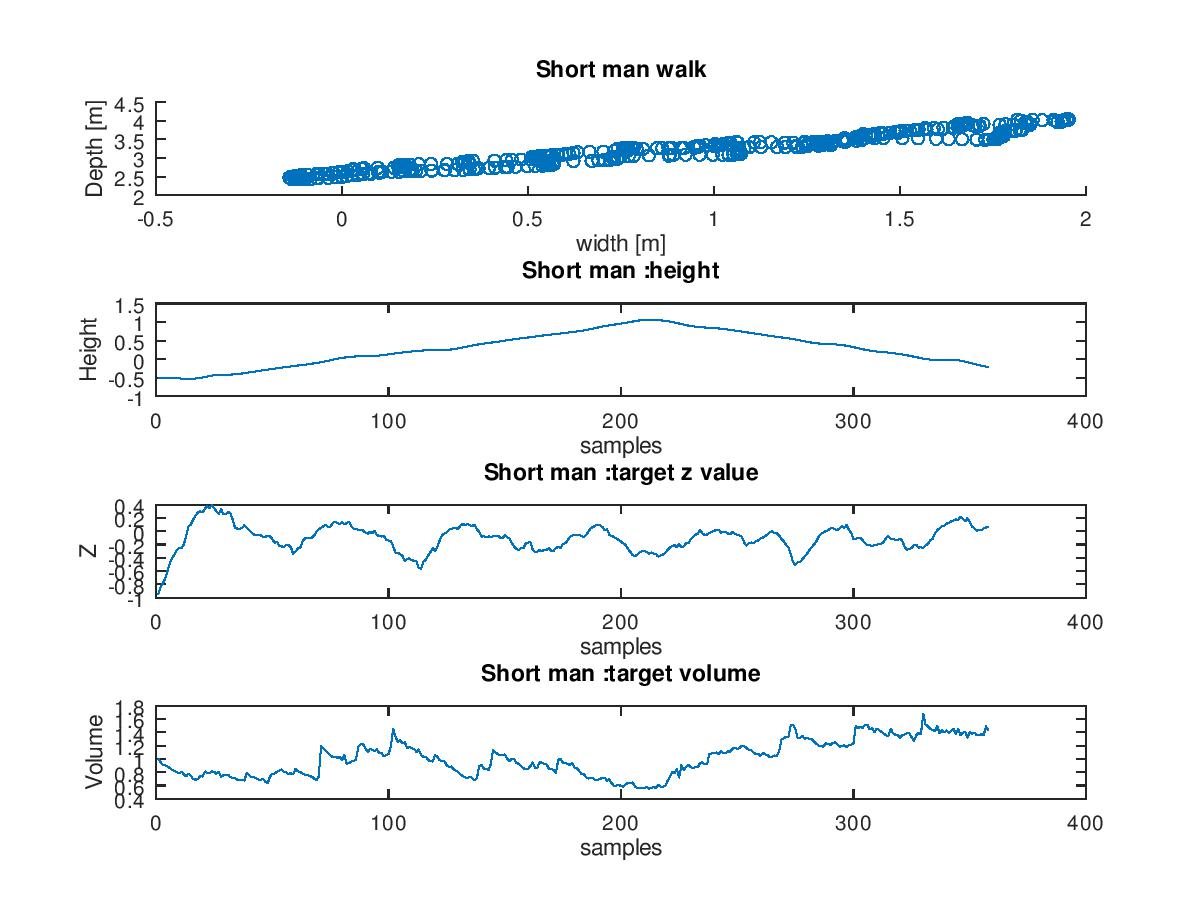

3.I've recorded a person walking at this configuration
   Radar is placed at (x=0,y=0)
   person starting point (x=2,y=4)
   The person walks at angle of 45 degrees towards the radar at around 0.3[m/sec].
   The height of the person is 1.68[m]
   The used cfg file is attached.
   The fHist.mat is attached
   When examining the height and z values (from the matlab gui output file fHist.mat) along the detected targets, the values aren't stable.
   Here i show the following:
  •   Top view of targets along the walk
  •   target height column values
  •   target z values
  •   target volume =Dx*Dy*Dz
Please explain why the the z,height ,and volume are not stable along the target's track.

    Hello Gil,
    The points returned by the tracker are not transformed or correct to account for the sensor's mounting position. The sensor does not know the height or downtilt you have applied.
    Therefore there are two issues:
    1) The target dimensions and position need to be translated to your spatial plane.
    2) There will be variability in the point cloud as you move if you are using the ISK sensor since it has limited elevation FOV. This means that you could be getting reflections from a different cross section of the person as they approach the sensor. This would make the point cloud for the person shift and the resulting dimensions would change. A wider FoV antenna would be less likely to have this issue.
