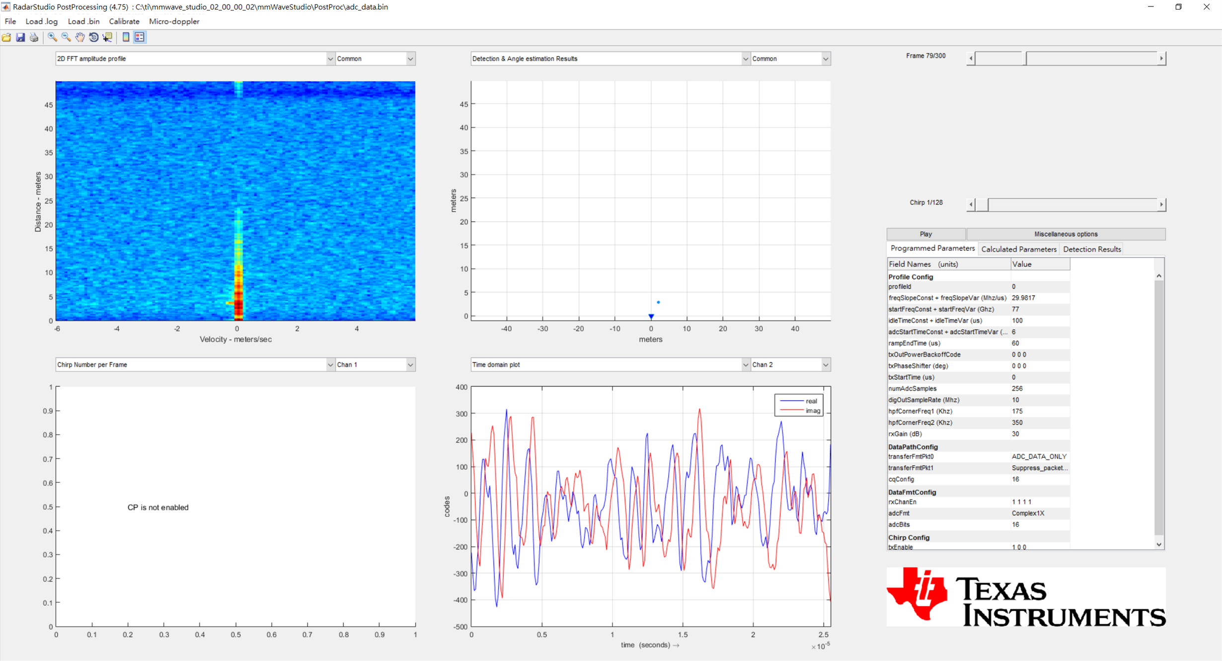

Why is frame sometimes show that it has no detected points ?

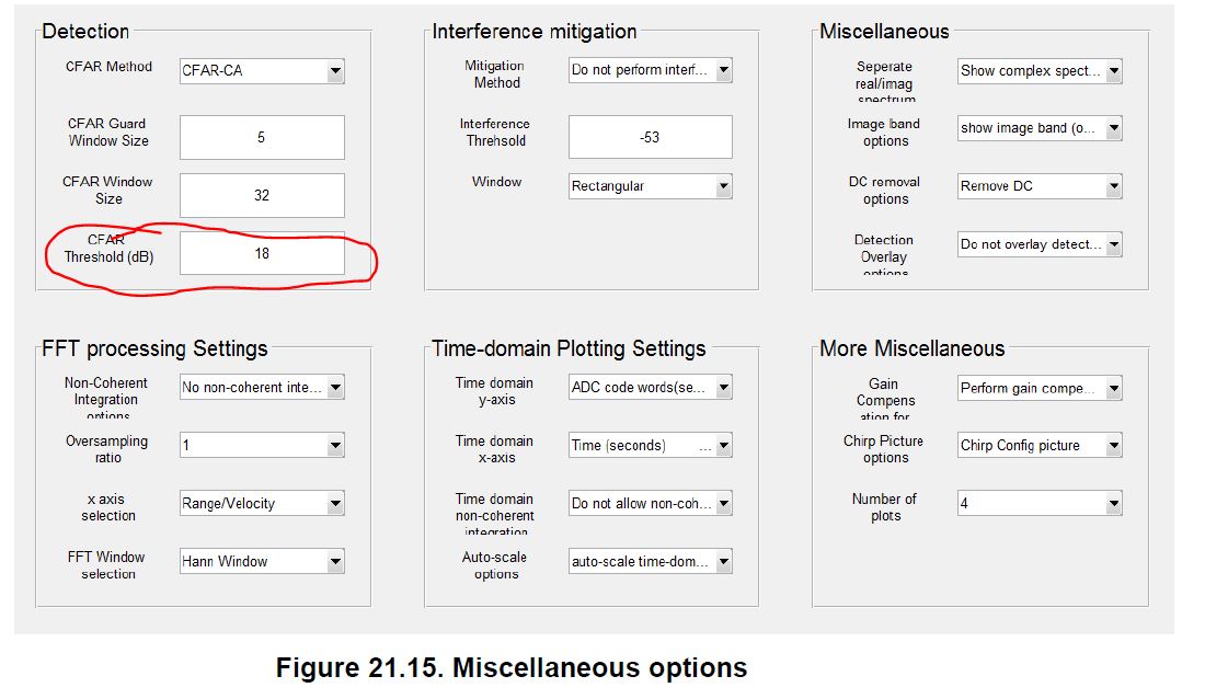

         Detection threshold may be higher as compared to energy of the reflected signals.
         You could select miscellaneous option and change the CFAR detection thresholds lowering the threshold would show more detected targets.
    Also you could plot 1D FFT (Amplitude vs range or frequency) to analyze targets near the radar and accordingly you could adjust the detection thresholds.
    For more details you could look for mmWave studio user guide in the below folder.
    C:\ti\mmwave_studio_0x_00_00_0x\docs\mmwave_studio_user_guide.pdf
