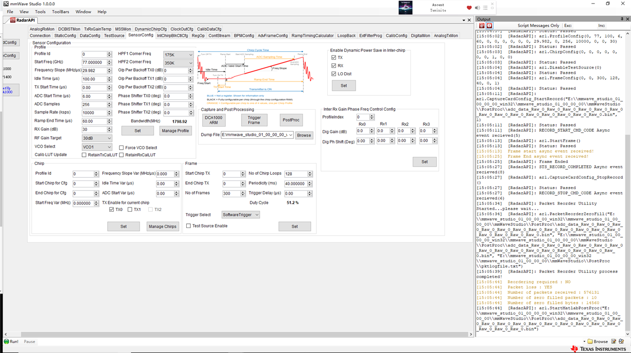

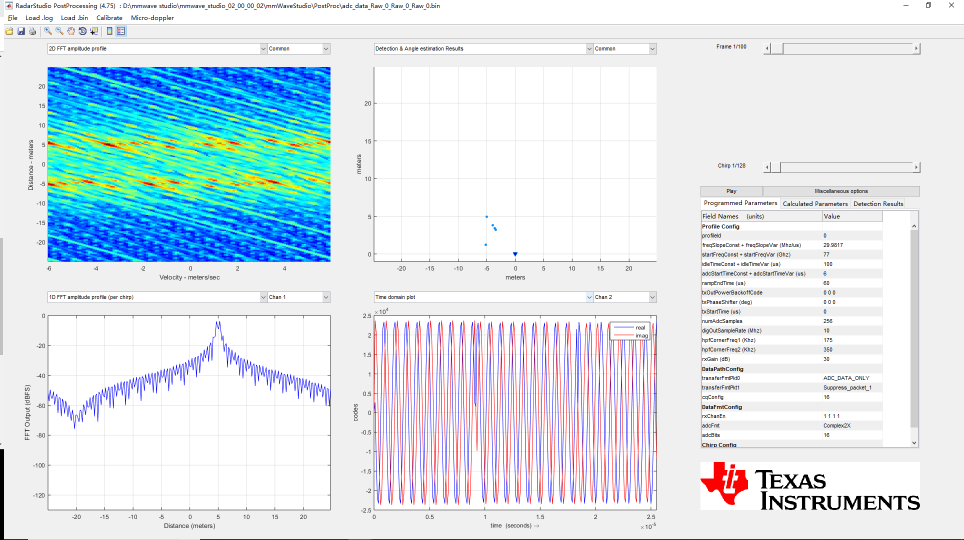

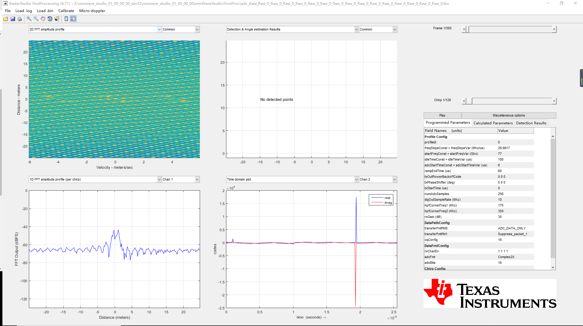

I follow reference document to capture rawdata,but I get wrong data. As shown in the following figure:
there is nothing in the figure of top left corner. meanwhile,when I change the experimental scene,I found it doesn‘t change. The following is my detailed experimental configuration
please tell me how to solve this problem.
thanks

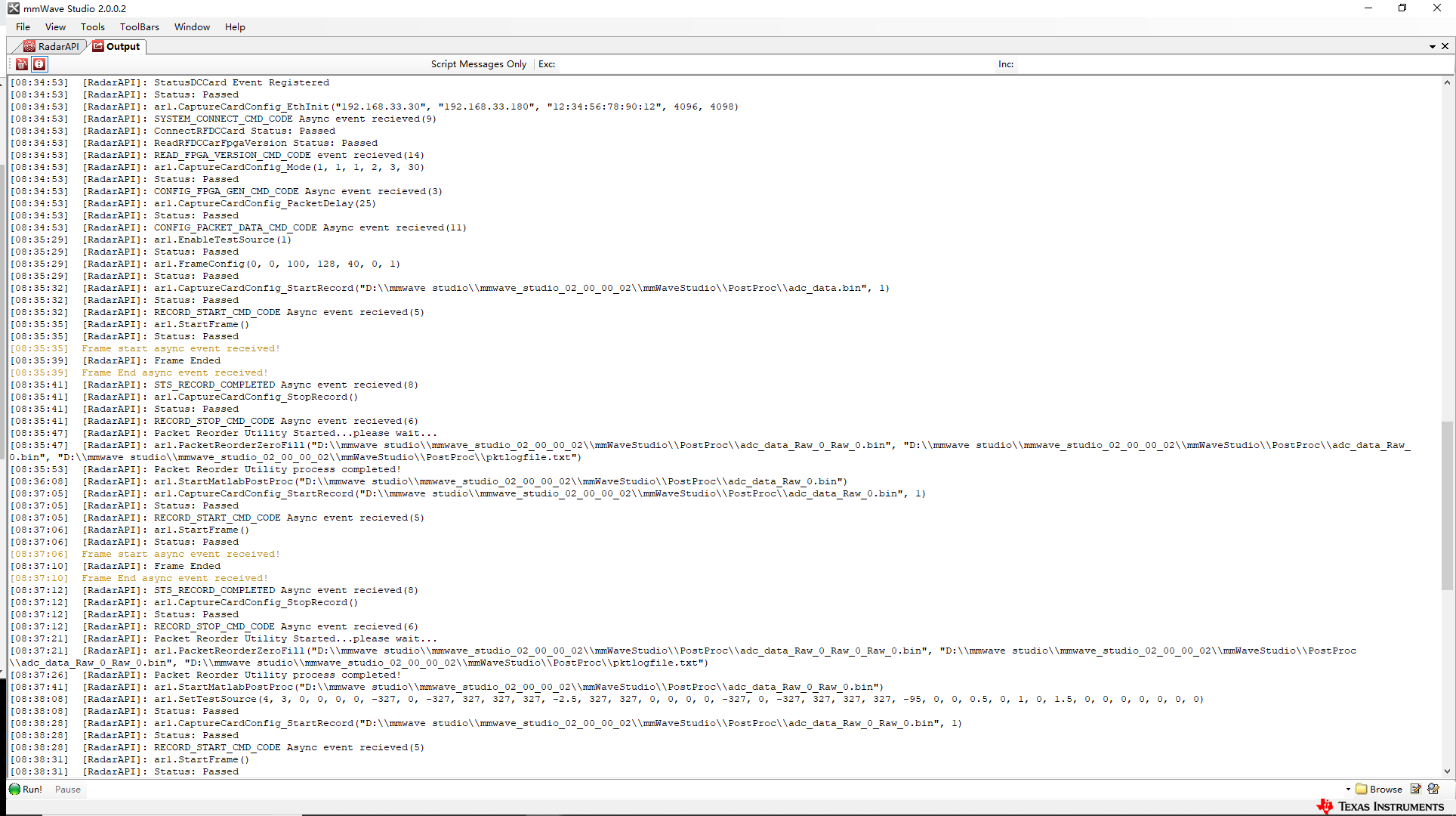

    I set Test Source Enable,results shown in the following figure.
    With the exception of the diagram in the upper left, the remaining three diagrams look normal. I wondered if it had something to do with my lab environment, because I was doing indoor multi-path testing.
    The next figures are Output:

    Thanks for your reply. In fact,my initial problem is 2D-FFT is wrong. You also can
    detect the problem from the above figures. How can I solve this problem.

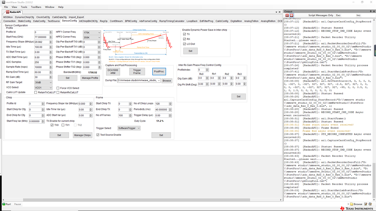

  • Hi Sleepybear,
    We don't see the test source being configured in the screenshots above - only the enable of the test source is seen.
    Can you explicitly configure the test source from the Test Source tab of mmWave Studio?
    - Anand

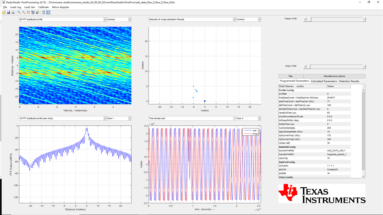

  • Hi Sleepybear,

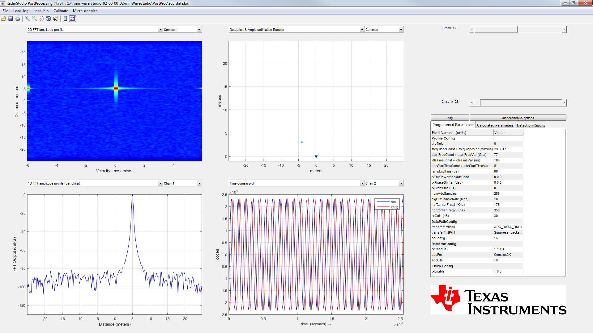

    We have checked this again with the same version of mmWave Studio and the same sequence of steps. With the test pattern, the data should look like the following image.

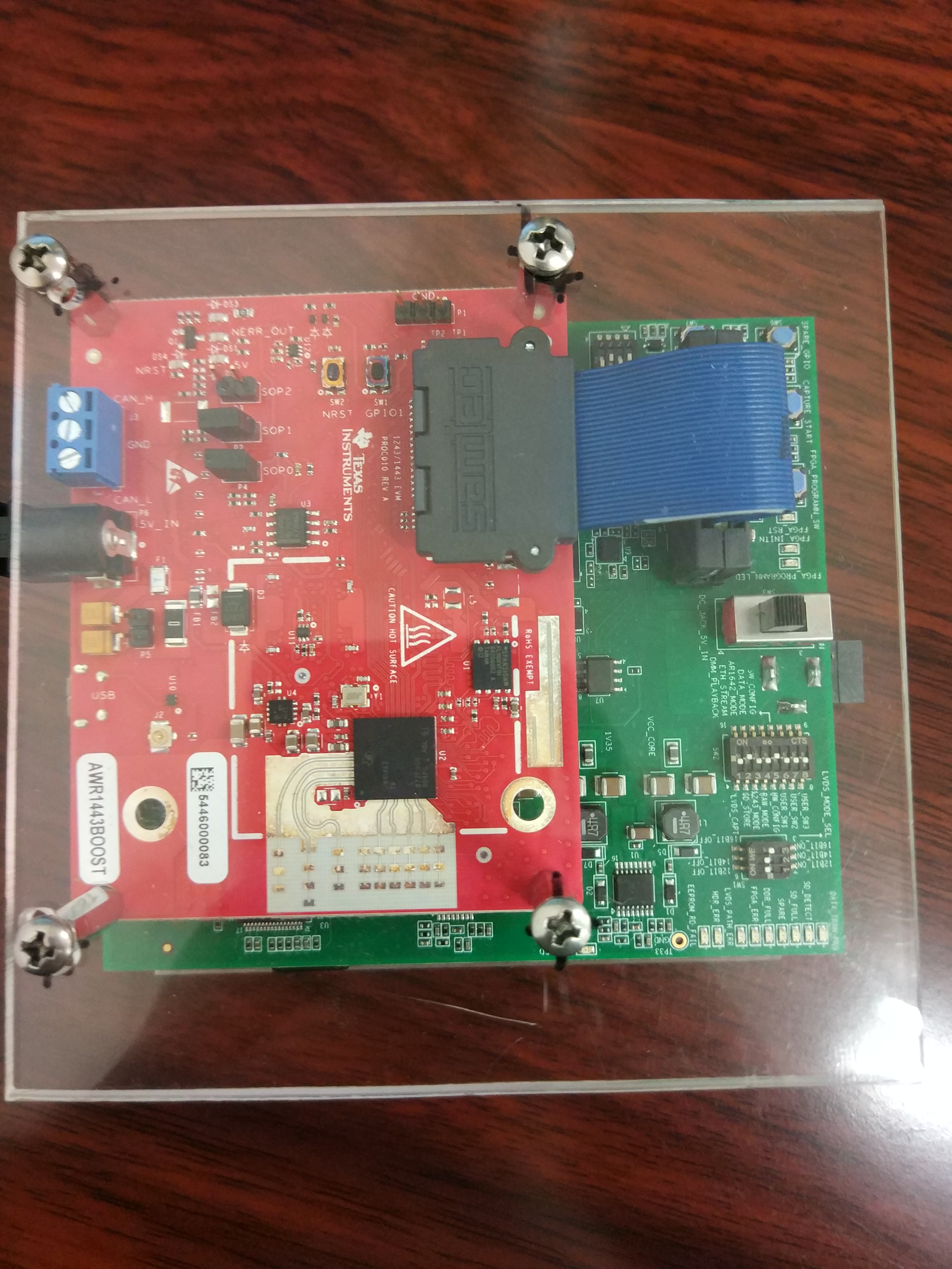

    Could you post a picture of the top side of your board here? We were wondering if there is a difference in the board revision that causes this.
    Anand

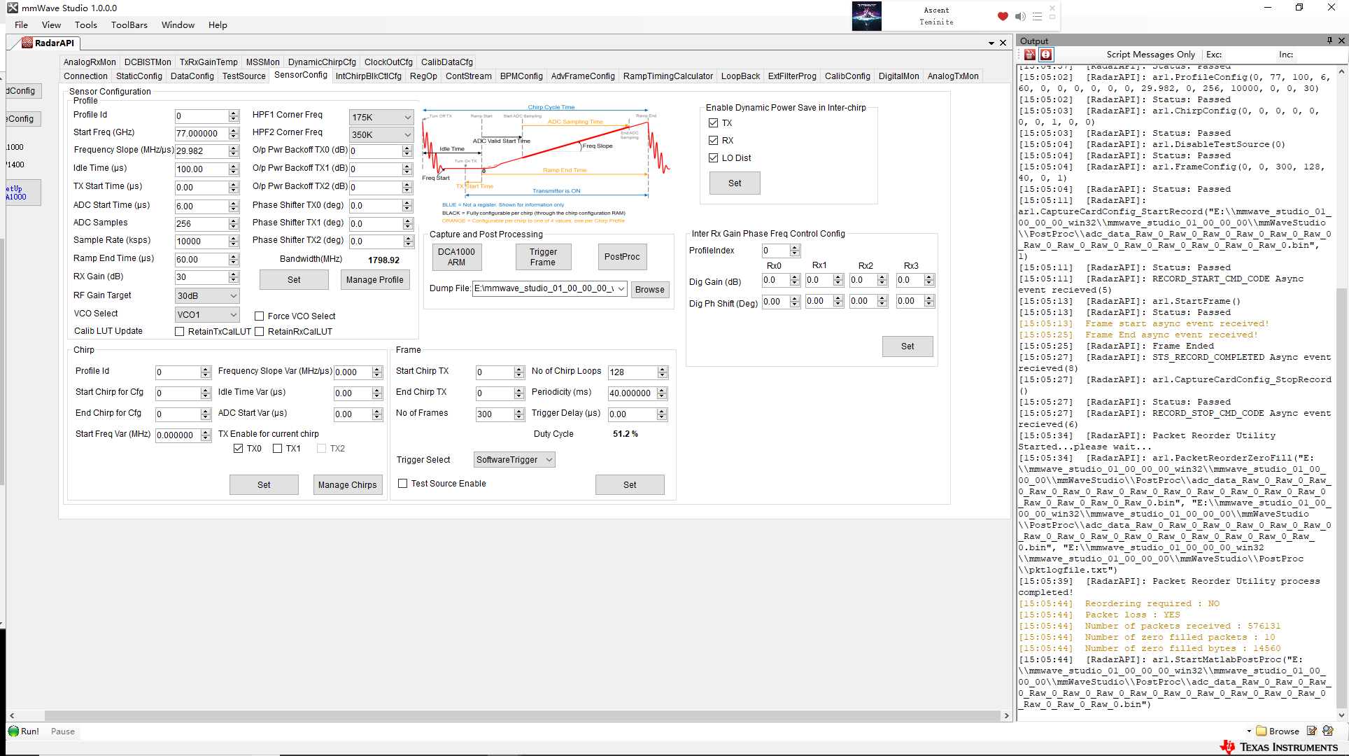

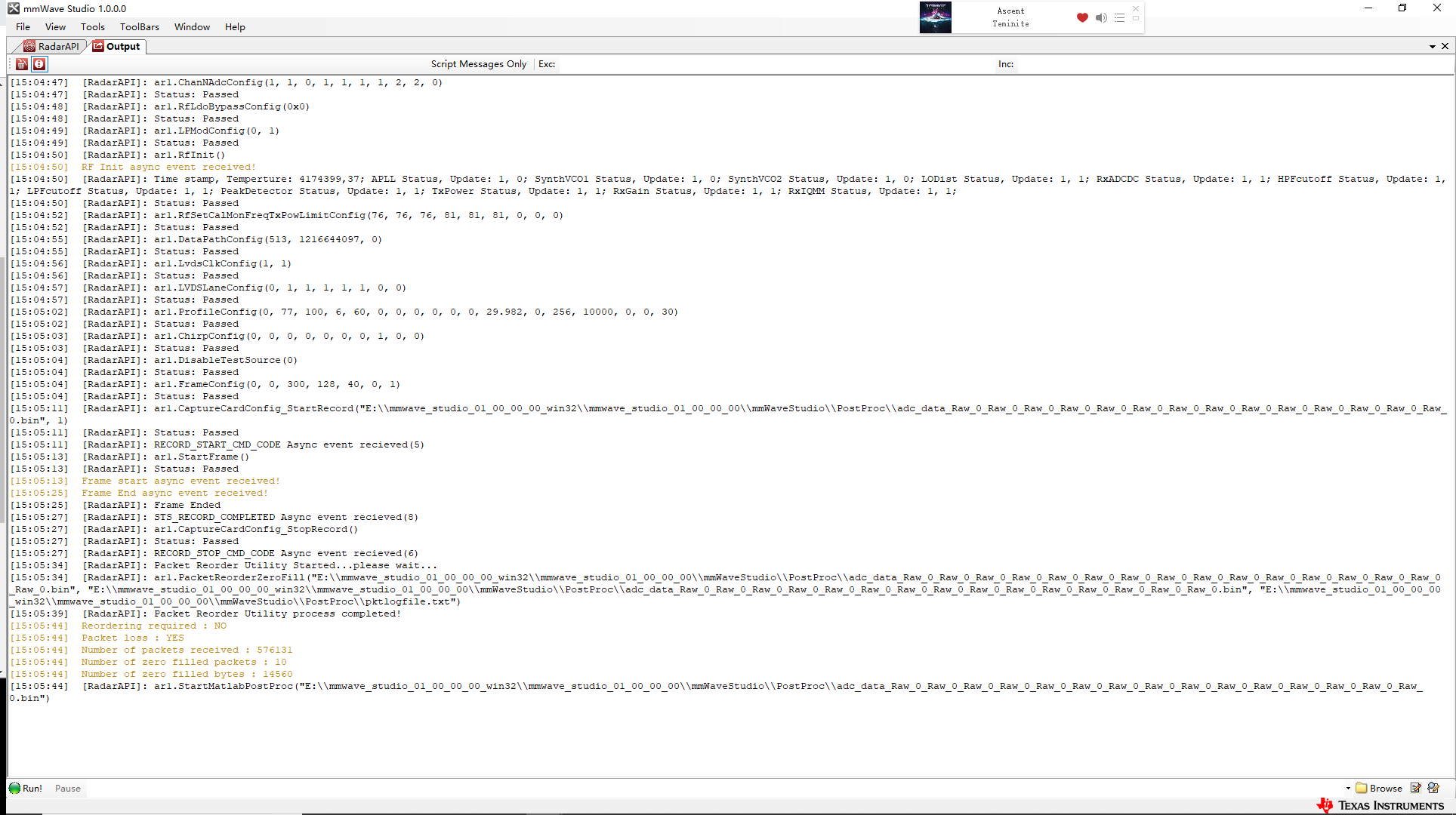

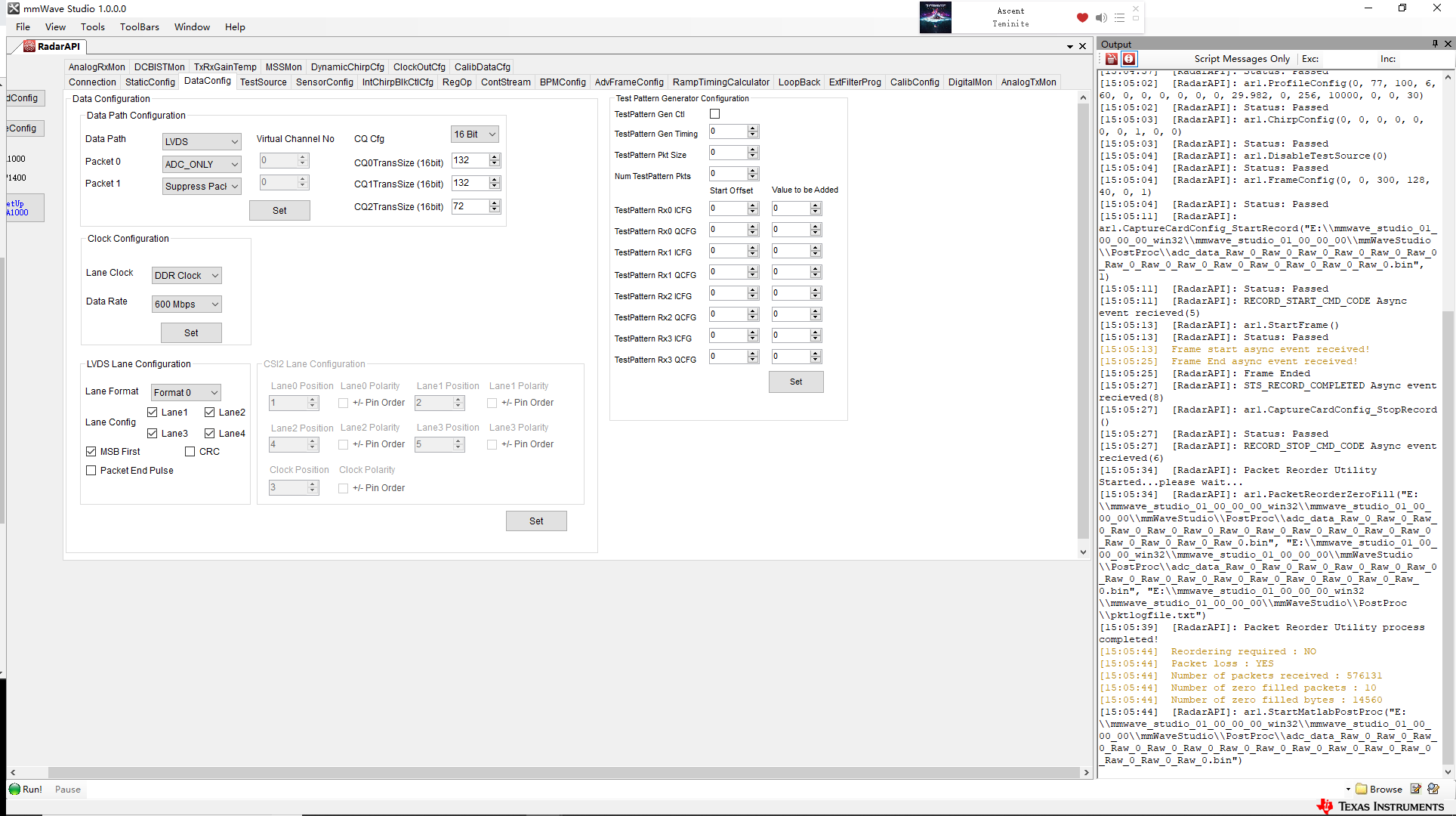

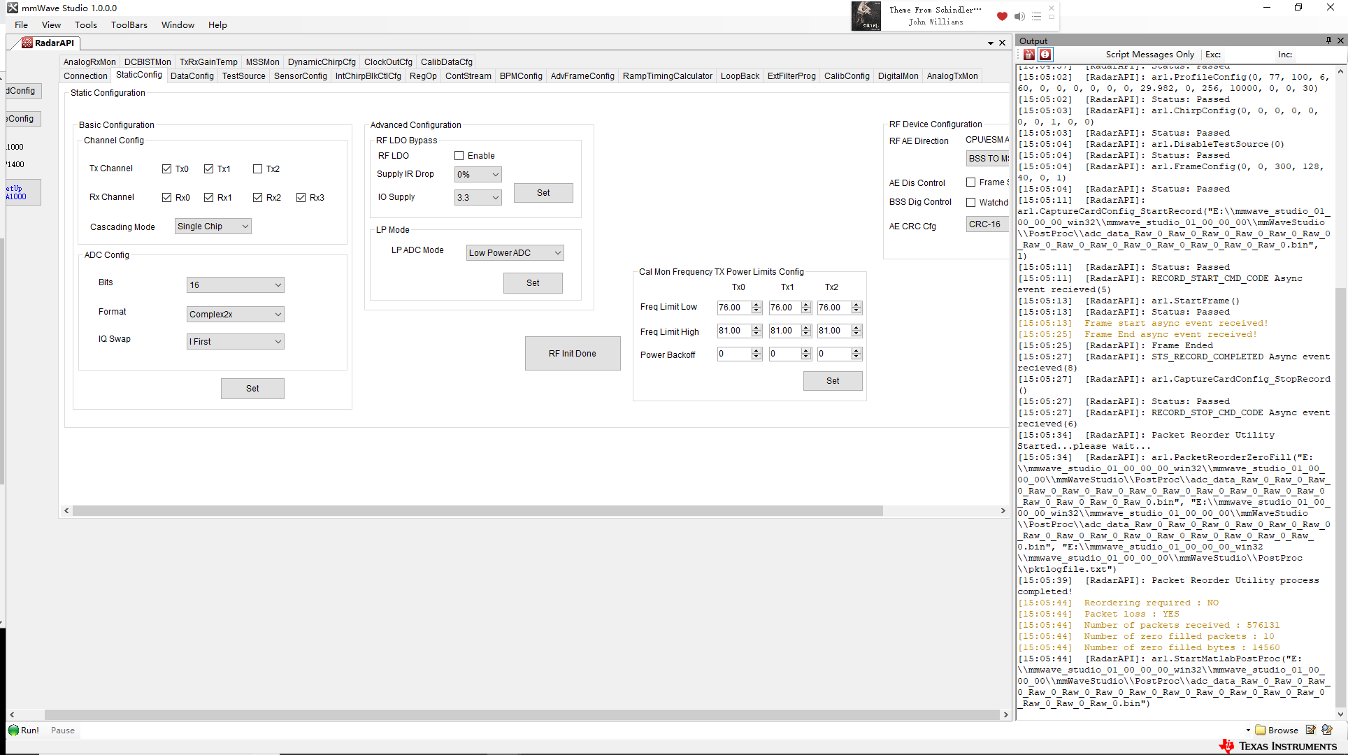

    My hardware configuration diagram is shown below.

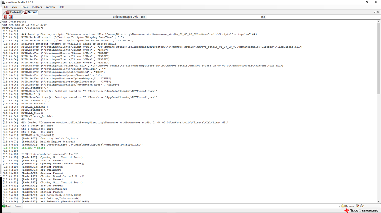

    Please allow me to describe my current experimental situation in detail., Now the data I get from mmWave Studio 01_00_00_00 on my desktop computer is correct, and the data obtained through mmWave Studio 02_00_00_02 is still shown above. At the same time, I have no problem with the data obtained by using the two versions of the software on the laptop. Please tell me what is the reason for this?
    Sleepybear
  • Hi Sleepybear,
    If I understand you correctly, then you have 4 cases:
    1) Desktop + mmWave Studio 01_00_00_00 --> WORKS
    2) Desktop + mmWave Studio 02_00_00_02 --> DOES NOT WORK
    3) Laptop + mmWave Studio 01_00_00_00 --> WORKS
    4) Laptop + mmWave Studio 02_00_00_02 --> WORKS
    Can you confirm?
    If the above is correct, can you please attach the 4 log files here? You can get the log file by Right Clicking in the "Output" Window in mmWave Studio.
    Anand

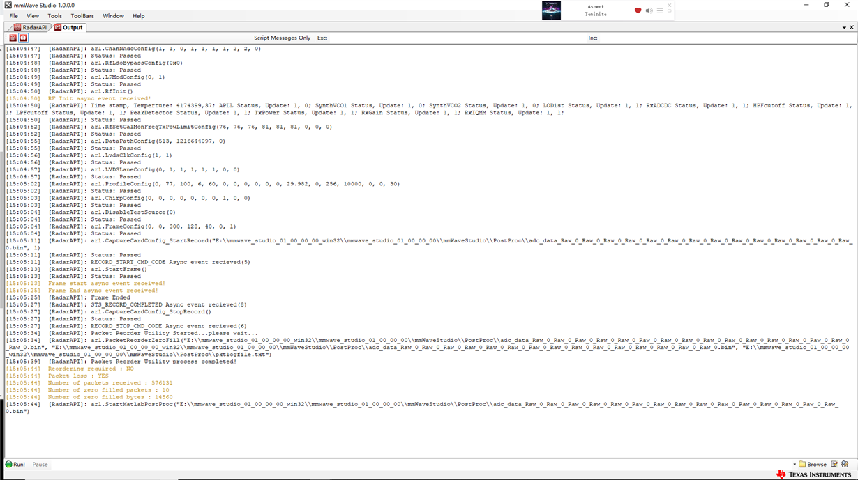

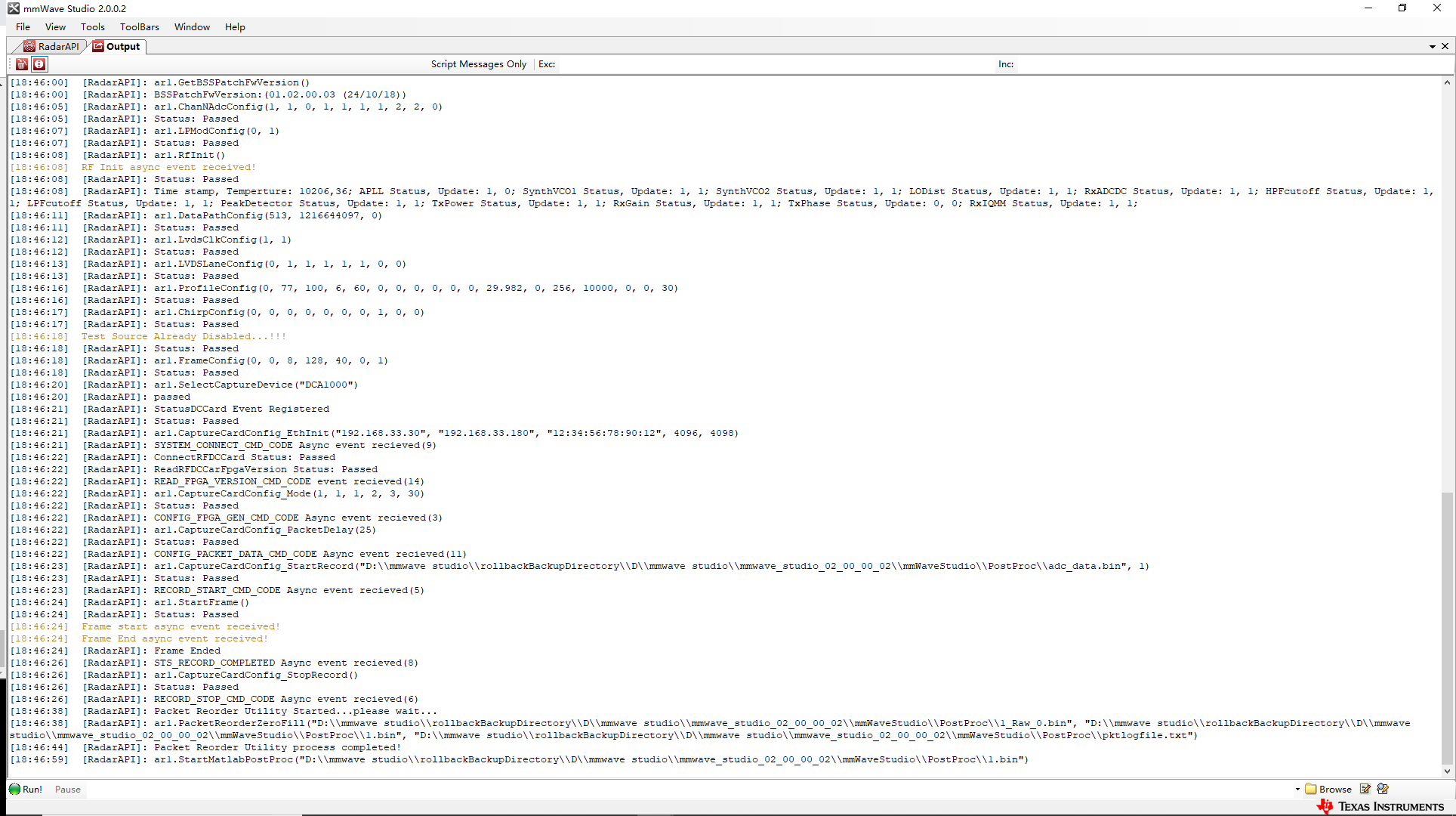

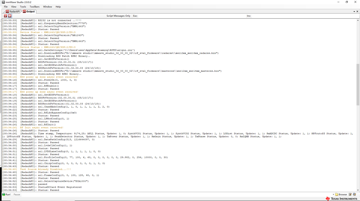

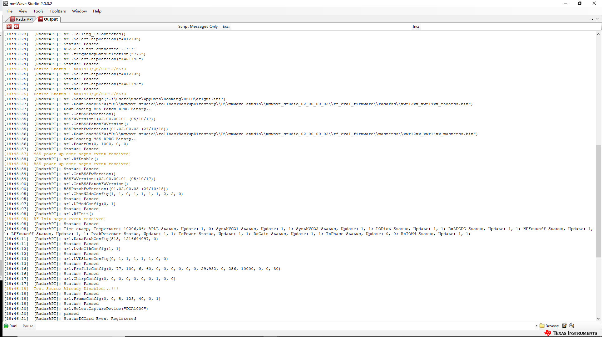

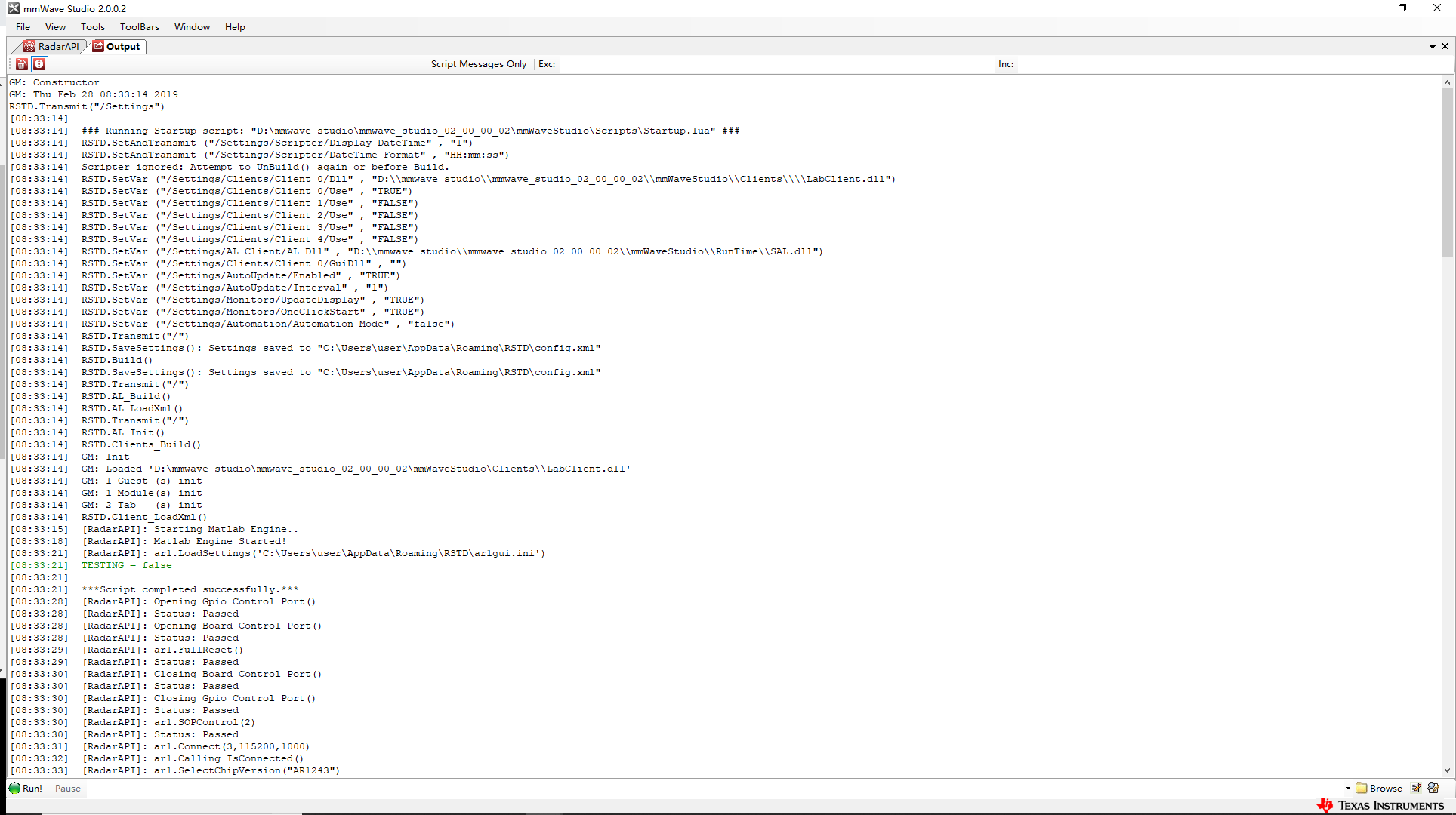

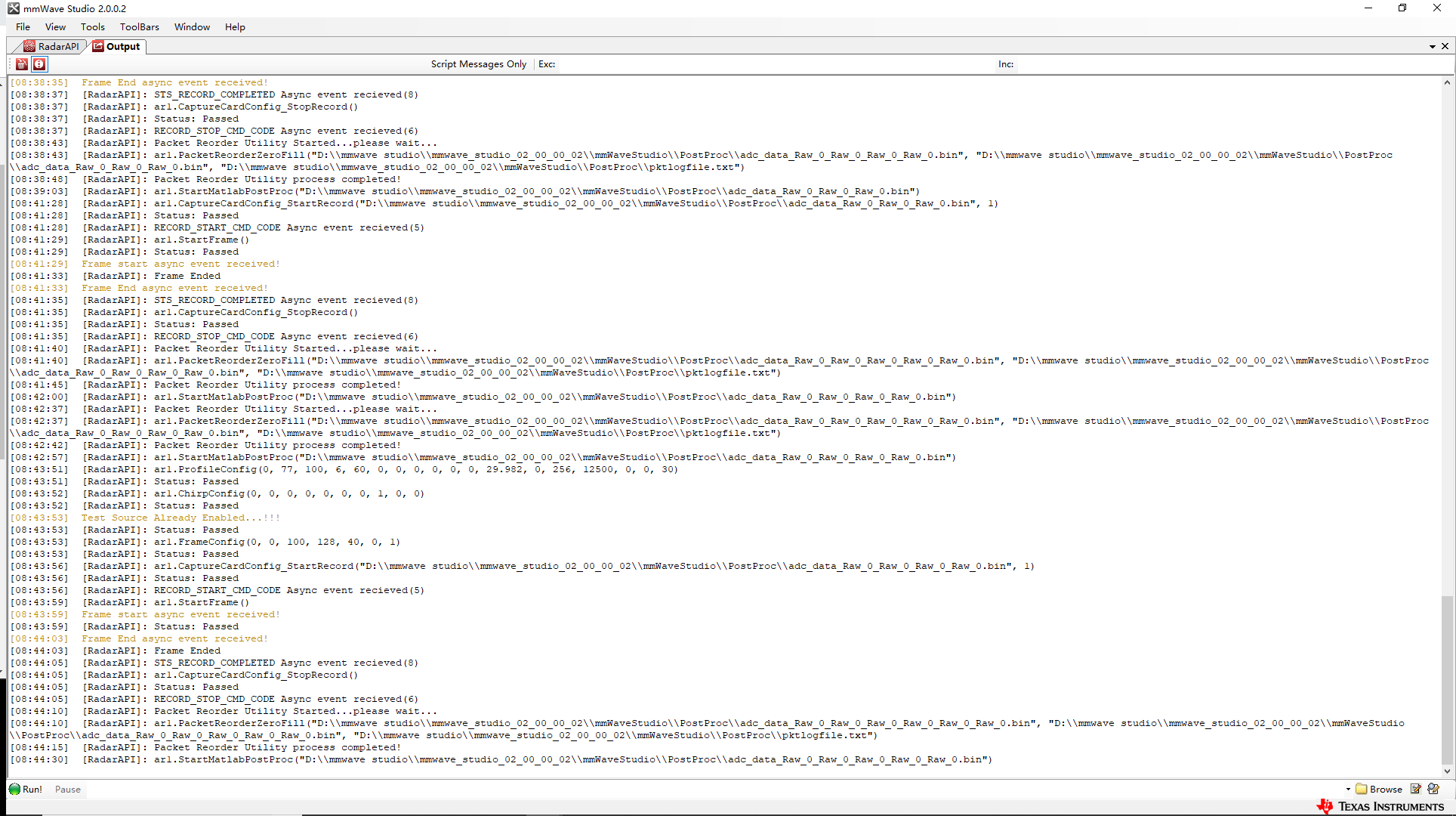

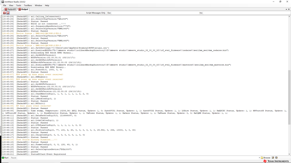

  • Hi Anand,
    Your description of my problem is very accurate.The figure below is the output of the second case.
    The output of the remaining three examples is exactly the same as the one on the map.
    Sleepybear

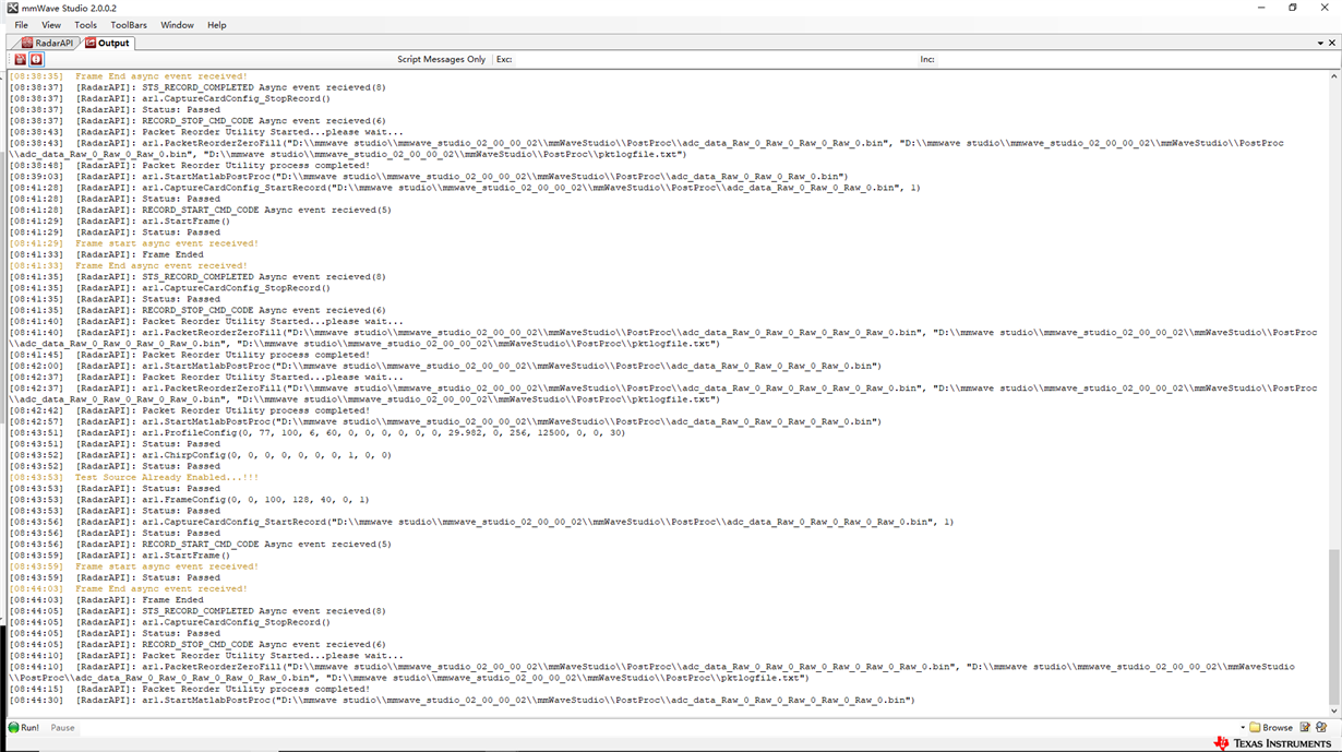

  • Hi Sleepybear,
    We have reviewed this configuration again, and cannot explain the difference.
    Your settings look okay to us.
    Please let us know if you would still like to investigate this behavior. If so, we will need to do another data capture on your desktop with the two mmWaveStudio versions and check - we can provide a script for this.
