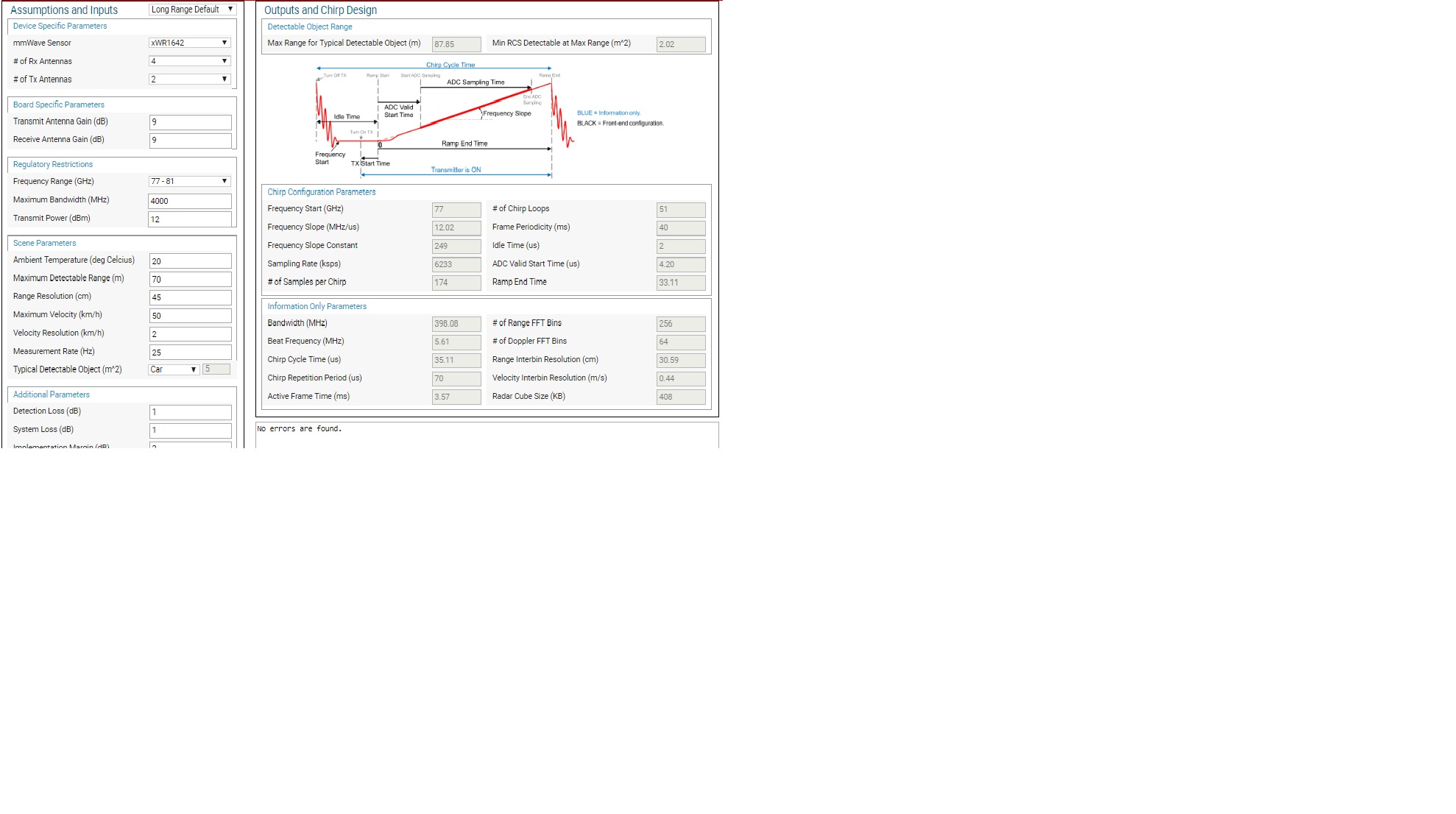

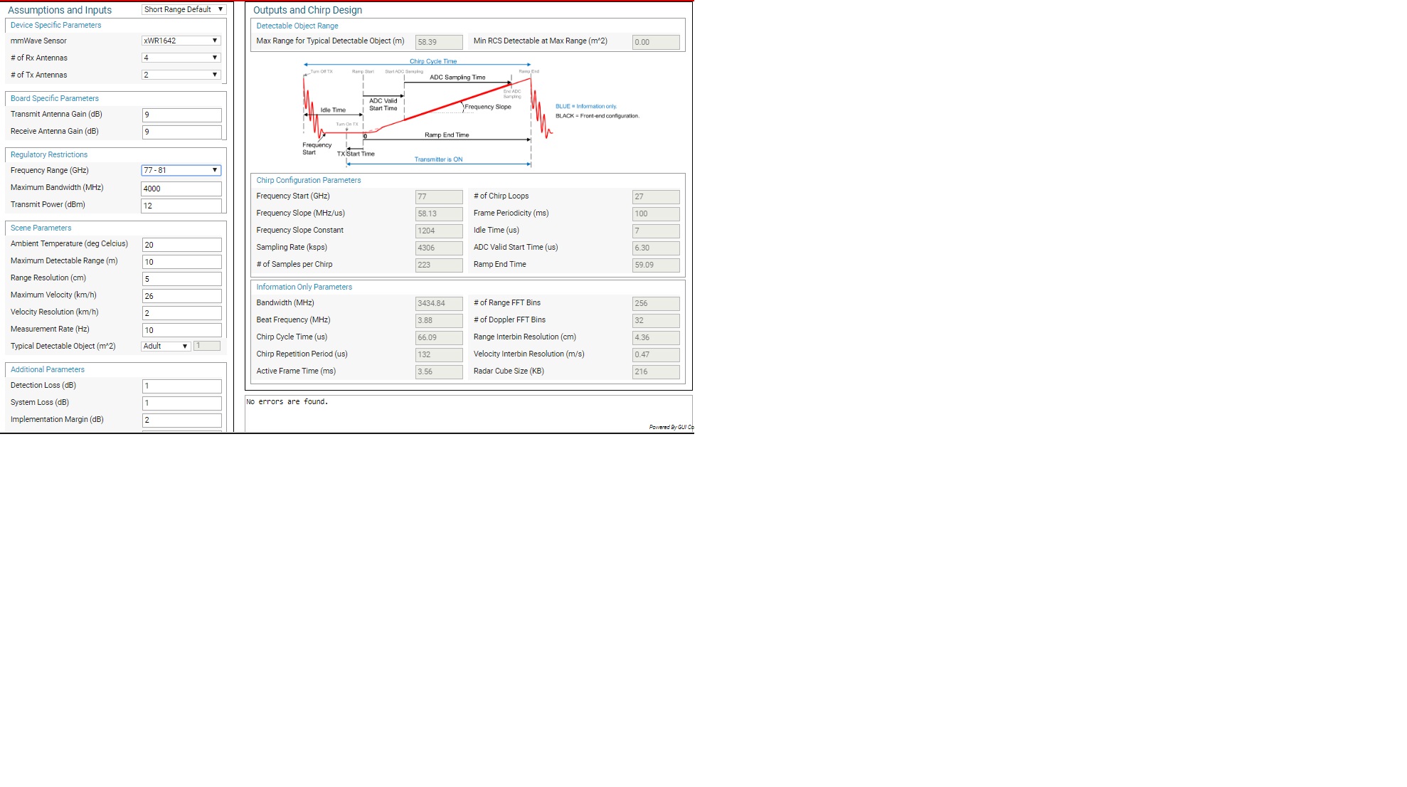

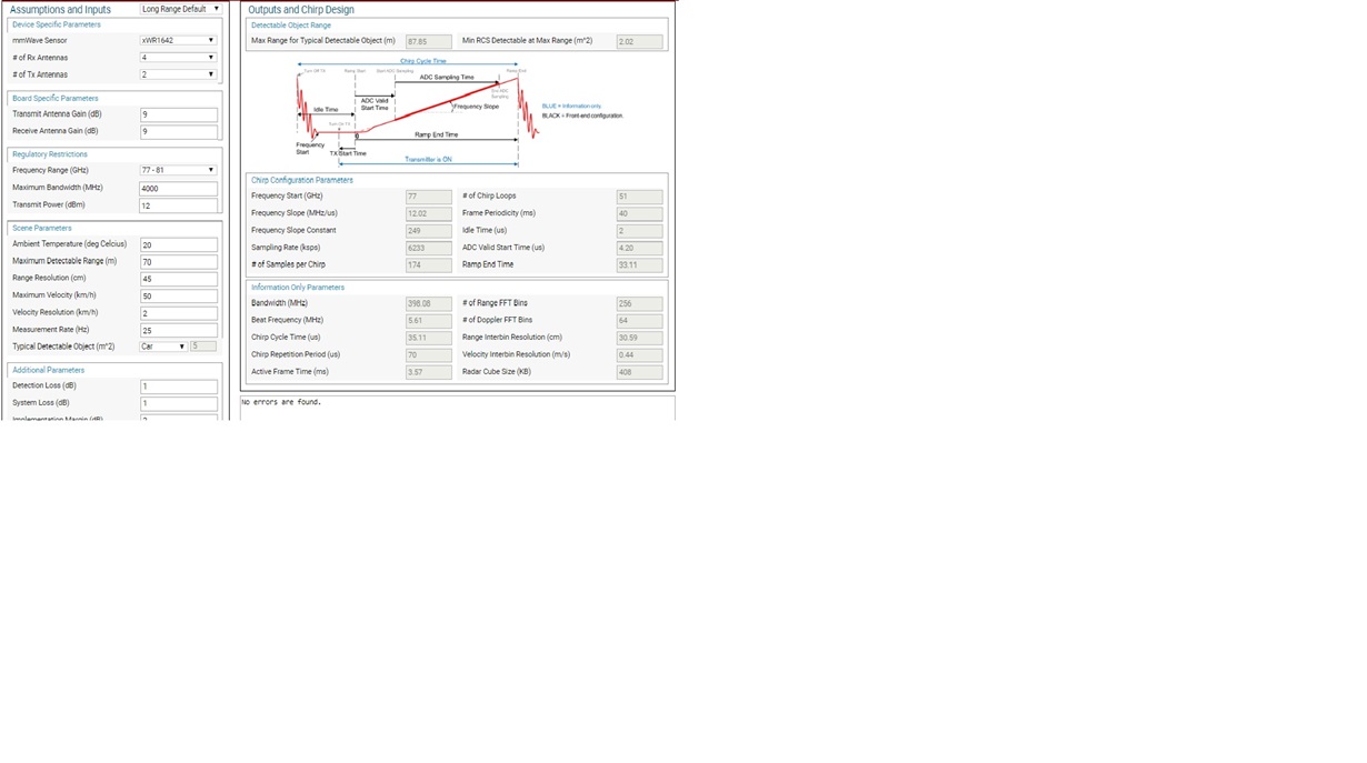

    1) The maximum velocity is determined by the chirp configuration you set. You can use the sensing estimator to understand the maximum achievable velocity given device constraints and other sensing requirements. Sensing estimator
    2) The above information is correct for calculating doppler. However, you need to take into consideration that the doppler index is signed as doppler values can be positive or negative.
    Amanda
  • I am using iwr1642boost so default on which range parameter this module is working? from this how do i decide chirps per frame.I have below default value for the estimator from that how can i decide chirps per frame? Could you highlight the word in given parameters which shows chirps per frame ? And from that how do I measure velocity
    First there is a equation velocity = Doppler index * velocity resolution
    And in second  do I have to subtract coming Doppler index from chirps per frame as i have written all this in my above question?
    In which range will i get the negative Doppler index value?
    Sometimes I am getting value like FAFF, FBFF , FCFF and so on is these correct value of doppler index?
    Kindly show me one example with coming any negative value of 4 bytes by calculating velocity.
