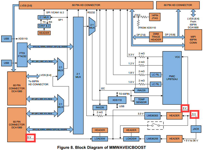

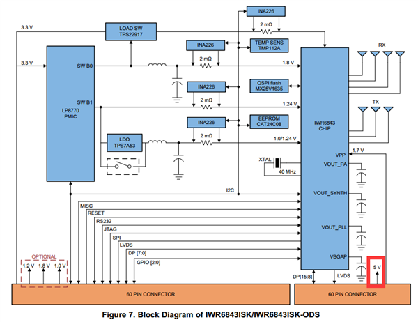

My customer have a set of IWR6843ISK+MMWAVEICBOOST, now  they want to make their own IWR6843ISK board.
As you can see from the images below, although MMWAVEICBOOST leaves  a 5V PIN through the 60 pin HD connector,but the 5V voltage of MMWAVEICBOOST  is only used by itself and  IWR6843ISK don't use the 5V voltage.
So they want to supply IWR6843ISK with 5V voltage separately without using the 5V of MMWAVEICBOOST,is this OK?
