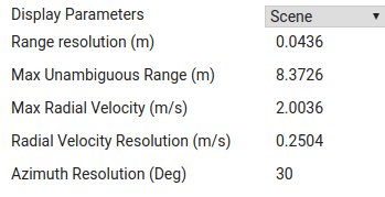

I was confirming the maximum velocity and velocity resolution values that the oob demo gui reports.  I am confused for the values reported for the 4rx/2tx and 4rx/1tx cases.  The expressions I believe for these values are
Maximum velocity = wl/4/t_c
Velocity resolution = wl/2/t_f
where
wl is the wavelength ~.3/77 = .003896 meters
t_c chirp cycle time .973 ms
t_f chirp frame time t_c*32 for the 4rx/2tx case and t_c*16 for the 4rx/2tx case

Using this information, I get
                                               4rx/2tx                   4rx/1tx
Maximum velocity (m/s)        1                              1
Velocity resolution (m/s)   .0625                       .125
Chirps per frame                    32                            16  (obtained from dataPathObj->numChirpsPerFrame)
The gui provides the values in the attached images.
Can you please explain the discrepancy?  Thank you.
Al
4rx/2tx
4rx/1tx
