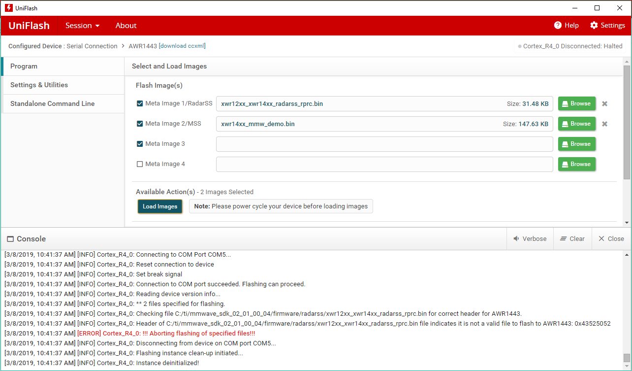

We have been trying to use SDK 2.1.0.4 and while flashing the binary images, we see the following error.
Moreover, we would like to use continuous transmission working and we have been following this thread
But we do not see the script "xwr14xx_capture_demo_mss.bin" in SDK 2.1.0.4. Can you tell us how can we enable CW transmission with SDK 2.1.0.4?
Uniflash logs:
[3/5/2019, 2:17:18 PM] [INFO] Cortex_R4_0: Initialization complete.
[3/5/2019, 2:17:18 PM] [INFO] Cortex_R4_0: Connecting to COM Port COM5...
[3/5/2019, 2:17:18 PM] [INFO] Cortex_R4_0: Reset connection to device
[3/5/2019, 2:17:18 PM] [INFO] Cortex_R4_0: Set break signal
[3/5/2019, 2:17:38 PM] [ERROR] Cortex_R4_0: Initial response from the device was not received. Please power cycle device before re-flashing.
[3/5/2019, 2:17:38 PM] [ERROR] Cortex_R4_0: Not able to connect to serial port. Recheck the COM port selected.
[3/5/2019, 2:17:38 PM] [INFO] Cortex_R4_0: Flashing instance clean-up initiated...
[3/5/2019, 2:17:38 PM] [INFO] Cortex_R4_0: Instance deinitialized!
[3/5/2019, 2:17:52 PM] [INFO] Cortex_R4_0: Initialization complete.
[3/5/2019, 2:17:52 PM] [INFO] Cortex_R4_0: Connecting to COM Port COM5...
[3/5/2019, 2:17:52 PM] [INFO] Cortex_R4_0: Reset connection to device
[3/5/2019, 2:17:52 PM] [INFO] Cortex_R4_0: Set break signal
[3/5/2019, 2:17:52 PM] [INFO] Cortex_R4_0: Connection to COM port succeeded. Flashing can proceed.
[3/5/2019, 2:17:52 PM] [INFO] Cortex_R4_0: FORMAT Command: Initiating erase operation of SFLASH storage area.
[3/5/2019, 2:17:52 PM] [INFO] Cortex_R4_0: -->Erasing storage [SFLASH]
[3/5/2019, 2:17:52 PM] [INFO] Cortex_R4_0: -->Sending Erase command to device...
[3/5/2019, 2:18:06 PM] [SUCCESS] Cortex_R4_0: -->Erase storage completed successfully!
[3/5/2019, 2:18:06 PM] [INFO] Cortex_R4_0: Disconnecting from device on COM port COM5...
[3/5/2019, 2:18:06 PM] [INFO] Cortex_R4_0: Flashing instance clean-up initiated...
[3/5/2019, 2:18:06 PM] [INFO] Cortex_R4_0: Instance deinitialized!
[3/5/2019, 2:18:27 PM] [INFO] Cortex_R4_0: Initialization complete.
[3/5/2019, 2:18:27 PM] [INFO] Cortex_R4_0: Flashing process starting...
[3/5/2019, 2:18:27 PM] [INFO] Cortex_R4_0: Connecting to COM Port COM5...
[3/5/2019, 2:18:27 PM] [INFO] Cortex_R4_0: Reset connection to device
[3/5/2019, 2:18:27 PM] [INFO] Cortex_R4_0: Set break signal
[3/5/2019, 2:18:47 PM] [ERROR] Cortex_R4_0: Initial response from the device was not received. Please power cycle device before re-flashing.
[3/5/2019, 2:18:47 PM] [ERROR] Cortex_R4_0: Not able to connect to serial port. Recheck COM port selected and/or permissions.
[3/5/2019, 2:18:47 PM] [INFO] Cortex_R4_0: Flashing instance clean-up initiated...
[3/5/2019, 2:18:47 PM] [INFO] Cortex_R4_0: Instance deinitialized!
[3/5/2019, 2:19:30 PM] [INFO] Cortex_R4_0: Initialization complete.
[3/5/2019, 2:19:30 PM] [INFO] Cortex_R4_0: Flashing process starting...
[3/5/2019, 2:19:30 PM] [INFO] Cortex_R4_0: Connecting to COM Port COM5...
[3/5/2019, 2:19:30 PM] [INFO] Cortex_R4_0: Reset connection to device
[3/5/2019, 2:19:30 PM] [INFO] Cortex_R4_0: Set break signal
[3/5/2019, 2:19:30 PM] [INFO] Cortex_R4_0: Connection to COM port succeeded. Flashing can proceed.
[3/5/2019, 2:19:30 PM] [INFO] Cortex_R4_0: Reading device version info...
[3/5/2019, 2:19:30 PM] [INFO] Cortex_R4_0: ** 2 files specified for flashing.
[3/5/2019, 2:19:30 PM] [INFO] Cortex_R4_0: Checking file C:/ti/mmwave_sdk_02_01_00_04/packages/ti/demo/xwr14xx/mmw/xwr14xx_mmw_demo.bin for correct header for AWR1443.
[3/5/2019, 2:19:30 PM] [INFO] Cortex_R4_0: AWR1443 device, fileType=META_IMAGE2 detected -> OK
[3/5/2019, 2:19:30 PM] [INFO] Cortex_R4_0: Checking file C:/ti/mmwave_sdk_02_01_00_04/firmware/radarss/xwr12xx_xwr14xx_radarss_rprc.bin for correct header for AWR1443.
[3/5/2019, 2:19:30 PM] [INFO] Cortex_R4_0: Header of C:/ti/mmwave_sdk_02_01_00_04/firmware/radarss/xwr12xx_xwr14xx_radarss_rprc.bin file indicates it is not a valid file to flash to AWR1443: 0x43525052
[3/5/2019, 2:19:30 PM] [ERROR] Cortex_R4_0: !!! Aborting flashing of specified files!!!
[3/5/2019, 2:19:30 PM] [INFO] Cortex_R4_0: Disconnecting from device on COM port COM5...
[3/5/2019, 2:19:30 PM] [INFO] Cortex_R4_0: Flashing instance clean-up initiated...
[3/5/2019, 2:19:30 PM] [INFO] Cortex_R4_0: Instance deinitialized!

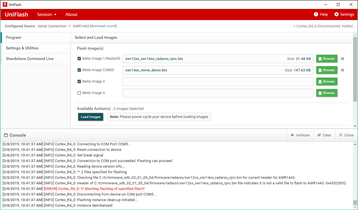

  • Satyajeet,
    Please keep in mind that SDK v2.1 is designed for AWR1443 ES 3.0 devices. This is detailed in the release notes. If were able to successfully flash your device and run applications with earlier versions of the SDK, this would mean that you likely have an AWR1443 ES 2.0 device. Given that this is the likely scenario, you will not be able to use an AWR1443 ES 2.0 device with SDK v2.1.
    You can either obtain an AWR1443 ES 3.0 device so that you can work with SDK v2.1 or continue to use an earlier SDK release.
    Kyle

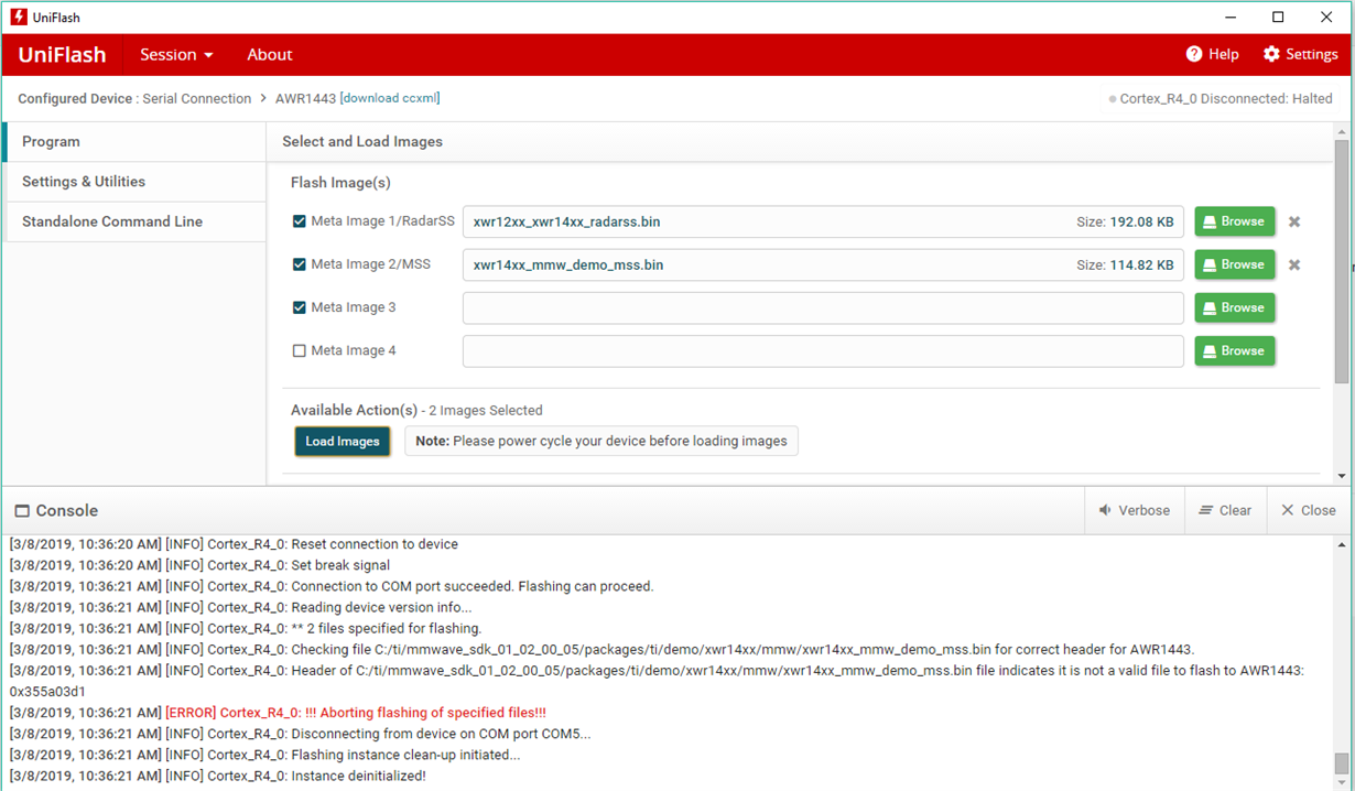

  • Hi Cesar,
    We tried SDK 1.2.0.5 and this is supposed to work with AWR1443 ES2.0 as mentioned in the release notes. Please check the error logs we are seeing while flashing the binaries.

  • Satyajeet,
    Please make sure that when you are flashing the BSS and MSS images to your AWR1443 using Uniflash, the BSS image is the first entry in Uniflash and then the MSS image is the second entry. It looks like you are attempting to flash the MSS image first, which would not be the correct order.
    Kyle
  • Thanks Kyle,
    We will double check this.Can you comment on how can we find out which version of silicon do we have?
  • Hi Kyle,
    See attached the Uniflash configuration where we have BSS as the first entry and MSS as the second entry. Still the uniflash tool throws an error.
    We have tried with both SDKs 1.2.0.5 (supposed to work with 1443 ES2.0) and 2.1.0.4 (supposed to work with 1443 ES3.0). Please suggest the next steps so that we can use TI board.

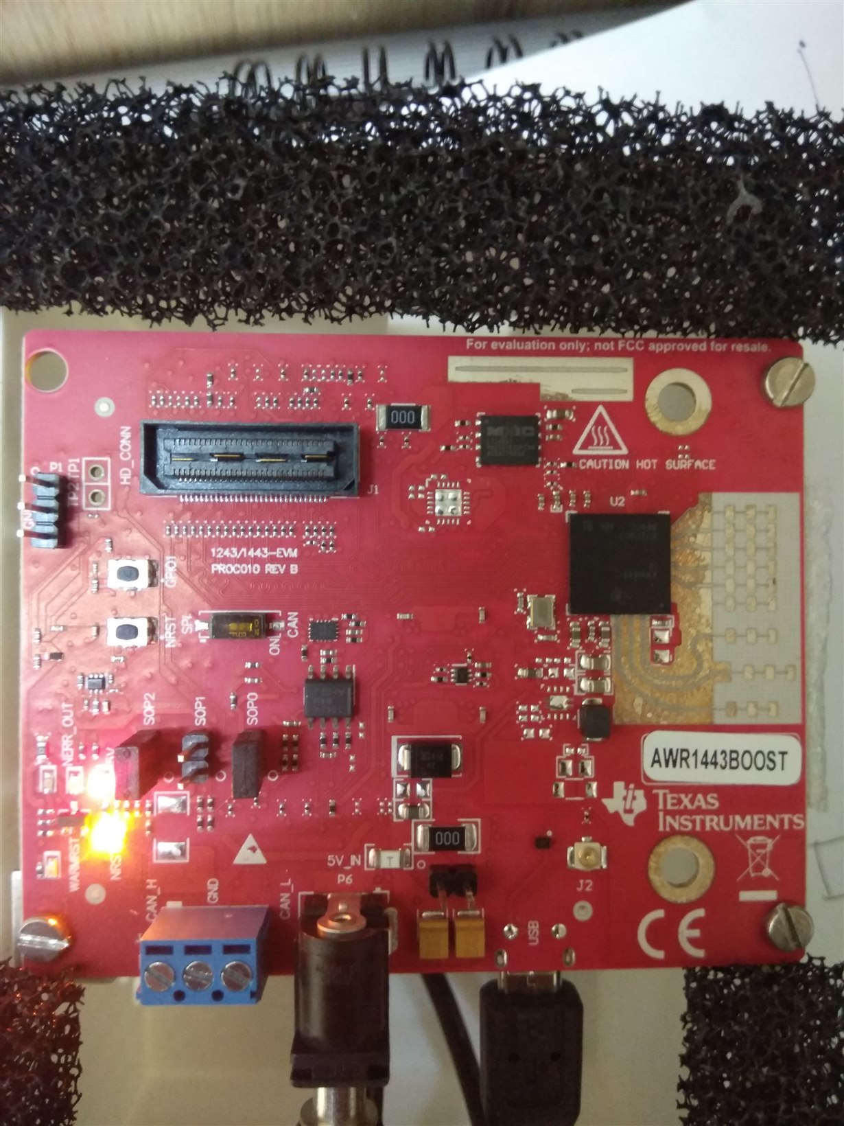

    We had purchased the TI AWR 1443 board in Nov-Dec 2018. Can you suggest how can we identify the ES version we have? I am also attaching a picture of our board in case you want to see it.
  • Satyajeet,
    Based on the image that you have provided, we can determine that you have an AWR1443 ES 3.0 device. You can determine this from the device errata found here: www.ti.com/.../swrz075c.pdf
    From this, you should use SDK 2.1 or later.

  • Satyajeet,
    Starting in SDK v2.1, you only need to flash the xwr14xx_mmw_demo.bin image to your device. This is metaimage that includes the MSS and BSS images into a single binary file. So only specify the xwr14xx_mmw_demo.bin file as the first and only entry in Uniflash. This should successfully resolve your issue.
    Kyle

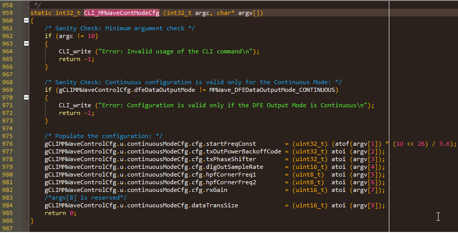

  • Kyle,
    It took me some time for me to figure out that you are referring to Table 1 in SDK user guide document. Anyways, thanks.
    I do not see any mention of contModeCfg in the table that you have mentioned.
    I am sure you would agree that to put the device in continuous transmission (fixed frequency at say 77 GHz) mode, we do not need chirpCfg, frameCfg. But these commands have been mentioned as mandatory in the table that you have referred to.
    There is a command called contModeCfg which is hooked to the CLI_MMWaveContModeCfg handler but the error check indicates that if DFE output mode is not CONTINUOUS then this command would not work. Please see the code snippet below.
    Table 1 in SDK user guide says that in 1443, dfeDataOutputMode only frame based chirps (i.e. only option 1) is supported in 1443.
    Do we need to modify the application? If yes, please send us the instructions to do so.
    Can you help us with the minimum set of commands to put the device in continuous transmission mode?
