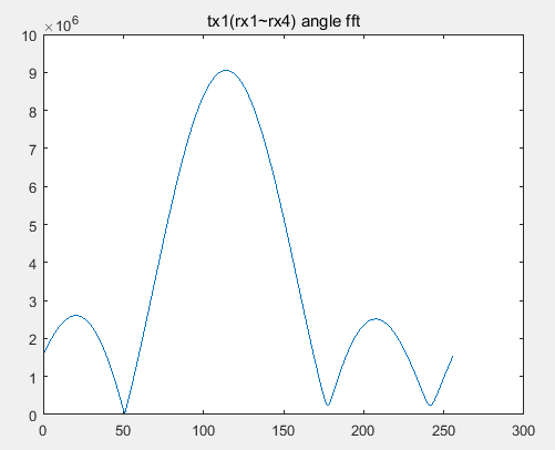

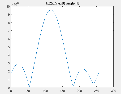

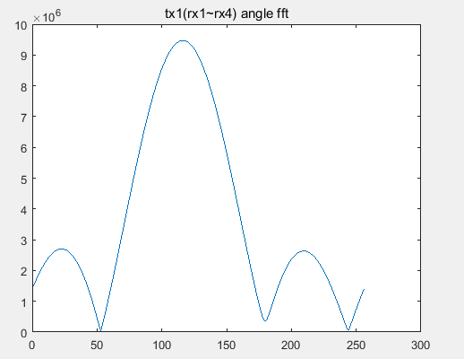

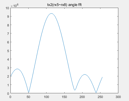

      my test data below:
    1.reflector at 8 degree:
    phase value:
    |rx(1):-1.2071|rx(2):-1.4856|rx(3):-1.7811|rx(4):-2.1569|rx(5):0.1620|rx(6):-0.2140|rx(7):-0.3995|rx(8):-0.8121
    2.reflector at 9 degree:
      phase value:|rx(1):3.0557|rx(2):2.7138|rx(3):2.3660|rx(4):1.9513|rx(5):-1.7020|rx(6):-2.1254|rx(7):-2.3571|rx(8):-2.8637

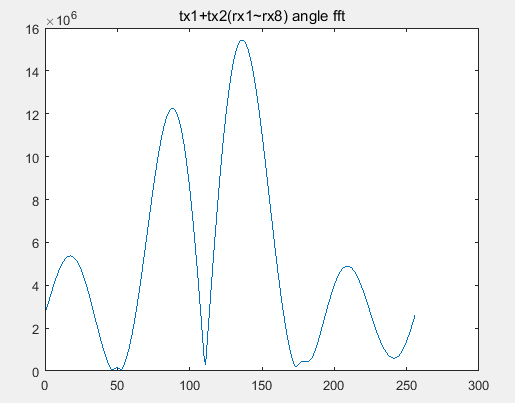

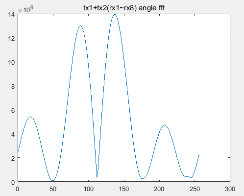

      when we use r1~r4 or r5~r8 angle fft separately,the dbf can give right and the same peak. but when we combine the two sets for 8 rx angle fft
      the dbf goes wrong. so it's not caused by the rx channel phase diff.
      Also, we can see the two sets phase difference is changed when the reflector from 8 degree to 9 degree.So we guess phase mismatch between two
      TXs due to board routing can not explain this phenomenon. beacuse the phase diff is not stastic.

    Based on your complex data.  I did some calibration based on the first set of data (8 degree), and then used it for your second set of data (9 degree).  The code is listed at the end. And here is the result after compensation.  So, the peak is located at 6 degree for both 8 degree and 9 degree cases.   So, it is not perfect different by 1 degree.  But I would say phase estimation error at several degrees is normal.   I may also agree that a simple phase compensation between TX1 and TX2 maybe be enough, there maybe other leakages from RX1 to RX2 and etc.   But I would say if the angle estimation error is within several degrees cross angles, it is acceptable, and that is what we see as well.

      sorry for my late for response. we have found some bug in our code bring to this problem.the TXs enable sequence is inverted,so the two sets of rx is jump.but the mimo configuration is the demo code.we just exchange the TXs enable order in chirp0 and chirp1 to solve this problem.this phenomenon disappear.i think this thread shall be closed.thanks for your highly effective support.
