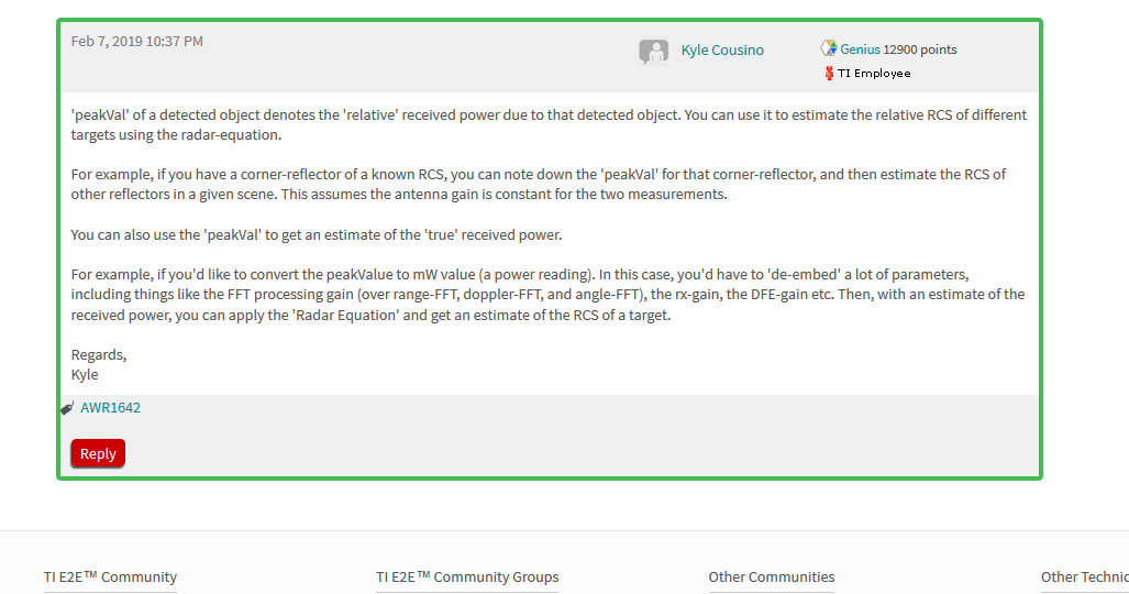

The above diagram is a snippet I obtained from another post, about RCS computation. The last paragraph ("...For example if you would like to convert the peak value......") just gives a general overview of the process. This is however vague for a newbie trying to work around on your radar hardware.
  1. Do you have a detailed tutorial / detailed how-to-do guide on the calculation of RCS of simple targets (corner reflector) including the steps to be followed when using only the AWR1642  and mmWave Demo Visualizer out of the box?
  2. The range profile plot displays as relative power vs range - can this be used in the radar range equation?
