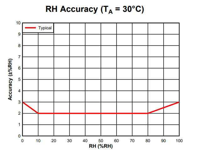

What is the  accuracy out of operating rage 20 to 80% RH?
In the datasheet, the accuracy is specified at 20 to 80% RH.  So I would like to confirm the accuracy between 0 to 20 & 80 to 100% RH.

    According to the graphs on pages 1 and 6 of the HDC2080 datasheet, the typical accuracy that should be expected from 80% to 100% RH and also from 10% to 0% RH will be ~ +/-3%.

    Customer wants more specific data, that is, raw data of HDC2080 humidity at 0 degree C and 60 degree C, so that they can estimate the min/max value as a reference.
    Could you share there data?

  • Takahashi-san,
