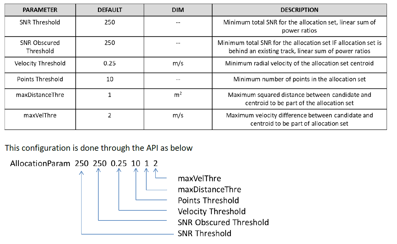

    Looking at the testing environment, I understand that there is nothing in the area that is creating the detection points you are seeing.  If the already mentioned procedure does not help, you can tune gtrack to better ignore the false points.
    You can increase the SNR threshold or the points threshold.  You can also decrease the maxDistance threshold, which will limit the size of cluster that the tracker is allowed to allocate.
    Justin
