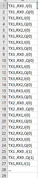

I have one question on adc data arrangement for TDM MIMO configuration. In the mmwave doxygen document, the TDM-MIMO adc data is arranged according to the transmitters , (chirp1,chirp3,chirp(N-1)) data is arranged for Tx1 first and then (chirp2,chirp4,chirp(N)) for Tx2 next. Is this order also used when capturing adc data over DCA1000EVM ? .Can I reshape the received data virtual antenna matrix in the order in which it was sent?
