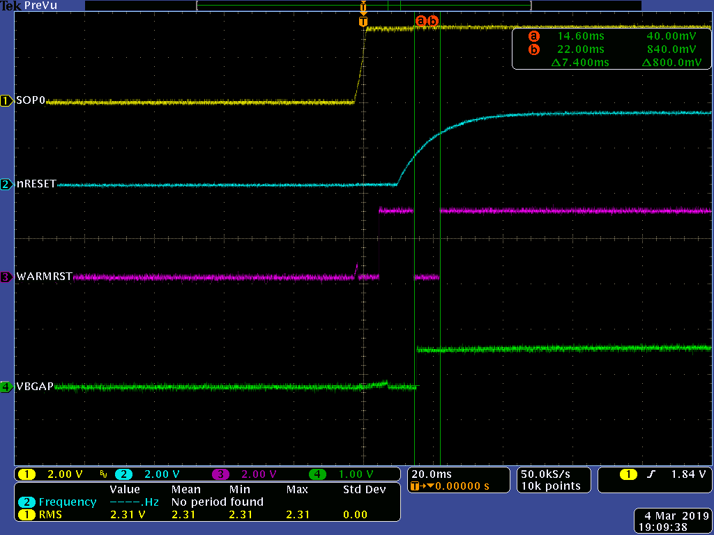

We made our IWR6843 radar board, and we got bootup problem with our boards.
there are about 50% of our IWR6843 can't boot up unless we reset again after power up.
and I found some similar behavior on IWR6843 EVM in  this thread e2e.ti.com/.../755091
is there any relevance between them?
and I found another way to boot up these board, if I heat up the IWR6843 to about 40~50℃ before power up,
it can boot up normally, what reason may make this behavior?
