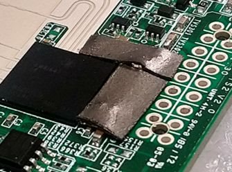

 We sent IWR1642 PCB and also IWR1642BOOST (for comparison) to TUV (certification lab) for EMI test.

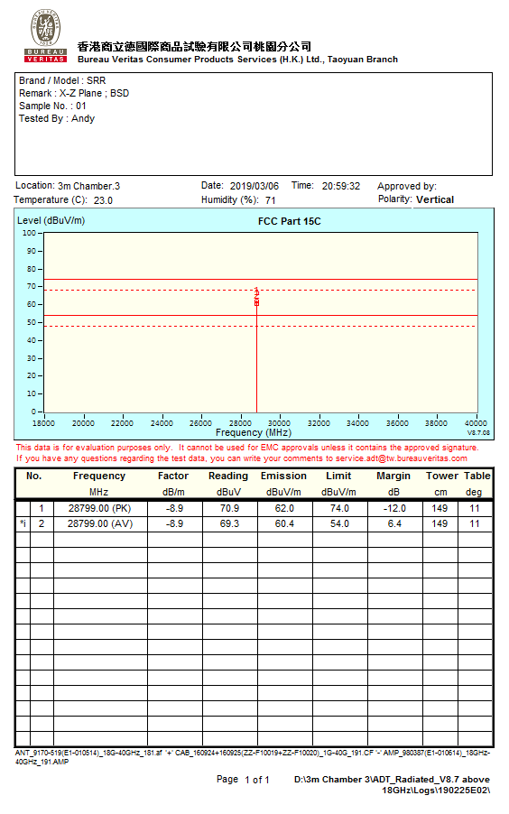

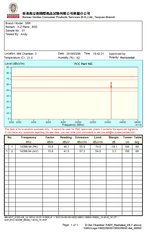

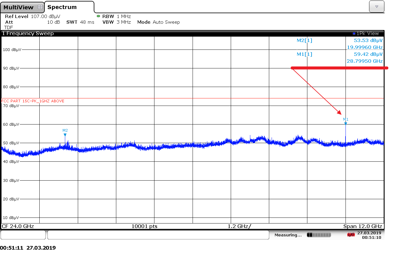

 We found there are 2 spurious over the NCC (Taiwan radio regulation standard) requirement. The spurious emission are 14.4GHz and 28.8GHz (please see attach 2 pictures) both failing the average standard of 54.0 dBuV/m for about 3~6 dB.
 We tried to adjust the TX power level or turn off TX, but the emission still existed. We also tried to stick the absorber on top of the IWR1642 but didn't help.
 These 2 frequencies are in harmonic and 2 questions:
 1). What can be the source of such 14.4GHz from IWR1642?
 2). Any suggestion to reduce the harmonic spurious?
