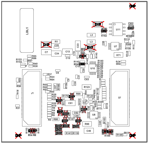

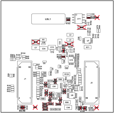

When reviewing the board design files of IWR6843ISK, Carrier Board (MMWAVEICBOOST) and IWR6843-ODS, 60-pin HD connectors show difference direction.
[1] IWR6843ISK
[2] MMWAVEICBOOST
[3] IWR6843ISK-ODS
With real EVM board, we can know that the latest IWR6843ISK-ODS design file shows the right direction.

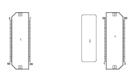

When looking at the silk print of MMWAVEICBOOST board, it seems that the direction of connector (J17) is opposite, is it right?
So, can you confirm the silk print of HD connectors (J17 and J4) of MMWAVEICBOOST?
Can you also confirm about the HD connectors direction of layout design data of IWR6843ISK and MMWAVEICBOOST?
