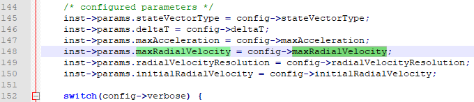

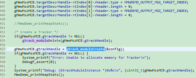

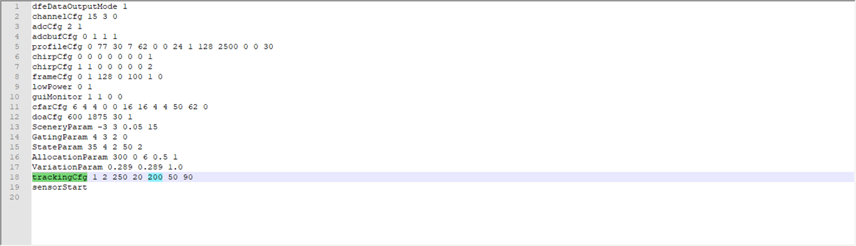

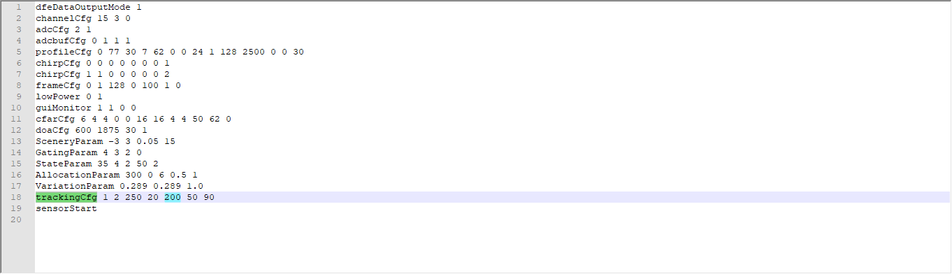

    I am working on the people counting demo.And I found that the MmwDemo_CLITrackingCfg function  in task_app.c(pplcount_16xx_mss) we assign values to variables according to cfg.
    The '200'(blue) represents the maximun unambiguous radial velocity.Then still in the MmwDemo_CLITrackingCfg function,we execute the gtrack_moduleCreate(&config) which assigns maxRadialVelocity to a GtrackModuleInstance (we define GtrackModuleInstance *inst) according to GTRACK Algorithm's code.That is mean when we execute the unroll RadialVelocity we may +/- 20(200*0.1)m/s.Is it right?

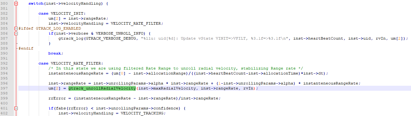

    Another question is, when we execute the gtrack_unitUpdate function where we also consider to unroll RadialVelocity, In the 'VELOCITY_RATE_FILTER' state we are using filtered Rate Range to unroll radial velocity stabilizing Range rate.On,what is range rate?Why should we do taht?I got confused.Could you please give me more help or helpful information?
    Hanna
  • Hi Hanna,
    The max unambiguous radial velocity is not the limit that we can unroll too. The limit is 3 times the max unambiguous radial velocity. So we can unroll up to 3x, in this case 60 m/s.
    The range rate is rate of change of the range of the tracked cluster of points. It is a velocity measurement made by comparing the position of the tracked cluster frame to frame. We then use this to essentially sanity check the unrolling of the radial velocity - allowing us to unroll the right amount to get the velocity of the points close to the velocity of the tracked object.

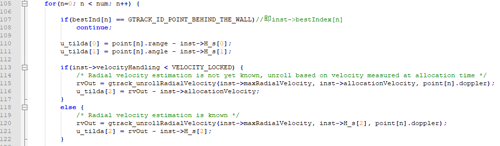

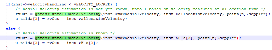

  • Hi Justin,
    In this case the variable 'inst->maxRadialVelocity' is 20(200*0.1)m/s.The following code is from gtrack_unitScore function.
    If 'Radial velocity estimation is known', inst->H_s[2](Radial velocity estimation or a track's expected measurment velocity) is larger than point[n].doppler(a point's velocity).Then the gtrack_unrollRadialVelocity function adds inst->maxRadialVelocity(20m/s) to inst->H_s[2].What I am worried about is that in that way the gap between inst->H_s[2] and point[n].doppler is wider and wider.By the way, I don't think it is a proper velocity for people. Please just tell me if I make some mistakes on understanding the score algorithm.

  • Hi Hanna,
    The scoring function computes Mahalanobis distance based on the u_tilda vector, which is 3 floats representing the distance between the point and the tracked object in range, angle, and velocity/doppler. (Mahalanobis distance is essentially a measure of distance in standard deviations)
    The unroll function returns rvOut, which is the new estimate of radial velocity. This estimate is essentially:
    1. rvExp – rvIn >= 0, then rvOut = rvExp + rvMax
    2. rvExp – rvIn < 0, then rvOut = rvExp – rvMax
    This works within a larger context - in some labs, the DSP runs a max velocity extension function on the points in the point cloud before they are fed to the tracker. Occasionally, this function is wrong - the gtrack_unrollRadialVeloctiyFunction is supposed to correct those errors. If there is an error, after unrollRadialVelocity, then that point may fall within the range of the track, and be associated.

    Thank you for your reply.However what you said is what I have known.My question is following three:
    1.As the picture I post before, is 20m/s assigned to inst->maxRadialVelocity?Or is  maxRadialVelocity's value equal to maxURadialVelocity's?
    2.If they are equal,inst->maxRadialVelocity(20m/s) is apply to work with rvExp and finally returns rvOut.In the case of considering objective like human's velocity,the value(20m/s) is obviouslly wrong.Doesn't right?

  • Hi Hanna,
    1. 20m/s is assigned to inst->maxRadialVelocity.
    2. You may be able to turn down max velocity to the range of 5- 10 (50 - 100) to improve your results.
    3. In the signal chain, the velocity of points will be unrolled. This process is not always correct. By having gtrack unroll the radial velocity, we can try to correct these errors. This works because gtrack knows the velocity of the tracked object, so it can take a guess at what the true velocity of the point is with more accuracy than the signal chain can.

  • Hi Justin,
    I have read all the information you provided.I need to explain what I have done.I have used lab0011-pplcount and modified the MATLAB code to collect data of point cloud in successive frames.Then I selected one frame of data.The target is displayed on the MATLAB graph associated with the data.With the data of that frame, I simulated the process of allocation.For a bunch of points,we use the leading point’s radial velocity Vr, i=0 to unroll the velocity of the other points in the allocation set.
    In the relevant configuration file, mmw_pplcount_demo_default.cfg,we define allocation parameters 450 0.01 25 1 2.That means maxVelThre—Maximum velocity difference between candidate and centroid to be part of the allocation ser—is 2m/s.As you said in your previous post, we can turn down max velocity to the range of 5- 10 (50 - 100) which will be assigned to inst->maxRadialVelocity.In my case, 5m/s is assigned to inst->maxRadialVelocity.
    Now, in the function of gtrack_moduleAllocate, we have a leading point and use gtrack_unrollRadialVelocity function to unroll the velocity of the other points.For instance,No.6 point is the leading point.Then we look at the No.7 point.Both of them meet the requirements of  becoming a new track theoretically.In the detail of execution of gtrack_unrollRadialVelocity function,the leading point's velocity is larger than No.7 point's. Then un(2)—is the No.6 point's velocity in this step—will plus inst->params.maxRadialVelocity(5m/s).In the next step , fabs(uk[2] - un[2]) < inst->params.allocationParams.maxVelThre(2m/s).
    At that time uk(2) and un(2) are in fact the velocity of No.6 point's velocity and the unrolling of No.6 point's velocity.
    uk(2)=un(2)+inst->params.maxRadialVelocity=No.6 point's velocity+5m/s.
    fabs(uk[2] - un[2])=No.6 point's velocity+5m/s-No.6 point's velocity=5m/s> inst->params.allocationParams.maxVelThre(2m/s).Therefore,we can not include the No.7 point into allocation.Worsely,the other points will meet the same situation.In the end ,my simulation didn't form any track.Is there anything wrong?

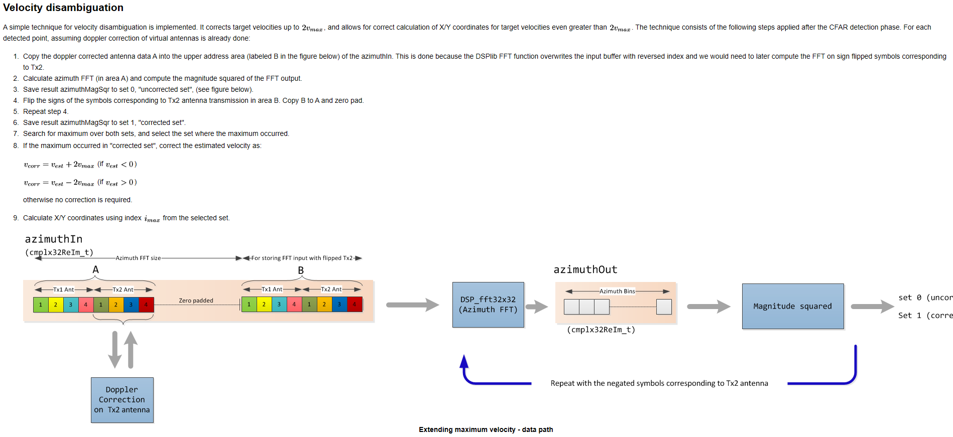

    what you explain about the detection layer's work is described in velocity disambiguation?
    Hanna
  • Hanna,
    Not exactly. In principle, there are many ways detection layer can be implemented. I don't know about your case, but most likely the is no velocity disambiguation going on; the detection layer is delivering the radial velocity as is. The unrolling occurs post detection, in tracker. Which makes sense in many use cases.
