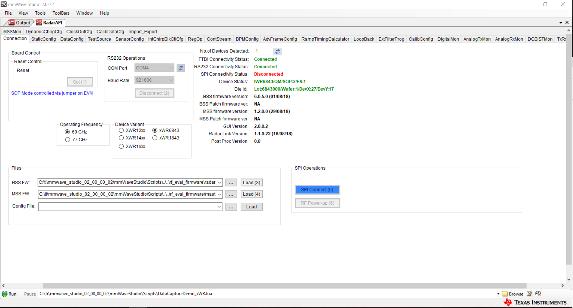

I am trying to get started with raw data capture using DCA1000+IWR6843.
I cannot find a quick start for the 6843, so I followed thee quick guide and hoped for it to work.
 In mmWave studio, I get the output.
GM: Constructor
GM: Mon Mar 11 14:17:53 2019
RSTD.Transmit("/Settings")
[14:17:53]
[14:17:53] ### Running Startup script: "C:\ti\mmwave_studio_02_00_00_02\mmWaveStudio\Scripts\Startup.lua" ###
[14:17:53] RSTD.SetAndTransmit ("/Settings/Scripter/Display DateTime" , "1")
[14:17:53] RSTD.SetAndTransmit ("/Settings/Scripter/DateTime Format" , "HH:mm:ss")
[14:17:53] Scripter ignored: Attempt to UnBuild() again or before Build.
[14:17:53] RSTD.SetVar ("/Settings/Clients/Client 0/Dll" , "C:\\ti\\mmwave_studio_02_00_00_02\\mmWaveStudio\\Clients\\\\LabClient.dll")
[14:17:53] RSTD.SetVar ("/Settings/Clients/Client 0/Use" , "TRUE")
[14:17:53] RSTD.SetVar ("/Settings/Clients/Client 1/Use" , "FALSE")
[14:17:53] RSTD.SetVar ("/Settings/Clients/Client 2/Use" , "FALSE")
[14:17:53] RSTD.SetVar ("/Settings/Clients/Client 3/Use" , "FALSE")
[14:17:53] RSTD.SetVar ("/Settings/Clients/Client 4/Use" , "FALSE")
[14:17:53] RSTD.SetVar ("/Settings/AL Client/AL Dll" , "C:\\ti\\mmwave_studio_02_00_00_02\\mmWaveStudio\\RunTime\\SAL.dll")
[14:17:53] RSTD.SetVar ("/Settings/Clients/Client 0/GuiDll" , "")
[14:17:53] RSTD.SetVar ("/Settings/AutoUpdate/Enabled" , "TRUE")
[14:17:53] RSTD.SetVar ("/Settings/AutoUpdate/Interval" , "1")
[14:17:53] RSTD.SetVar ("/Settings/Monitors/UpdateDisplay" , "TRUE")
[14:17:53] RSTD.SetVar ("/Settings/Monitors/OneClickStart" , "TRUE")
[14:17:53] RSTD.SetVar ("/Settings/Automation/Automation Mode" , "false")
[14:17:53] RSTD.Transmit("/")
[14:17:53] RSTD.SaveSettings(): Settings saved to "C:\Users\H868873\AppData\Roaming\RSTD\config.xml"
[14:17:53] RSTD.Build()
[14:17:53] RSTD.AL_Build()
[14:17:53] RSTD.AL_LoadXml()
[14:17:53] RSTD.AL_Init()
[14:17:53] RSTD.Clients_Build()
[14:17:53] GM: Init
[14:17:53] GM: Loaded 'C:\ti\mmwave_studio_02_00_00_02\mmWaveStudio\Clients\\LabClient.dll'
[14:17:53] GM: 1 Guest (s) init
[14:17:53] GM: 1 Module(s) init
[14:17:53] GM: 2 Tab (s) init
[14:17:53] RSTD.Client_LoadXml()
[14:17:53] [RadarAPI]: Starting Matlab Engine..
[14:17:56] [RadarAPI]: Matlab Engine Started!
[14:17:59] [RadarAPI]: ar1.LoadSettings('C:\Users\H868873\AppData\Roaming\RSTD\ar1gui.ini')
[14:17:59] [RadarAPI]: Error: Index was outside the bounds of the array.
[14:17:59] Trace:
[14:17:59] at AR1xController.ScriptOps.getMatlabPostProcVersion()
[14:17:59] TESTING = false
[14:17:59]
[14:17:59] ***Script completed successfully.***
[14:18:01] [RadarAPI]: Opening Gpio Control Port()
[14:18:01] [RadarAPI]: Status: Passed
[14:18:02] [RadarAPI]: Opening Board Control Port()
[14:18:02] [RadarAPI]: Status: Passed
[14:18:03] [RadarAPI]: ar1.FullReset()
[14:18:03] [RadarAPI]: Status: Passed
[14:18:03] [RadarAPI]: Closing Board Control Port()
[14:18:03] [RadarAPI]: Closing Gpio Control Port()
[14:18:03] [RadarAPI]: ar1.SOPControl(2)
[14:18:04] [RadarAPI]: ar1.Connect(4,921600,1000)
[14:18:06] [RadarAPI]: Warning: Connected with baudrate 115200
[14:18:07] [RadarAPI]: Warning: Disconnected existing BaudRate
[14:18:08] [RadarAPI]: Warning: Trying to connect with baudrate 921600
[14:18:09] [RadarAPI]: ar1.Calling_IsConnected()
[14:18:10] [RadarAPI]: ar1.SelectChipVersion("IWR6843")
[14:18:10] [RadarAPI]: Status: Passed
[14:18:10] [RadarAPI]: RS232 is not connected ..!!!!
[14:18:10] [RadarAPI]: ar1.frequencyBandSelection("60G")
[14:18:10] Device Status : IWR6843/QM/SOP:2/ES:1
[14:18:11] [RadarAPI]: ar1.SelectChipVersion("IWR6843")
[14:18:11] [RadarAPI]: Status: Passed
[14:18:12] Device Status : IWR6843/QM/SOP:2/ES:1
[14:18:12] [RadarAPI]: ar1.SaveSettings('C:\Users\H868873\AppData\Roaming\RSTD\ar1gui.ini')
[14:18:22] [RadarAPI]: ar1.DownloadBSSFw("C:\\ti\\mmwave_studio_02_00_00_02\\mmWaveStudio\\Scripts\\..\\..\\rf_eval_firmware\\radarss\\xwr68xx_radarss.bin")
[14:18:23] [RadarAPI]: Downloading BSS ROM RPRC Binary..
[14:18:29] [RadarAPI]: ar1.GetBSSFwVersion()
[14:18:29] [RadarAPI]: BSSFwVersion:(06.00.05.00 (01/08/18))
[14:18:32] [RadarAPI]: ar1.DownloadMSSFw("C:\\ti\\mmwave_studio_02_00_00_02\\mmWaveStudio\\Scripts\\..\\..\\rf_eval_firmware\\masterss\\xwr68xx_masterss.bin")
[14:18:32] [RadarAPI]: Downloading MSS RPRC Binary..
Note the Error form matlab index out of bounds.
I continue with reset Control, RS232 Operations, Load (3), Load (4).On the fifth step SPI connect, nothing happens.
The radar is connected

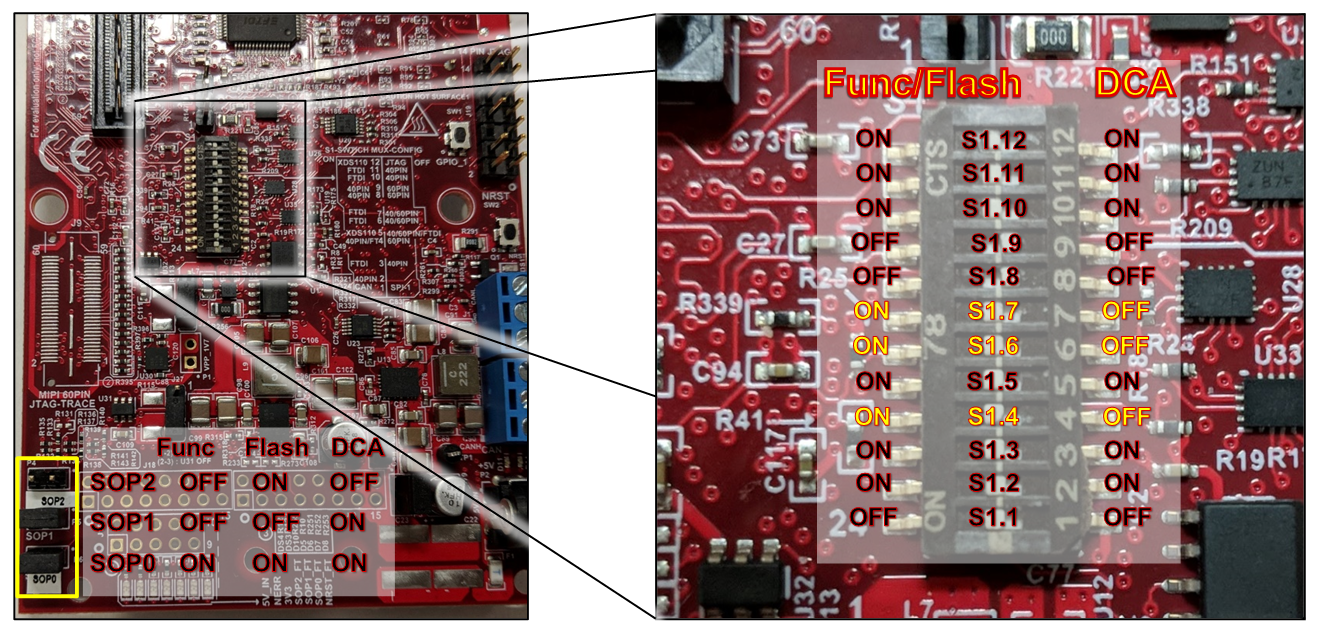

I have close SOP0 and SOP1 but not SOP2!

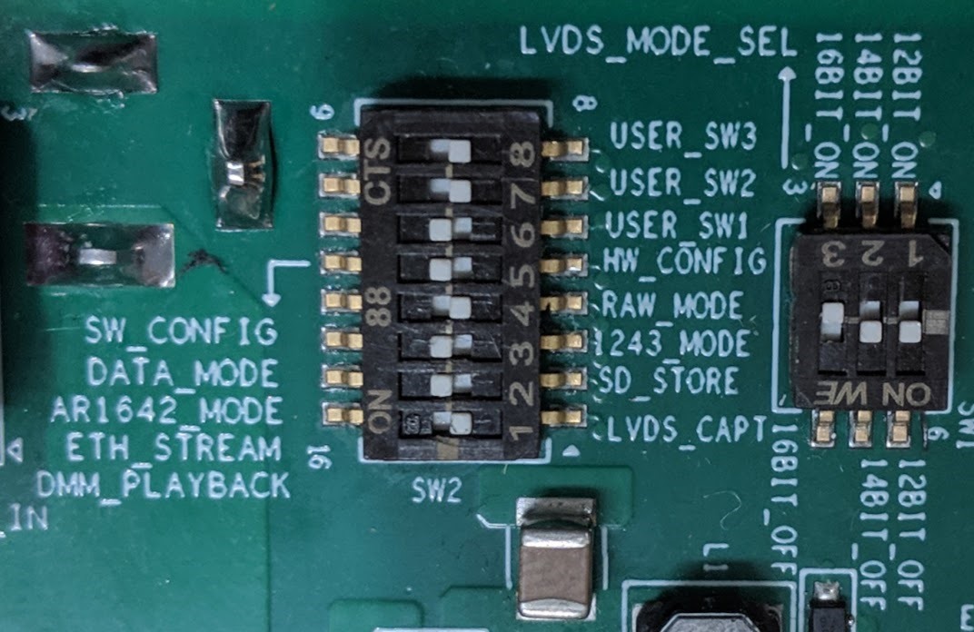

  • Amir,
    Change the carrier mux's to the image attached below.
    on the DCA1000 board:
    I think that this should resolved your issue.
    Alex

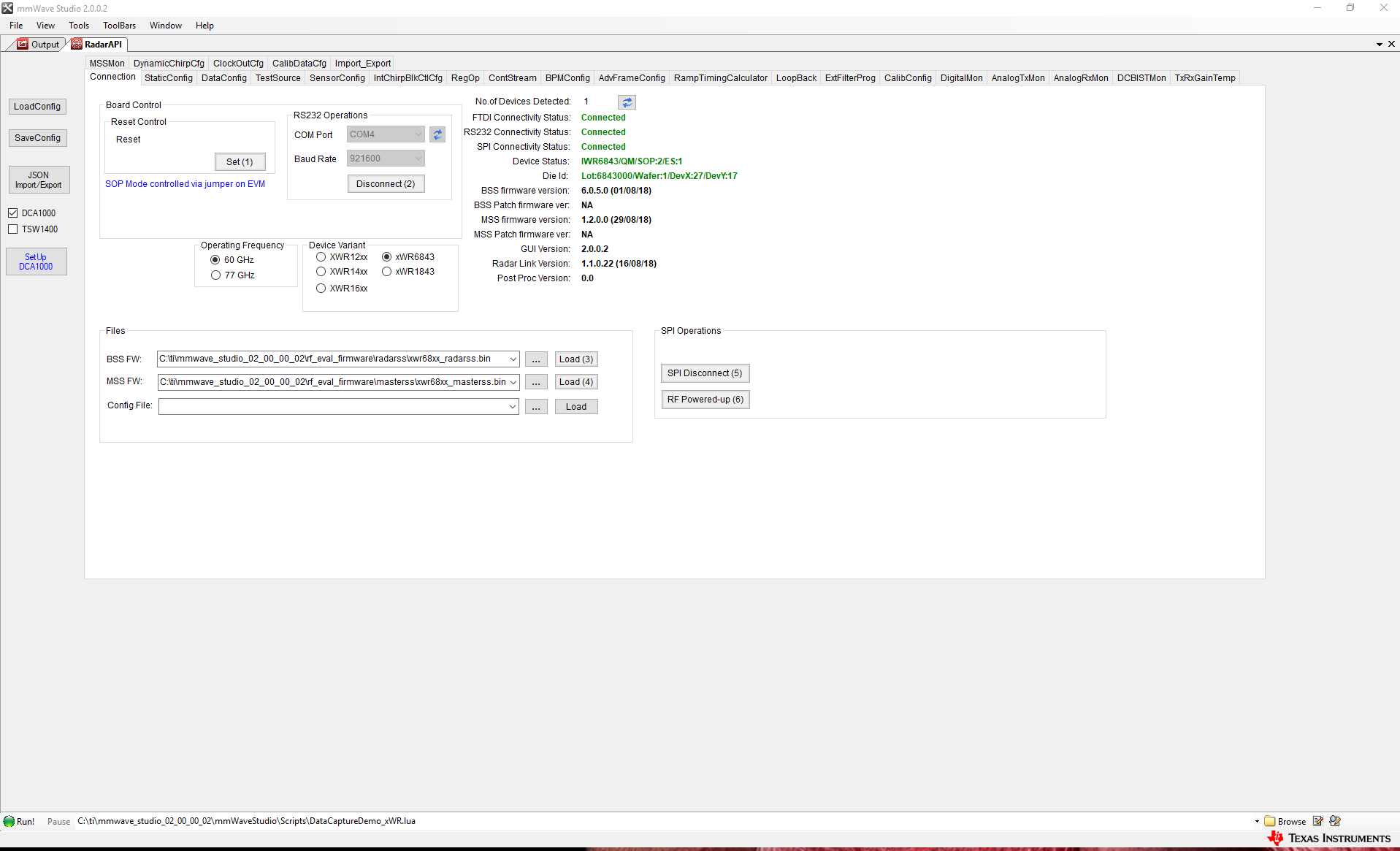

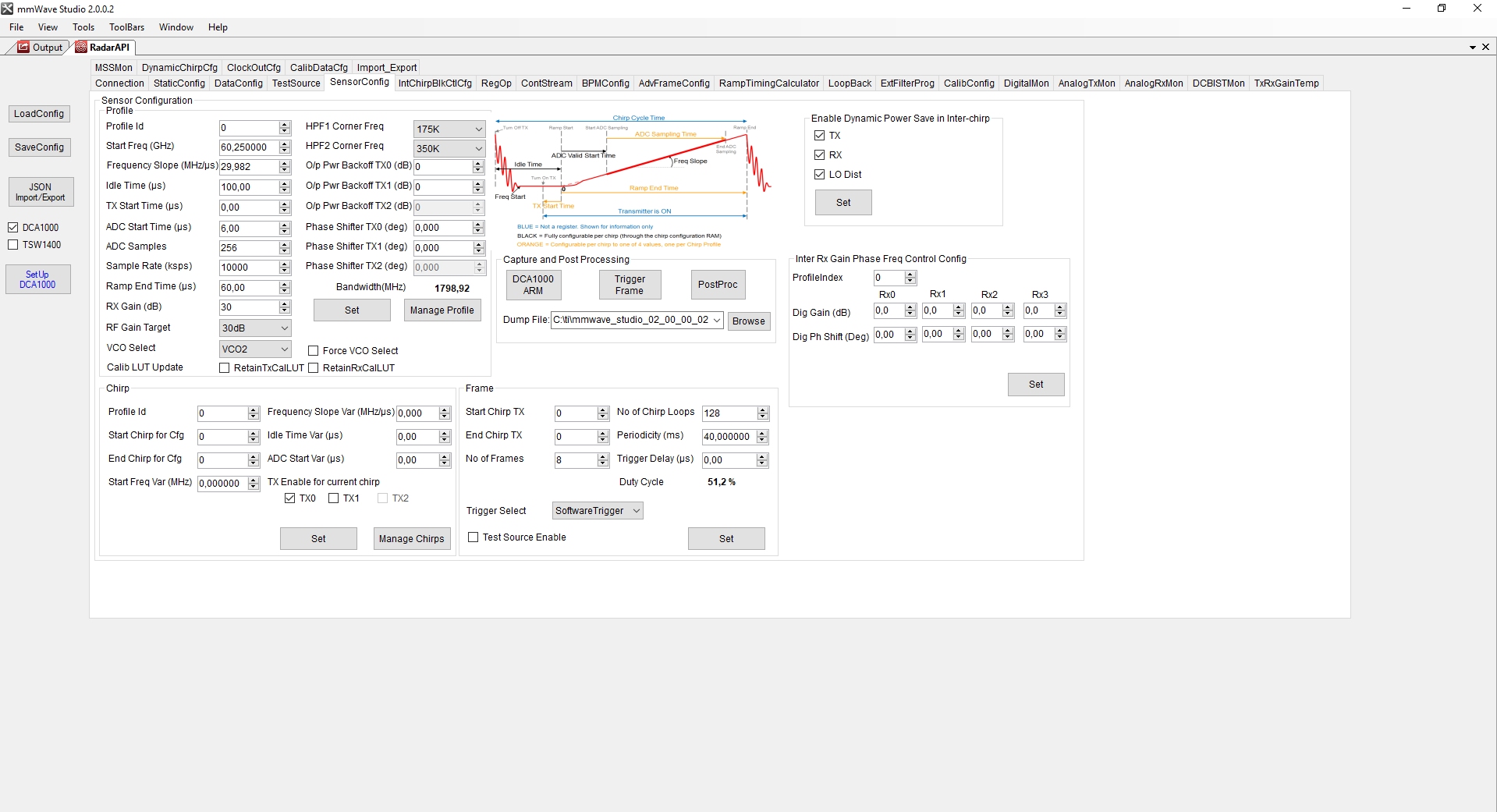

  •  Thanks it did the trick. I still cannot capture data. We are almost there I think.
    It detects everything. I press "all blue buttons" in the order Radar studio highlights in all tabs (StaticConfig, DataConfig ...SensorConfig). Then I press DCA1000, Trigger frame and postProcess. But once I press trigger frame, it does not record anything. the .bin file is indeed empty. So the post-process does not work.
