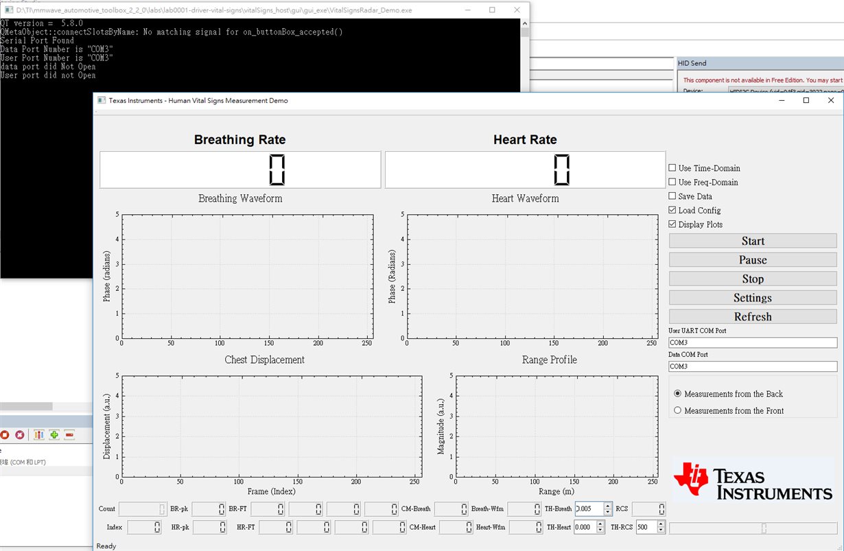

      I'm trying to run the lab0001-driver-vital-signs and load the original pre-built bin file successed.
But when I excute the GUI VitalSignsRadar_Demo.exe , it show  error as below picture.
The wafer revision is IWR1642 ES1.0 , I had tried two different toolbox revision  "mmwave_automotive_toolbox_1_2_0" and "mmwave_automotive_toolbox_2_2_0"
and both two have the same isssue.I think the hardware is good ,because I can run the people count lab. Could you help me to figure out what is wrong

    As you have mentioned that GUI application is not able to auto detect the COM ports as I assume it looks for XDS110 USB COM ports.
    Could you check if you have installed XDS110 USB driver?
    Please follow the instruction mmWave SDK user guide (section: How to identify the COM ports for xWR14xx/xWR16xx EVM) to properly install the USB driver.
