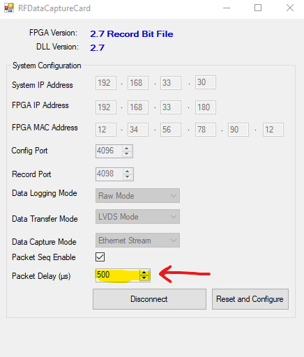

I have a newly installed window 10 operation system. The IWR1443EVM is connected to DCA1000EVM, and they are both connected to be PC.
I can successfully configure the radar front end and DCA1000EVM and capture the raw data using mmwave studio.
But in the last step, the raw data is going to be proceeded using Packet_Recorder_Zerofill.exe and it fails. The error is attached below.
By the way, I have installed MATLAB running time 2015a according to the user manual.
Thanks for your help!

  •  Weite / Alex:
    I have encountered the same problem that Weite has. My "partial" solution was that I realized that the "32-bit" Microsoft Visual C++ 2013 Redistributable package from the link should be installed, instead of the "64-bit" version. Weite: check whether you have installed the 64-bit package.
    I believe the reason is that from the package name "mmwave_studio_02_00_00_02_win32.exe", we can infer that it is a 32-bit .exe, not 64-bit.
    However, after getting over the error message that Weite has encountered, I am seeing another problem: when Packet_Recorder_Zerofill.exe executes to post-process the raw data, the command window flashes then disappears. An error is shown in the Ouput windows. Please see the output log:

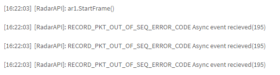

    [16:22:03]  [RadarAPI]: ar1.StartFrame()
    [16:22:03]  [RadarAPI]: RECORD_PKT_OUT_OF_SEQ_ERROR_CODE Async event recieved(195)
    [16:22:03]  [RadarAPI]: Status: Passed
    [16:22:03]  Frame start async event received!
    [16:22:04]  [RadarAPI]: RECORD_PKT_OUT_OF_SEQ_ERROR_CODE Async event recieved(195)

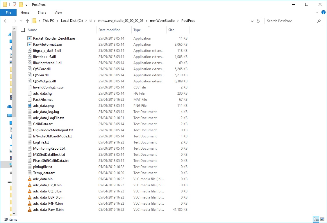

    [16:22:30]  [RadarAPI]: ar1.StartMatlabPostProc("C:\\ti\\mmwave_studio_02_00_00_02\\mmWaveStudio\\PostProc\\adc_data.bin")
    [16:22:30]  [RadarAPI]: Error:
    [16:22:30]
    [16:22:30]  ... MWMCR::EvaluateFunction error ...
    [16:22:30]  05-Apr-2019 16:22:30: The file C:\ti\mmwave_studio_02_00_00_02\mmWaveStudio\PostProc\adc_data.bin is empty. Please capture more data.,1,
    [16:22:30]  Error in => process_adc_data.m at line 52.

    Note the error starts from time stamp [16:22:30]. I have captured 80 frames of data. See a screenshot of the folder "PostProcess" below.
    Can you help with this new error?
    BTW, I have previously successfully set up mmWaveStudio correctly on a workstation running Windows 7. I'm now repeating on a 64-bit Windows 10 laptop. I'm running into this issue.

  • Ziyou,
    You are dropping packets, look below.
    change your Packet delay when setting up the DCA1000, range can be from 5 to 500 [us]
    If you continue to have issues after this, please open a separate thread.
    Alex
  • Alex:
    By increasing the "Packet Delay" from the default 25us to 500us, I do not have the problem any more. So it looks like this has fixed the problem. Just curious, does this longer delay leads to any distortion of the post-process data from the raw data?
    Thanks.
    Ziyou
  • Ziyou,
    Glad to hear that it resolved your issue, remember that you can choose any value from 5 to 500us, does not have to be the largest value.
    No it does not distort the post proc data, all it does is increase the delay between packets getting sent from the DCA1000 to your PC.
    Alex
