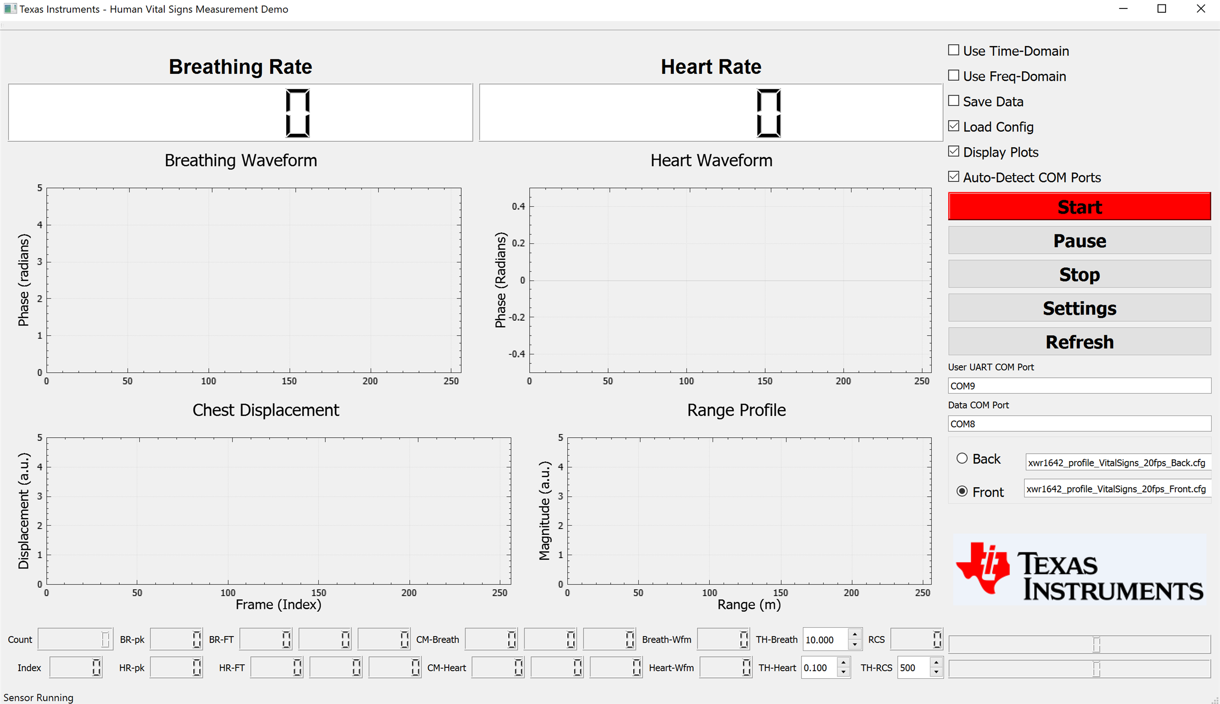

AWR1642BOOST: Human vital signs lab not gathering data
Part Number: AWR1642BOOST
Other Parts Discussed in Thread: AWR1642, IWR1642, , IWR1642BOOST
After flashing the binary in mmwave_automotive_toolbox_2_4_7\labs\lab0001-driver-vital-signs\vitalSigns_target\pre-built-Binaries\vitalSigns_16xx.bin
and running the executable in mmwave_automotive_toolbox_2_4_7\labs\lab0001-driver-vital-signs\vitalSigns_host\gui_exe\VitalSignsRadar_Demo.exe
I am getting no data outputting on the GUI
Here's the code showing on the command window
QT version = 5.9.1
QMetaObject::connectSlotsByName: No matching signal for on_buttonBox_accepted()
Serial Port Found
Data Port Number is "COM8"
User Port Number is "COM9"
Data port succesfully Open
User port succesfully Open

  • Michael,
    Please ensure that you are using an ES 2.0 AWR1642 device with this lab. ES 1.0 AWR1642 devices are not compatible with this release and this is the message that is seen when this is the case.
    Please search on this forum to understand how to determine which version of silicon your AWR1642 device is. This type of question has addressed several times in the past.
    Kyle
  • I'm fairly certain we have the ES 2.0 AWR1642 device. I was unable to find a definite way to check on the forums. Referencing this thread: \e2e.ti.com/.../699519
    lettering on my chip reads:
    IWR1642
    QG
    822E3Y9
    502AC       ABL     G1
    The 502 AC leads me to believe that I have the ES2.0 but I lack an "A" after "AWR1642A".
  • Michael,
    You in fact do not have an AWR1642 device, you have an IWR1642 device. There is a known issue with the vital signs lab where it works successfully on AWR1642BOOST but not on IWR1642BOOST. The issue will be addressed in a future release of the automotive toolbox. It does state in the release notes that the current vital signs lab is only for AWR1642.
