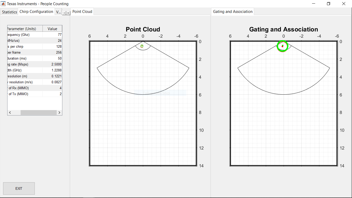

IWR1642BOOST: People counting demo Longer range
Part Number: IWR1642BOOST
I read in the design document that with appropriate chirp the range can be extended to 14 m. My question is related to the provided MATLAB GUI, if we change the scene parameter in UI  i.e change the front wall to be greater than 6m. The UI draws a rectangle with the front wall at a location greater than 6m. However the arc depicting the maximum range of radar is still at a radius of 6m. Can this be changed using any configuration or is it hard coded?
