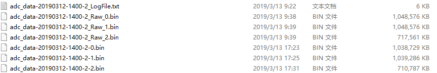

I am using AWR1243 Boost+DCA1000+mmwve studio 2.00.00.02 to  capture data.
Once i config a largre number frame and get 3 raw bin files (raw_0, raw_1,and raw_2) on PC1.
then i copy the three raw file and logfile.txt  to  PC2.
Next i convert  the three raw bin files to bin files. i use command in fig1, and get error in fig2.
my question is where am i wrong? i doult i forget to copy the file "pktlogfile.txt"  which lies in "C:\\ti\\mmwave_studio_02_00_00_02\\mmWaveStudio\\PostProc\\pktlogfile.txt").
Am I right?

  • We need to postprocess all the raw_X.bin files.
    What is the format of the raw_X.bin for postprocess it?
    Wath is the format  realation among all raw_X.bin files? i mean is there any difference for programme when i postprocess Raw_0 and othe Raw_X.bin files?
    Could you please provide the programme , even the programme in the mmawve studio for Raw_0.bin? or other referenece documents?
    The format of the raw.bin files is the same format.

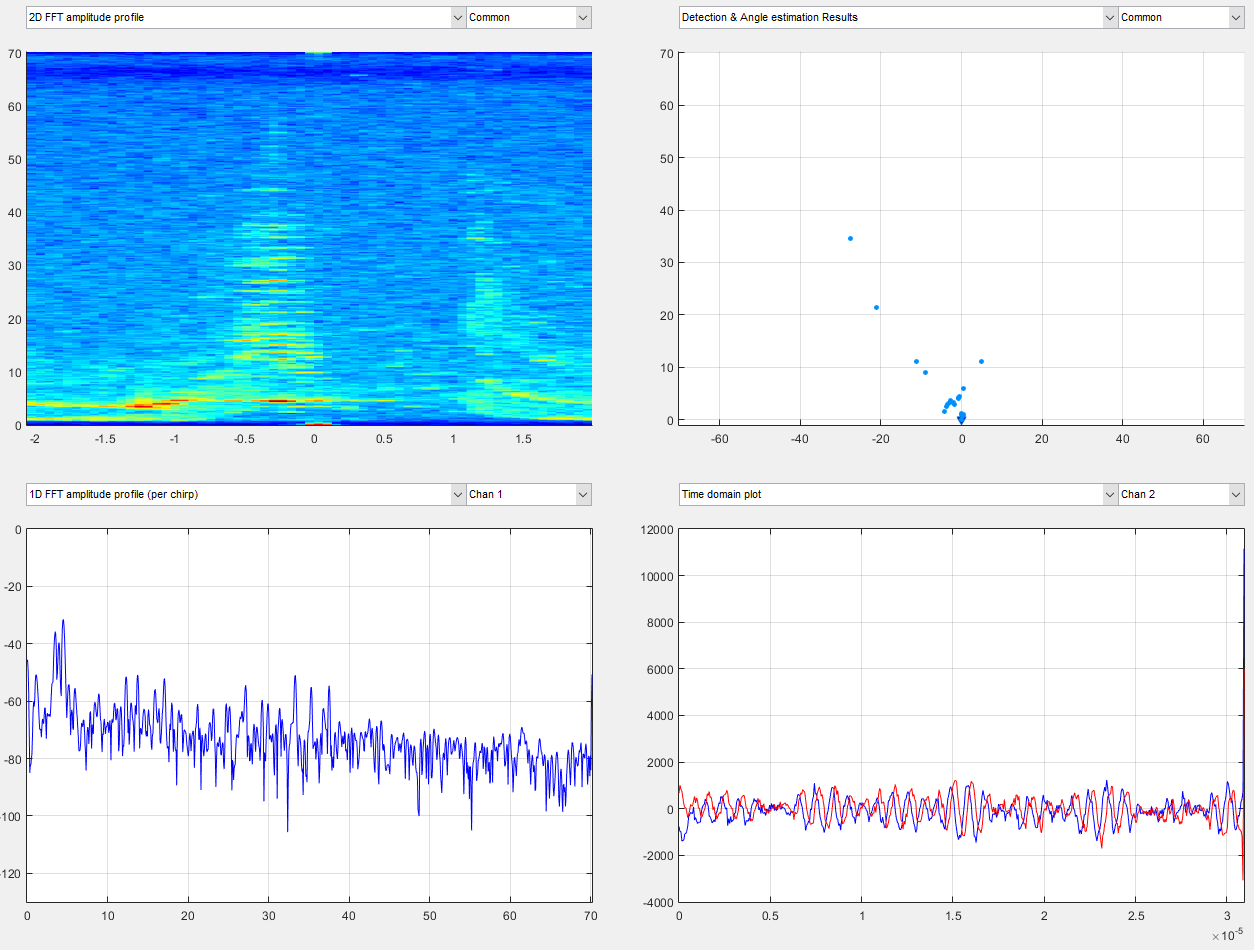

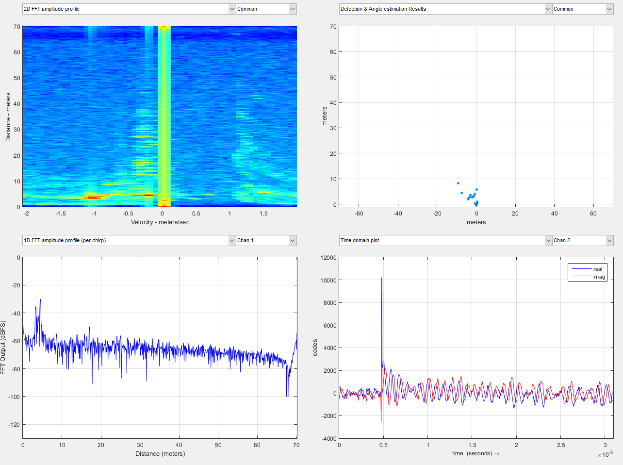

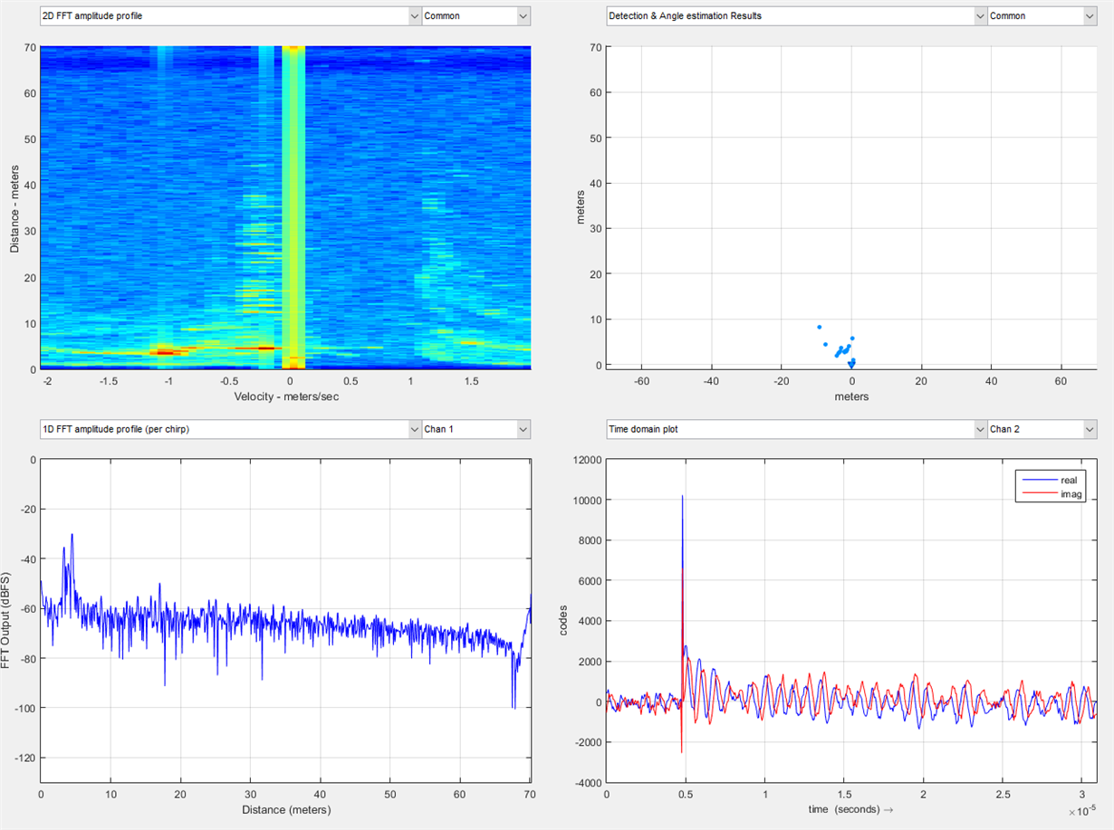

  •                                                                                                                                            (1) end frame of adc_data-20190312-1400-1-0.bin
                                                                                                                                               (2) start frame of adc_data-20190312-1400-1-1.bin
                                                                                                                                        (3) end frame of adc_data-20190312-1400-1-1.bin
                                                                                                                                        (4) start frame of adc_data-20190312-1400-1-2.bin
                                                                                                                                       fig4  postprocess results of different Raw_X.bin files
    I transfer Raw_X .files to X.bin files using the steps in fig1,and get X.bin files in fig2.
    Then i use post process in mmwave studio, load logfile “adc_data-20190312-1400-1_LogFile.txt” and load X.bin file"adc_data-20190312-1400-1-0.bin“,”adc_data-20190312-1400-1-1.bin“,”adc_data-20190312-1400-1-2.bin“. I  get results in fig4.
    I am confused:
    Why the end of adc_data-20190312-1400-1-0.bin(fig4(1)) is different from the start of adc_data-20190312-1400-1-1.bin(fig4(2)), which means the start of adc_data-20190312-1400-1-1.bin suddenly  appears a a yellow detection at velocity=0 meters/sec. fig4(2) is the next frame of  fig4(1) . That means their results are almost at the same time. So I think something must be wrong.
    And the same to the end of adc_data-20190312-1400-1-1.bin(fig4(3)) is different from the start of adc_data-20190312-1400-1-2.bin(fig4(4)).
  • see my reply
    It is important to understand that the files raw_X.bin may not include an integer number of frames.
    For example, you may have in raw_0.bin 100.3 frames. Then the data in raw_1.bin will not start on a frame boundary.
    You would have to re-built the frames in matlab.
    You can't process the raw_1.bin with mmWave Studio because it does not start on a frame boundary.
    Please create your own parser in C/matlab/python to read the raw data.
    Thank you
    Cesar
