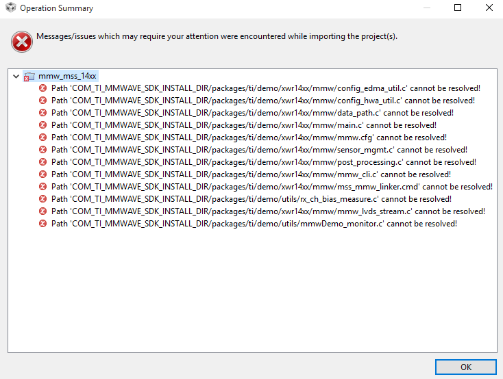

I had a few issues in importing the CCS project file of few demo project of mmwave_industrial_toolbox_3_1_1.
I am attaching the screenshots of the error encountered while importing the same on CCS version 8.3.0.
While importing demo0004-mmwave-sdk, the following package install errors could not be resolved.

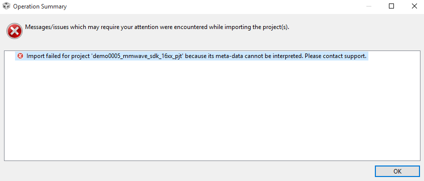

Also, while importing lab0005-high-accuracy-16xx, the following error came up.

  • Hi Aarathi,
    These errors are appearing because the latest version of the SDK does not have all of those modules available. I recommend installing SDK 1.2.0.5, which is the long term support module for the IWR1443.
