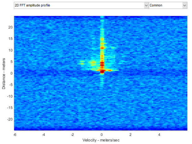

  • I can get the adc_data.bin file through mmWave Studio and get the time domain data of the four receiving antennas through the Matlab function readDCA1000 ('adc_data.bin') provided by TI. How can I get the 2D-FFT spectrum? Can the raw data of the 2D-FFT spectrogram shown in the figure below be obtained? Which script under the PostProc folder can get the 2D-FFT spectrogram?
    WIth DCA1000 you can get the raw adc data.
    This data can either be processed
    (i) with embeded Matlab Code. In this case, the output is displayed in the mmWave Studio tool. 2D FFT and heatmap data is not provided to user.
    (ii) with own Matlab Routines
    If you use your own Matlab routines then you have access to the intermediate 2DFFT and Heatmap
