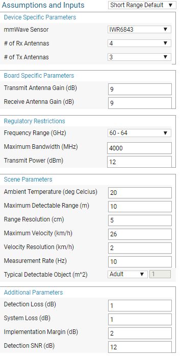

    Link  budget analysis is done with the known distance, known RCS, Chirp configuration, Known output power using friis equation SNR is computed
    and this is compared with measured results and pass/fail criteria is derived from this.
    We do not have any test house for the recommendation at this point in time.
    Below is the example of link budget elements from our sensing estimator tool.
    https://dev.ti.com/gallery/view/1792614/mmWaveSensingEstimator/ver/1.3.0/

    b.) make a decision for the parameters like the pic showed in your last response. And get the theoretical parameter by mmWave Sensing estimator.
